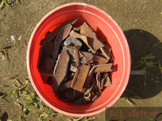

The iron is from broken up cast iron radiators. The pieces are thin, and so probably would make more slag than thicker iron.

Cast Iron radiators of the finned 'school' or 'hospital' type are usually a high phosphorous iron and as such should be very fluid when pouring but rather hard to machine. From what you've said earlier your castings machine nicely which is at variance with this - just an observation.

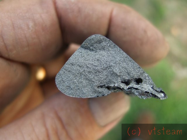

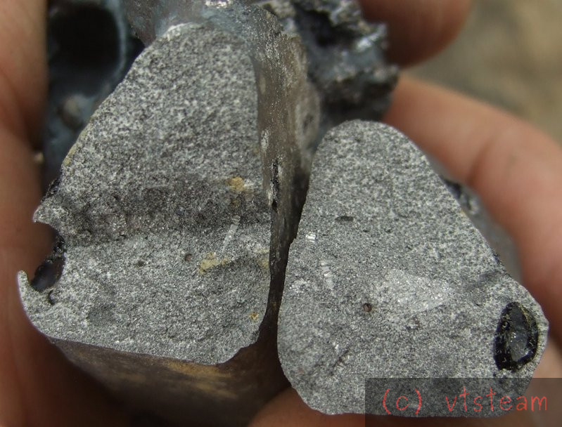

Can't melt today because of rain. Here are some informational pix from the melts so far.
First set is of three broken ingots, left after pours. I'm not sure which pour goes with which ingot. But they are definitely 3 different pours (or attempts to pour).
« Last Edit: January 14, 2018, 10:44:31 AM by vtsteam »

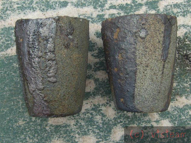

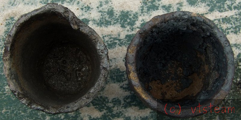

The next two are the two crucibles used. The one on the left was retired after 3 melts/attempts. It was used with a flux of soda ash (sodium carbonate).
The one on the right was used without flux. Also 3 melts. You can see the difference in the slag in each -- especially at the bottom. This crucible is coated with rough slag, but is still usable. The wall thickness is greater and it has retained its shape. In the side view the ceramic looks much better. The slag on the exterior also looks different.
« Last Edit: January 14, 2018, 10:49:27 AM by vtsteam »

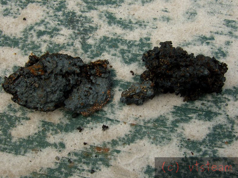

Finally, some not very exciting pictures of slag scraped off of the second (unfluxed) crucible. Texture and appearance is like very sticky cottage cheese when molten. It is very tenacious and difficult to scrape, even hot.
« Last Edit: January 14, 2018, 10:51:30 AM by vtsteam »

The residual slag is suppose to be scraped out of the crucible immediately after a pour, but I have found that to be easier said than done.
That slag is tough stuff.
I don't have anywhere near the slag you do, perhaps 1/20 of that or less.

Here's a pic of the radiator scrap I've been using:
« Last Edit: January 14, 2018, 10:52:15 AM by vtsteam »

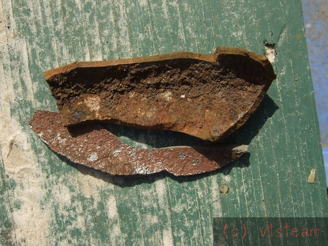

Here's a closer shot of it -- some pieces are relatively clean looking on the inside, and some are quite rough, with what look like sand inclusions from a core:
« Last Edit: January 14, 2018, 10:52:46 AM by vtsteam »

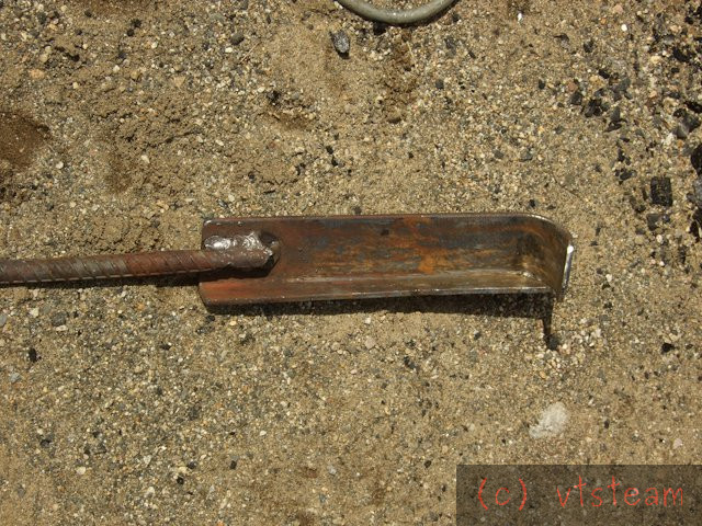

Here's a tool I made today to help me scrape slag out of the crucible while it is in the furnace. It was made from a piece of L shaped angle iron left over from the pallet i used to make the furnace base, and a 2 foot length of 1/2" re-bar:
« Last Edit: January 14, 2018, 10:53:23 AM by vtsteam »

I only use clean metal to avoid slag problems.
I bought some ground corn cob, and will either be wire brushing my metal, or sand blasting it with corn cob.
I tried using some baking soda and salt with an aluminum pour, but then tried it again without either, and still had good results, but again starting with clean metal.
I have seen others around here use radiators, but I have not had trouble (yet) with just regular gray cast iron as far as being fuid enough to pour.

I need to make one of those scapers.

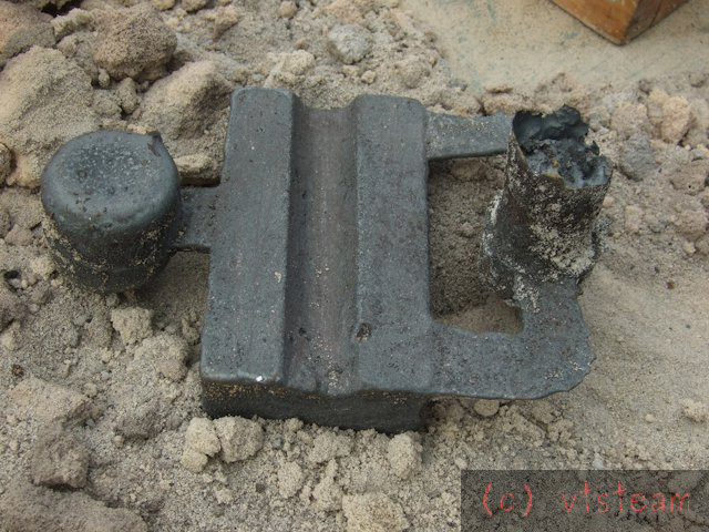

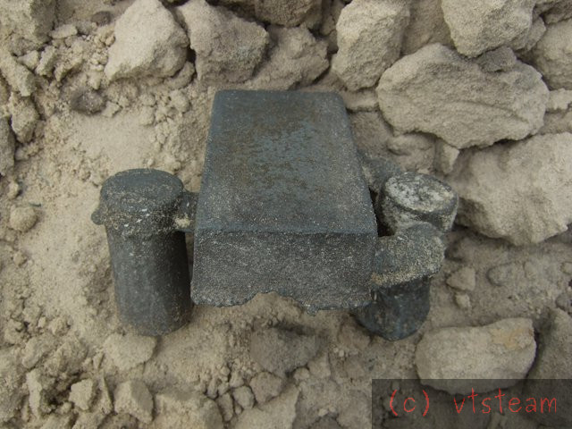

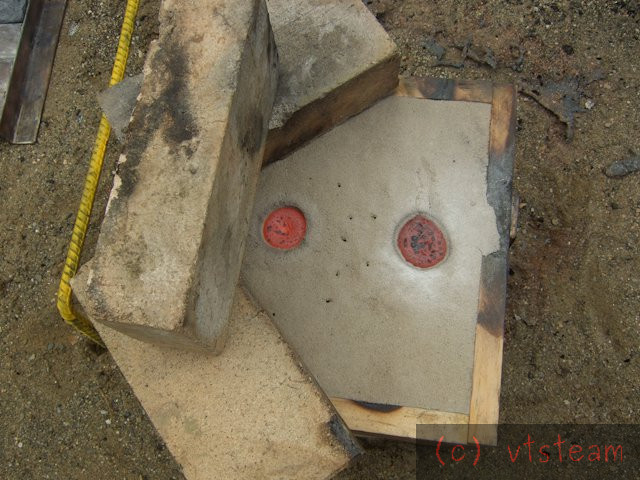

Today's second pour. The first pour was a mess -- a piece of slag on the outside of the crucible prevented it from seating all the way down in the pouring shank, I didn't notice. About half way through the pour the crucible slipped out of the shank and emptied the remainder on top of the sand -- hence the burn marks in this cope. One more short pour   :doh:
After uttering a few sentiments that would have made doubleboost blush, I re-grouped, dumped the flask in a wheelbarrow, re-loaded the crucible, started the second melt, and rammed up a new mold.
This time instead of the radiator scrap, I used one of my earlier castings, a sprue and an ingot -- figuring these were all clean metal, and much more massive than the other stuff. I hoped for a lot less slag and a good pour. It melted pretty quickly in the hot furnace, and I dumped in about an ounce of crushed oyster shell. This did seem to liquify the slag better. I had a fuller pot of metal, it seemed, too.
When it seemed hot enough I pulled it out scraped the slag -- much less and better behaved, checked the fit in the shank carefully. and poured.
Unfortunately I thought I saw a small bit of slag go in part way through the pour -- I hoped it would be trapped in the well or gates. If I'd had a partner, he (or she) could have held back the slag with a rake. There always seems to be a little bit clinging to some part of the crucible.
Here's what the second pour looked like -- nice and neat. Not like the first!!
« Last Edit: January 14, 2018, 10:54:14 AM by vtsteam »

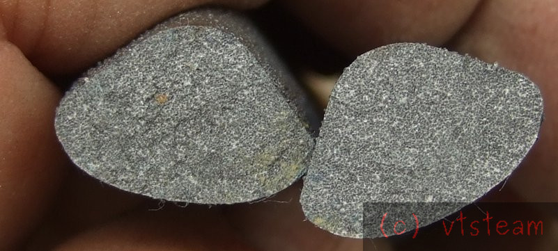

I had enough at the end to pour an ingot -- a bit of slag dropped in when I tipped the crucible all the way here, too.
While waiting for the mold to cool, I broke the ingot in half to look at the grain. Looks good, and uniform gray, except for the bit of slag.

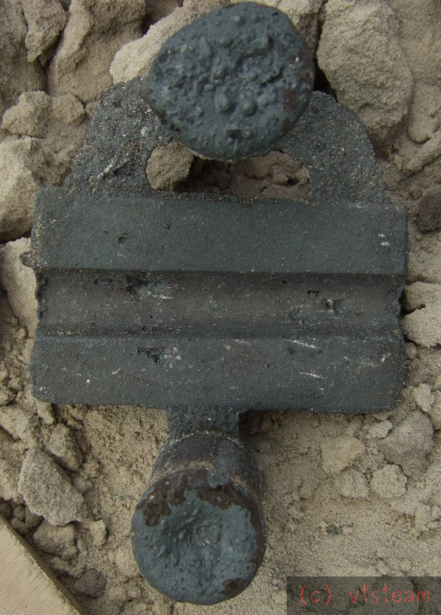

Breaking out, the bottom of the casting looked good -- graphite blacking was helping some -- also corners were relatively sharp. This time sprue and riser were well filled -- though short, since the cope is only 2" deep.
« Last Edit: January 14, 2018, 10:55:27 AM by vtsteam »

That looks like good clean metal.
I made a crucible retainer for my smaller crucibles, but it was not a positive engagement, and so the crucible shifted when I went past 90 degrees, and sloshed metal everywhere.  The sliding/locking retainers seem to work best, and they make positive contact with the crucible.
We need to get you a web cam so we can watch the action.

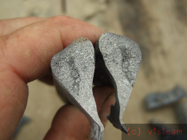

Hopes were up but after cleaning the sand off, no good.   :wack:
Same old story with a new set of words. Slag inclusions.
Pretty sure these aren't the same as the blow holes I got earlier -- not sure if they show well in the photo here, but in real life they are rougher irregular holes and look like inclusions inside.
So, I'm not sure if I was successful in totally getting rid of blow holes, or partially successful, but I did manage to get a different problem this time.
Well, slag has been a problem, one way or another all along. It seemed to be no problem when I used sodium carbonate -- but of course, crucible lifespan was a problem.
I might go back to soda ash, but this time added just before the pour -- as the oyster shell was.
Maybe that will give me truly liquid slag that I can skim off completely. It was like green syrup before, not this slushy stuff.
Using "clean metal" seemed to help some, as did shell flux, but it's just not enough here.

As ironman said, it can take years to get the methods and materials figure out.
I am suspecting your sand mix, since your risers and such appear be be breaking with a clean interior.
Ironman had a lot of trouble with sand when he started.
Do you have any sodium silicate and CO2 you can try?
