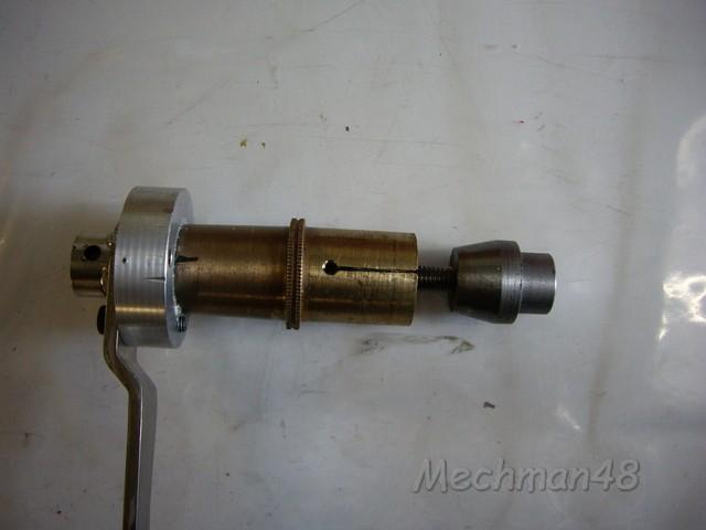

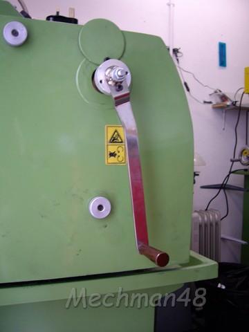

Here's one I made last week end: bits from the odds 'n' sods box & a handle from a book binding machine I had laying around in one of my boxes:
George.

« Reply #11 on: July 05, 2013, 04:17:32 PM »
Thanks Pete  :beer:
Did have a smaller handle on originally..6".. but found that when I was threading some 12mm it took some turning, maybe it was additional drag of the belt & change wheels so as I didn't want to take off the belt & swing the banjo out I decided to increase the length to gain more turning moment & this was all I had to hand, so on it went.. worked a treat..  waste not want not I always sez  :dremel:
George
