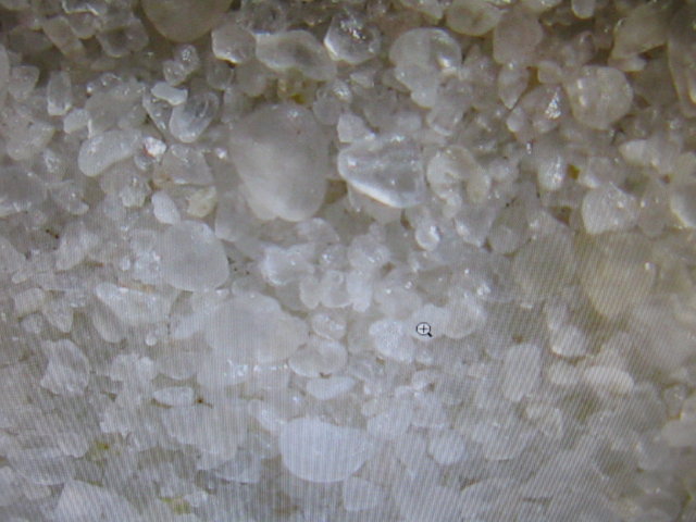

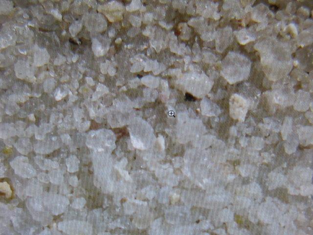

vtsteam Here are two photos of sand grains. Quarry sand is the sand I use and the pro sand is a sample of graded sand a friend gave me.  Also have a look at this video it shows portland cement being used the same way I use graphite on my cores.

« Reply #7 on: July 16, 2013, 09:23:46 PM »
Great photos, and a really wonderful movie. Thank you Ironman!
I think what you have as quarry sand would be called "sharp sand" here. Both samples look to be nearly entirely quartz (silica) sand.  I'm going to have to hunt for a source for that. I'll post pix of what is commonly found here for sand.

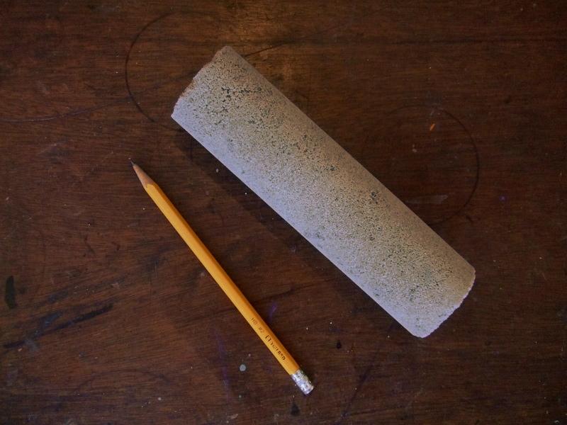

Well I'm reopening an old topic here, but today I revisited making cores with Portland cement. I actually didn't have a good success rate when I tried this a few years ago. So I went back to baked sand cores using molasses water, etc. The main problem was that the cores weren't strong enough to resist breaking before going into the mold. Some of them were also crumbly.
I'm not sure what was wrong then but today I unmolded a new try at a Portland cement and sand core, and it's perfect, By perfect I mean it looks like Ironman's results!
I think the differences from my first attempts are:
1.) Instead of fine local sand, I used some bagged coarse quartz masonry sand (actually labeled as "medium")
2.) I properly used 87% sand to 9% cement to 4% water and mixed very thoroughly.
(I'm not sure if in the past I might have tried the simple 100 to 9 to 4 mix, which would have reduced the cement and water proportions.)
I think the real difference is the sand. If you think about it, a fine sand has much more surface area than coarse sand. Since you are trying to coat every grain of sand with cement when molding an aggregate like this, there may have been too little cement to properly coat the fine sand I used in my earlier tries.
Coarse sand is also more porous. I can easily blow lengthwise through this finished core, so I don't think it needs any additional venting. And coarse angular sand is just generally stronger when packed.
Anyway here's the core I just made. It will be used in casting an iron engine cylinder, when casting weather eventually gets here. I just packed a second cement/sand core today, and we'll check it as well after 3 more days of curing.
Very happy with this result!

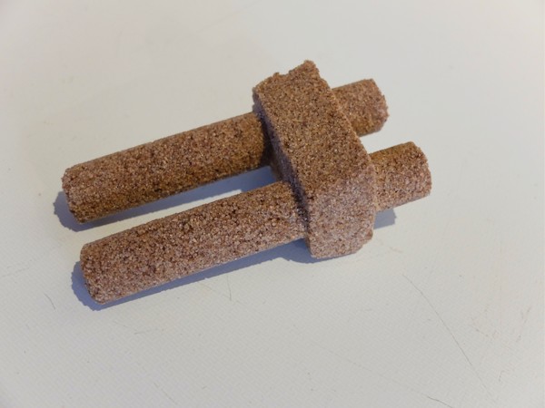

Well as long as we're talking about a poor man's sand binder, we could also mention baked sand cores. They also don't require sodium silicate and CO2, or epoxy formulations, and use common non-toxic inexpensive off the shelf ingredients.
The cement/coarse sand cores work great for cores from an inch on up, but smaller than that and even with wire reinforcing, they have been too fragile for me to use. The other disadvantage is waiting a few days for them to unmold.
I just made a small baked sand core today and it's much stronger then the cement sand version I tried. It also released from its plaster corebox much more readily than a cement sand core, which broke and left residue that had to be carefully scraped out when I tried. Both attempts used mineral oil as a release. I also tried Vaseline with the cement sand mix, but the core still broke, and also left cement residue.
A baked sand core is much quicker to harden also. Depending on size and corebox, about 30 minutes to an hour, compared to several days for cement/sand. The baked sand core below took an estimated 0.15 kWh energy in a small toaster oven, or about $0.03 U.S locally.
Ingredients were molasses water, and dry wheat-type wallpaper paste. Some use corn starch, corn flour or wheat flour, but the walpaper paste was recommended as stronger by D. Gingery, who 20 years ago, through his books, taught me casting, so that's what I use. (btw I think it's considerate to cite sources of information and give credit to people who kindly helped you learn things, so they're not forgotten -- a practice too rarely acknowledged these days.)
I will definitely continue to do larger simple cylindrical cores using Portland cement as shown by Ironman (Luckygen1001) -- it does a great job. You can easily make a number of coreboxes from pipe if you need several at a time. And cast them in advance -- the cores are inert and will last forever in storage.
On the other hand, for small and complex cores, I think baked sand offers a lot of advantages.  A complex corebox may not be easy to make in multiples. You can release the cores quickly onto a core plate, or simply bake them in the corebox, if suitable, and the turnaround is therefore rapid. Storing completed cores does require a little more care long term -- they need to be kept dry, but that doesn't present great difficulty.
Both methods are good to have in the casting arsenal, are inexpensive, and use easy to obtain off the shelf ingredients.
I just made this core yesterday. It's the core for a model Westinghouse-style twin cylinder steam engine. It shapes the spaces for the cylinders and the lower crankcase.

« Reply #17 on: March 20, 2022, 10:15:29 AM »
You forgot the other big advantage... the smell like cookies when baking :)
Nice core.
