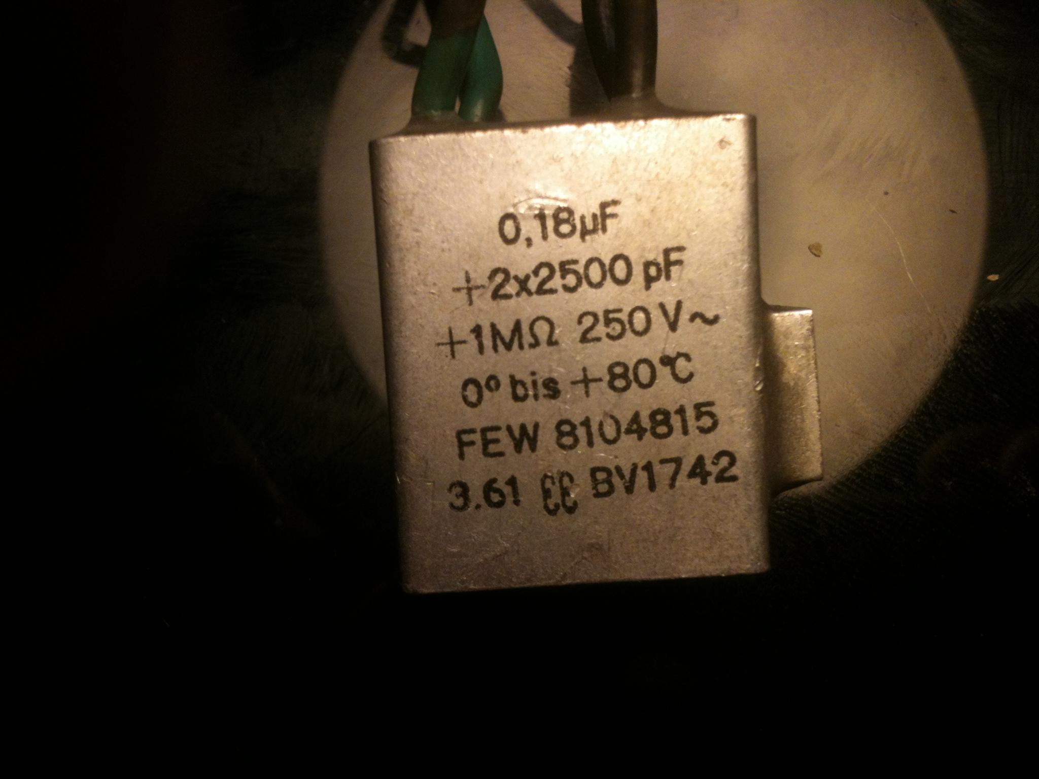

Here's a picture of the piece:

Re: Can it be saved?
« Reply #6 on: July 11, 2013, 10:06:13 AM »
It is a RFI suppressor. The resistor is there to discharge the .18uF cap, otherwise you can get nipped by the residual charge.
Could well be unique to that manufacturer/model of grinder.
Not likely you will find a generic item like it, not impossible though.
Look for a 'delta capacitor'.
What is the make and model of the grinder?
You sure that it's gone pop? Mostly they are sealed items, not likely to get water in them.

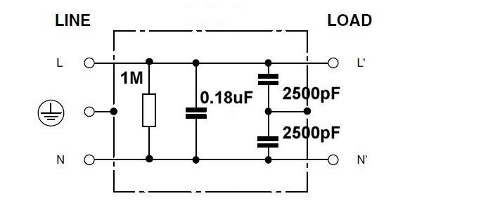

Hi Rusell
once every thing is dry you can test the motor without the filter
Offline Russell Nash
  • Posts: 47
  • Obsessive Compulsive Slob
« Reply #10 on: July 11, 2013, 10:39:21 AM »
Hi Rusell
Where did you get the diagram from?  That seems to be the exact piece.

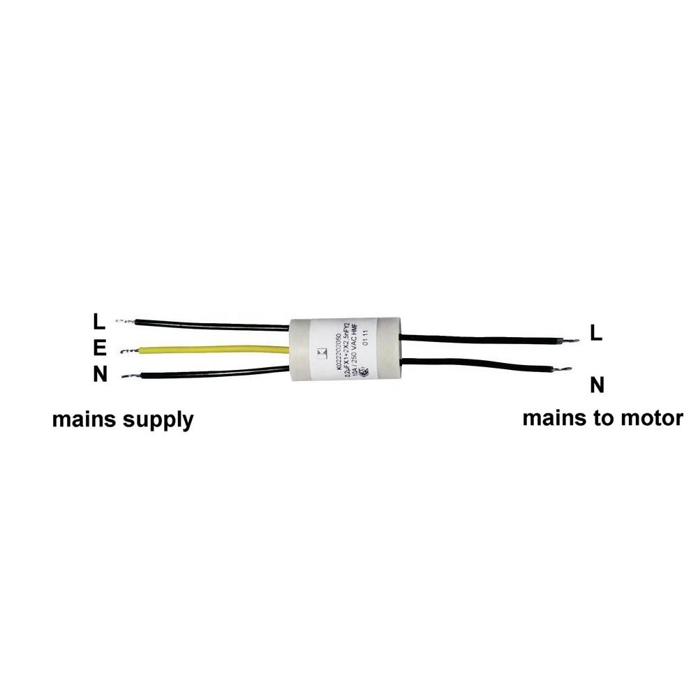

Hi Russell
I found a diagram for a chassis mounting filter and cut and paste the diagram to match your filter !
I'v not yet found a wire ended filter just like your original one
PS - this delta network is close http://uk.farnell.com/jsp/search/browse.jsp;jsessionid=DKT1EEWF4VJ3WCQLCIPZK0Q?N=0&Ntk=gensearch&Ntt=delta+capacitor&Ntx=mode+matchallpartial&exposeLevel2Refinement=true&suggestions=false&ref=globalsearch&_requestid=234985
but would need a 1 M resistor adding across the outer two connections - CX
in the diagram in this data sheet -
http://www.farnell.com/datasheets/629964.pdf

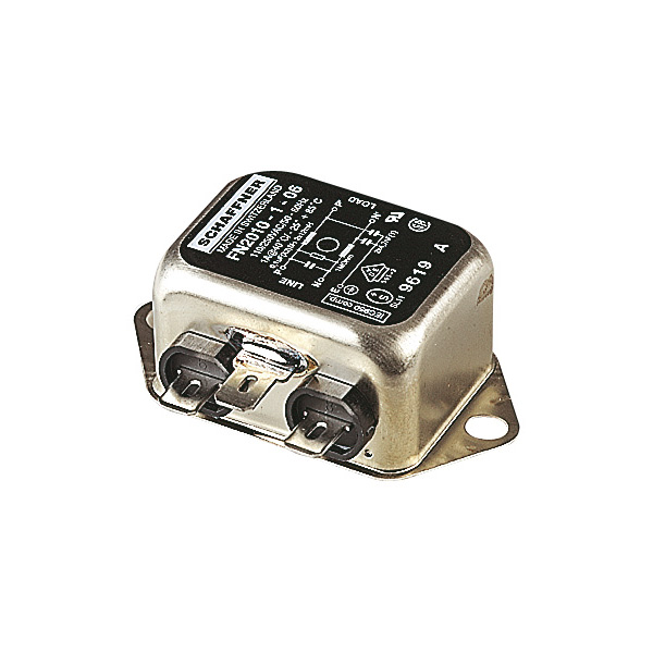

« Reply #12 on: July 11, 2013, 01:28:38 PM »
Much as it grieves me .....  :bang:   :bang:   :bang: ... not a fan of Maplins ....
I have some here, the only one similar I can find is this ...
http://www.maplin.co.uk/delta-suppression-filter-501
Does seem to have a resistor ?
No need to worry too much about the values, they all seem to work so long as they are 240VAC rated.
Only problem is whether the thing will fit in ...

Hi Russell
this version of the filter Dave found is a closer match to your original
http://www.conrad.de/ce/de/product/450646/Funkentstoerkondensator-XY-K042202050-02-F-250-VAC/?ref=detview1&rt=detview1&rb=1
this filter has 5 wires two live wires two neutral wires and an earth wire
on the original filter the earth connection is made by fastening the metal case of the filter to
the earthed metal case of the tool
do you have a picture or a note  of how the grinder was originally wired ?

More current status:
Conrad didn't have the piece.  I've ordered it online.
I wired the switch without the filter today to see if it was dried out enough to run.  I go nothing.  My inline surge protector lit up to show it wasn't shorting out anywhere, but the machine wouldn't start.  I ran out of time, so I'll have to check the switch later.

Personally, I think you have an electrical fault other than water in the motor. A failed capacitor or something. 20+ years of wet-cutting concrete here and I never saw a motor pop a trip from getting wet yet.
