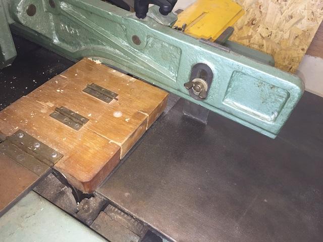

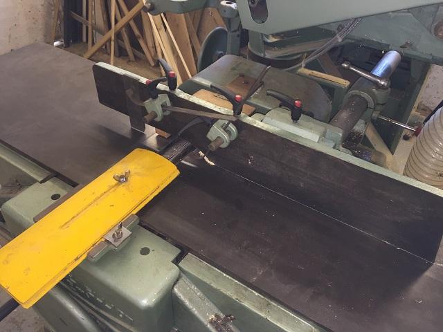

I've been using my Dominion Supreme Eliot combination woodworking machine quite a bit recently (making a vast linen store / airing cupboard for support of our letting holiday cottages) and using the planer I realised I don't have a clear understanding what a bit of the planer fence is intended for.
It slides in a vertical slot in the planer fence and is locked by a wing nut. I'd assumed it was to give more stability to the fence - maybe to stop vibration - but I've a feeling that there must be more to it than that.
Virtually every 'professional' (ie heavy cast iron) planer that I see pictures of on the web has a very similar arrangement.
... so what am I missing ? What's it for ?

No Pete I don't think so - I'm familiar with anti kick back devices. This gizmo stays in the plane of the fence and the timber slides past it - the only thing it's touching is the 'outfeed' table, which is height adjustable, so I assume (dangerous) this is why the gizmo slides vertically.

Do you not mean the infeed table  :scratch: and as far as i'm aware it is just a support fence that you adjust depending on how much you lower the infeed table  :thumbup: It also stops you putting a line down the side of the piece of timber you are planing  :scratch: without it the side of the timber running against the guard could end up marked.

No Jon it rests it's lower end on the outfeed table. Timber passes from right to left in the "overview picture".
In the equivalent Wadkin planer / jointer parts list it is just referred to as a 'fence insert' and the Wadkin instructions merely say to slacken it's wing nut when adjusting the tables, and the let it sit on the surface firmly then tighten the wing nut.
Perhaps there is no further subtly and I'm looking for explanations where none are needed  :scratch:

My best guess is that it's just to stop wood thin enough to slip under that gap from getting pushed sideways (accidentally by the operator) on the outfeed table.

Hello Andrew I think you and S. Heslop are both right. Because of the design allowing for very heavy cuts with this machine this feature allows for support to the work piece on the outfeed side of the table and again because of the design of the fence and its adjustment it provides support and alignment for the fence when adjusting it. My 8" Delta is not designed to make such heavy cuts. The fence has a semicircular cut out over the cutter head as opposed to a step and the adjustment is made on a machined flat surface with a 1/2" keyway for alignment. Your fence is supported on round off center bar stock which would put rotational pressure on the fence thus the adjustable support.
