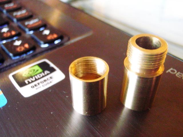

Well as the title indicates I have been persevering and honing my skills on my new lathe and decided to try my hand at threading with a one point cutter tool instead of the tap & die method.
Yesterday I have produced a couple of prototypes but could not get them to screw together no matter what I tried. I checked the pitch to insure my threads were straight and compared the diameter of both male and female threads and everything appeared to be at least a good effort for a beginner but nothing worked, as soon as I tried to screw one into another they bound up and joined one another crocked and simply did not behave as expected so I gave up and decided to try again with a fresh start tomorrow.
Getting home from work today I tackled the problem again and realized that by turning the male and female threads using the lathe in the same orientation and direction on both cuts I was producing one right hand thread and one left hand thread that of course simply could not screw together.
Having resolved this problem I have since turned and threaded a hollow brass bar that can be screwed together and the action is very smooth and satisfying.
Cheers Mick

Good practice Mick and true its gratifying.
Sounds like wrong hand tool on female thread?
Done it all, wrong tips for thread on finished product to wrong pitch but right tip. Spindle startup 800 rpm on a short thread glad of foot brake. Check and check again no ones fallible.
Dare say you have realised now that you can actually make your own matching male and female thread up, one reason I like metric. Gets a bit tricky say UNC with metric pitch.

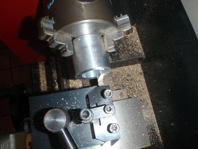

Not sure what is going on here.
To cut a left hand thread  (never done it ) don't you have to apply the cut while moving away from the chuck ?
Both internal and external right hand threats are made towards the chuck.
Or am I having a senior moment here ?
Dave :scratch:

« Reply #6 on: June 28, 2013, 04:49:09 PM »
You are correct.  The cross slide must also be re-positioned.

..Getting home from work today I tackled the problem again and realized that by turning the male and female threads using the lathe in the same orientation and direction on both cuts I was producing one right hand thread and one left hand thread that of course simply could not screw together.
Sorry for the question,  but I can't visualize what you did.

I guess cutting a left hand thread away from the chuck is the correct way but I cut both internal and external threads towards the chuck and came up with opposing threads.
I had the lead screw engaged in revers so I could arrange the cutter on the far side of the internal thread so I would be able to see it cutting the thread as it proceeded. This also caused the thread to cut an opposing thread.

Still don't see how this would give you a left hand thread;  unless you were running the lathe mandrel in reverse.  But I'll let it go at that.

He prob cut one thread from right to left and the inside thread from left to right.

If the tool in the picture is the right way up,  and the lathe is turning in the conventional direction, then it wouldn't cut. So the tool has to be upside down.
But he writes,
.. turning the male and female threads using the lathe in the same orientation and direction on both cuts I was producing one right hand thread and one left hand thread ..
This and,
...I had the lead screw engaged in revers so I could arrange the cutter on the far side of the internal thread ...
If this means driving the saddle back towards the tailstock it would need the chuck to be turning clockwise (backwards to normal)  viewed from the front. This could unscrew it.

Sorry, some clarification.
The chuck was turning backwards, “clockwise”  but I was also moving the tool towards the chuck with tool facing upwards, my first attempt so still learning the correct procedure.
