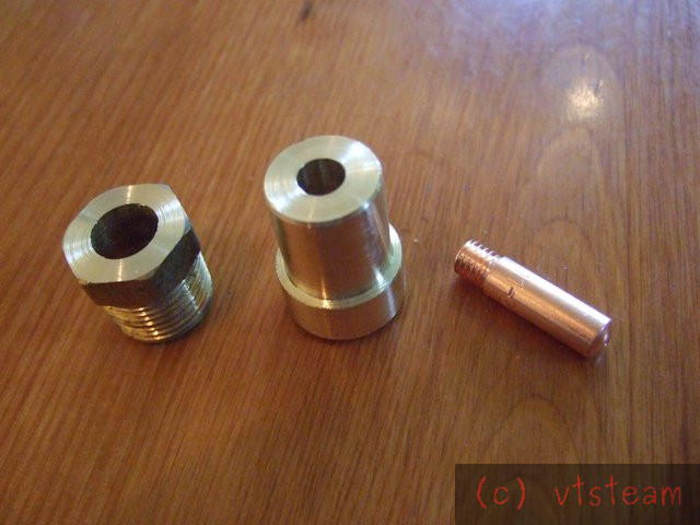

Anyway, here's a start:

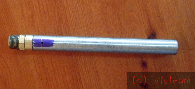

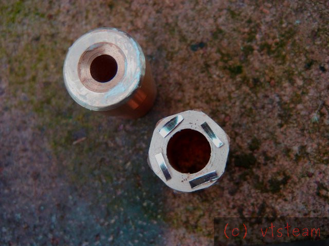

I turned a scrap of Brass down to make it a tight sliding fit in 1/2" electrical conduit, with a shoulder, and drilled it 1/4" to fit a mig contact tip. Because the piece wasn't long enough to thread the gas connection end, I rummaged around in my old plumbing fittings box and found a compression to 3/8" pipe thread bushing. I sawed off the compression side, and faced it, leaving the hex shoulder and the pipe threads.

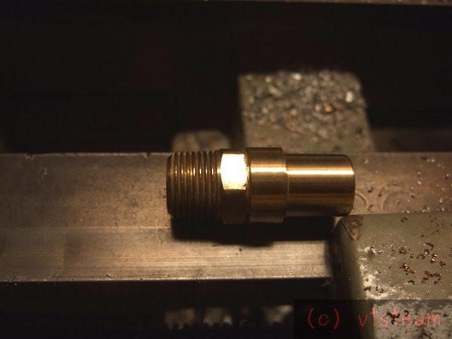

Then I took them outside on the porch, set them on a firebrick, fluxed both parts and cut little strips of silver solder to put in the joint. I set one on top of the other with the solder sandwiched in between, heated with a handheld Mapp torch, and It was able to do the job. The pieces came together and the solder wet out very nicely.
« Last Edit: January 17, 2018, 07:42:48 PM by vtsteam »

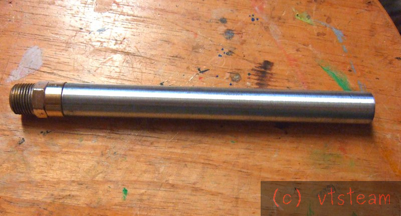

The silver brazed part:

I cleaned up a piece of 1/2" conduit and fitted the end in. It was a tight sliding fit.

Then I drilled for tapping for a #6 set screw right through both the outer casing and the brass fitting. The set screw will allow adjusting the position the MIG tip in the brass fitting, as well as lock the outer casing to the steel tube shell.
« Last Edit: January 17, 2018, 07:44:01 PM by vtsteam »

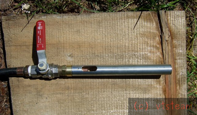

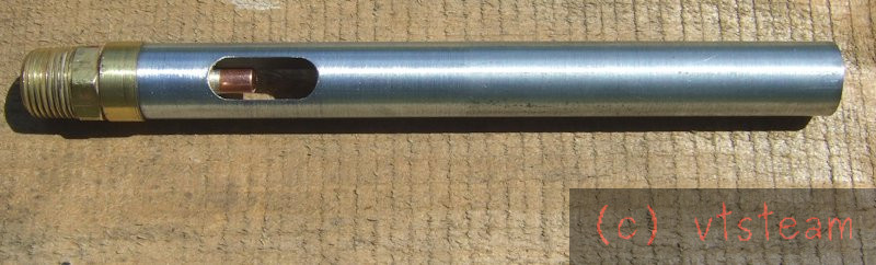

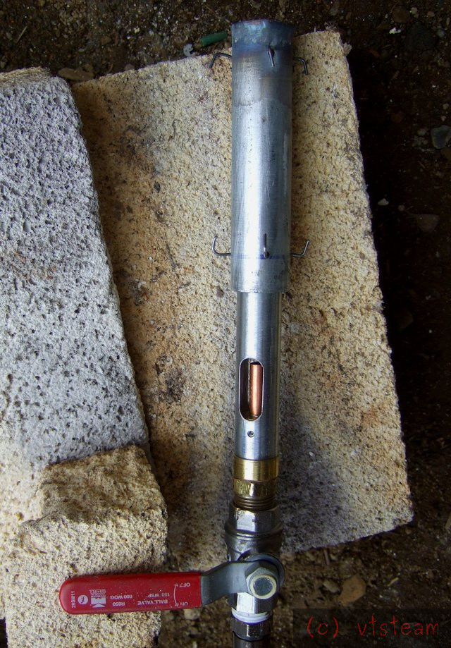

I tapped the burner base and installed a .030" mig tip.  I also milled two 3/8" x 1" air ports lengthwise on the barrel. That's different than a Mako burner which as radially milled ports, so I wasn't sure what to expect for performance. I guessed that the open area was roughly equal to that in the Mako design. The slots are similar to the Hybrid burners like the T-rex, but those feature a much larger barrel and venturi, and the nozzle orifice is forward of the slots.
« Last Edit: January 17, 2018, 07:44:24 PM by vtsteam »

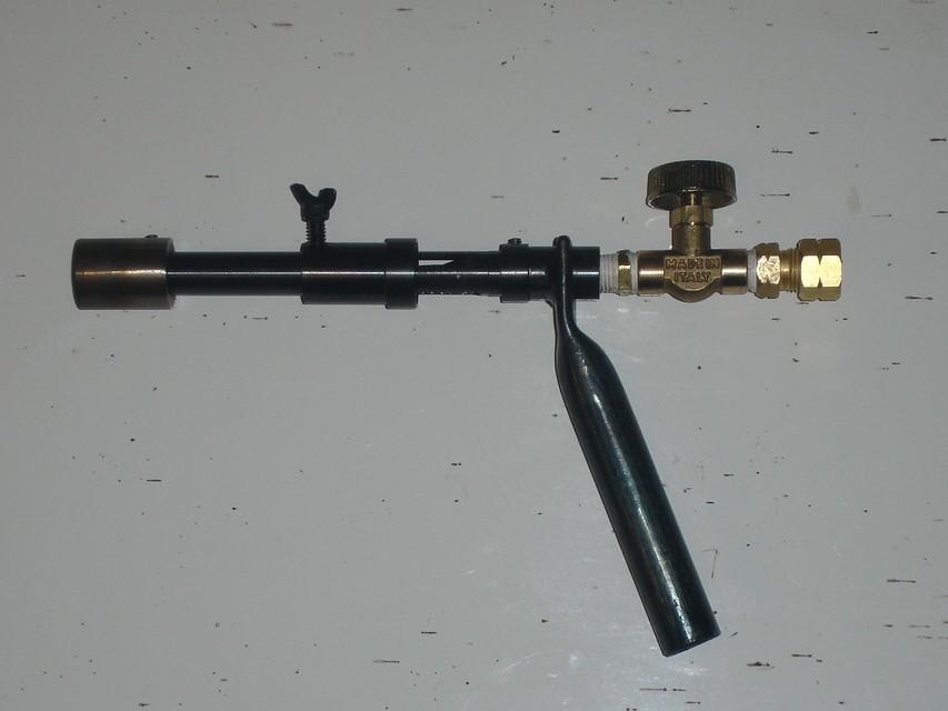

I connected the propane hose to the tank and regulator hose barb using 2 new proper size hose clamps, and connected the other end to a gas ball valve and then to the burner base.
Here's the complete assembly (minus a burner flare):

I tried a lot of experiments today with the new burner.
I tried it with and without a flare, with different amounts of flare in the flare (!) with different mig tip positions, and lengths, and with and without the three 1/4" holes in the end of the main barrel, which appear on the Mako design. Pressures ranged from 2 to 15 PSI.
To summarize, the burner definitely requires a flare in free air, and the flare should be flared. The tip position was best with this design placed far forward near the end of the air slots. That is different than the Mako design which positions the orifice in the middle of the air slots. But, of course those slots run radially, not axially.
The burner worked very well, though I think the flare needs more flare currently to increase stability at the higher pressure end of the range, and in wind (It was very blustery today -- not actually a good day for testing).
It puts out a lot of heat, but it is diffuse heat compared to a hand held torch, which really focuses a flame. For that reason, it never was able to do more than soften brazing rod rather than really fuse it to base metal despite the fact that it was producing lots of heat and flame. I'm sure it would be a fine burner in a forge or foundry where insulation could allow a rapid temperature rise, radiant wall heating, and contain  the flame.
But in open air playing against metal it was just too big a flame to reach good brazing temperature. I'd rate this burner as a success as a massive and efficient heat source, but a failure as a hand held brazing torch.
Focusing an atmospheric flame is something I want to find out about.
Here's the burner with flare and forward orifice location:

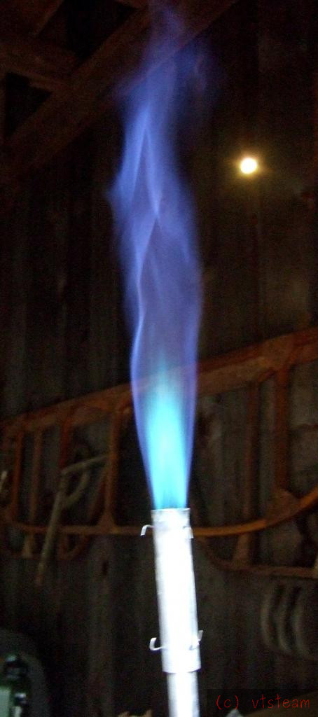

  • Posts: 6940
Re: Atmospheric Propane Brazing Torch Experiments
« Reply #9 on: June 13, 2013, 01:36:51 PM »
Here's a picture of the flame at 5 PSI nearly fully open throttle:
« Last Edit: January 17, 2018, 07:45:58 PM by vtsteam »

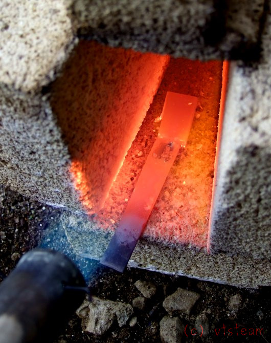

It's really clear to me that we have enough heat and a high enough temperature to easily braze with, but that heat is scattered over a very large flame. As a result it cannot raise a local temperature high enough to melt brazing rod.

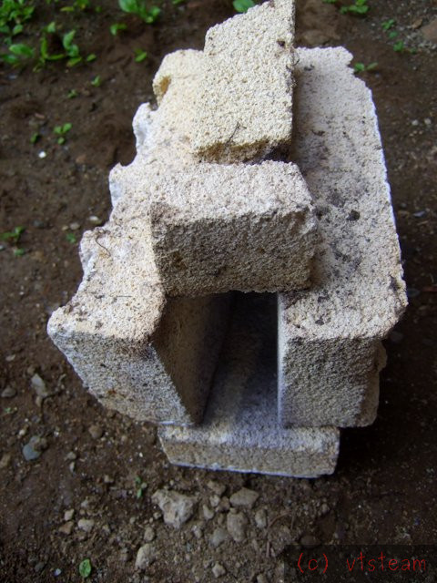

One way of concentrating and collecting that heat in a small space is by enclosing it. Thus a brazing hearth.
Here's a very simple hearth I put together to test this method with the new torch. A few pieces of used insulated firebrick stacked together.
« Last Edit: January 17, 2018, 07:46:47 PM by vtsteam »

« Reply #11 on: June 13, 2013, 03:02:45 PM »
Success!
« Last Edit: January 17, 2018, 07:47:19 PM by vtsteam »

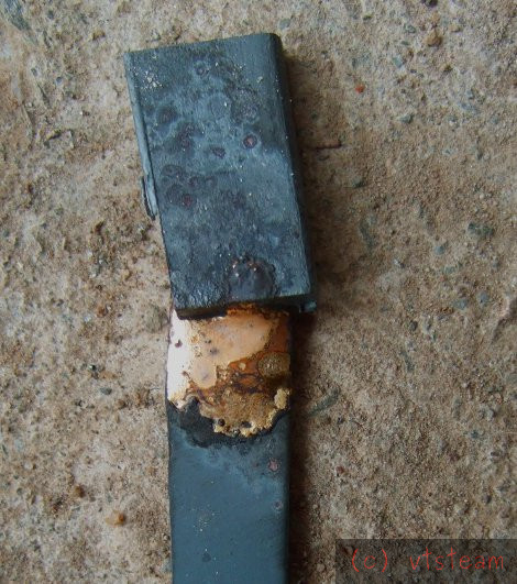

Not a pretty job, but it was just a couple of bandsaw cutoffs laid on top of each other, and had they had been subjected to many previous tests, thus the heavy oxide layer.
It may be that my torch has an excess of oxygen however, which is easy to control with a choke. Early on it had an oxygen deficit and the first flames had a bit of orange in the feather. I was considering opening up the slots or adding another. However, repositioning the gas orifice and adding flare to the flare made this unnecessary.

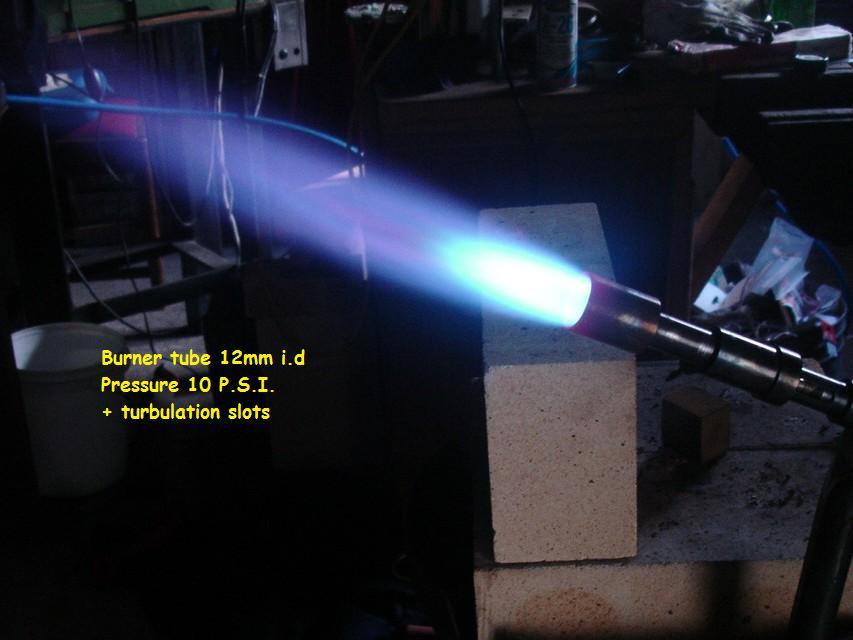

« Reply #17 on: July 06, 2013, 04:36:44 AM »
Hi Guys
Newby and first posting.
Enjoy your topic, been experimenting with a handheld torch/burner myself.
Based mainly on M Porter design, but with added features.
Aiming for single wave combustion (short primary flame)
And knowing that a turbulent flame burns hotter.
I went about it in this way.
Presuming the sizing of the jet/ burner tube i.d./ burner tube length, are O.K.
Found that in free air a stepped flare gives a more stable flame over a bigger range.
At first the flame was too long and laminar, so needed to create turbulance.
Drilled holes 3X near the end of the burner tube, and created a key-hole shape.
By opening a slot, towards the end of the tube.
The i.d. of the flare will cover the key-hole shape holes.
On the inside the holes create turbulance and hence better mixing.
Turbulance speeds up the chemical reaction during combustion.
Thus creating a hotter and more concentrated flame.
Hope this helps.

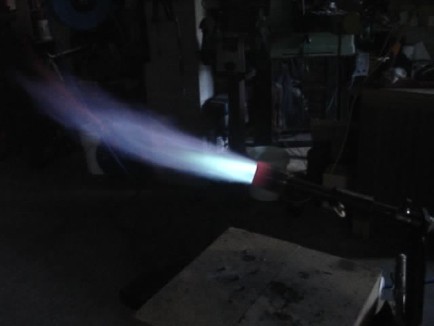

« Reply #20 on: July 06, 2013, 11:39:11 AM »

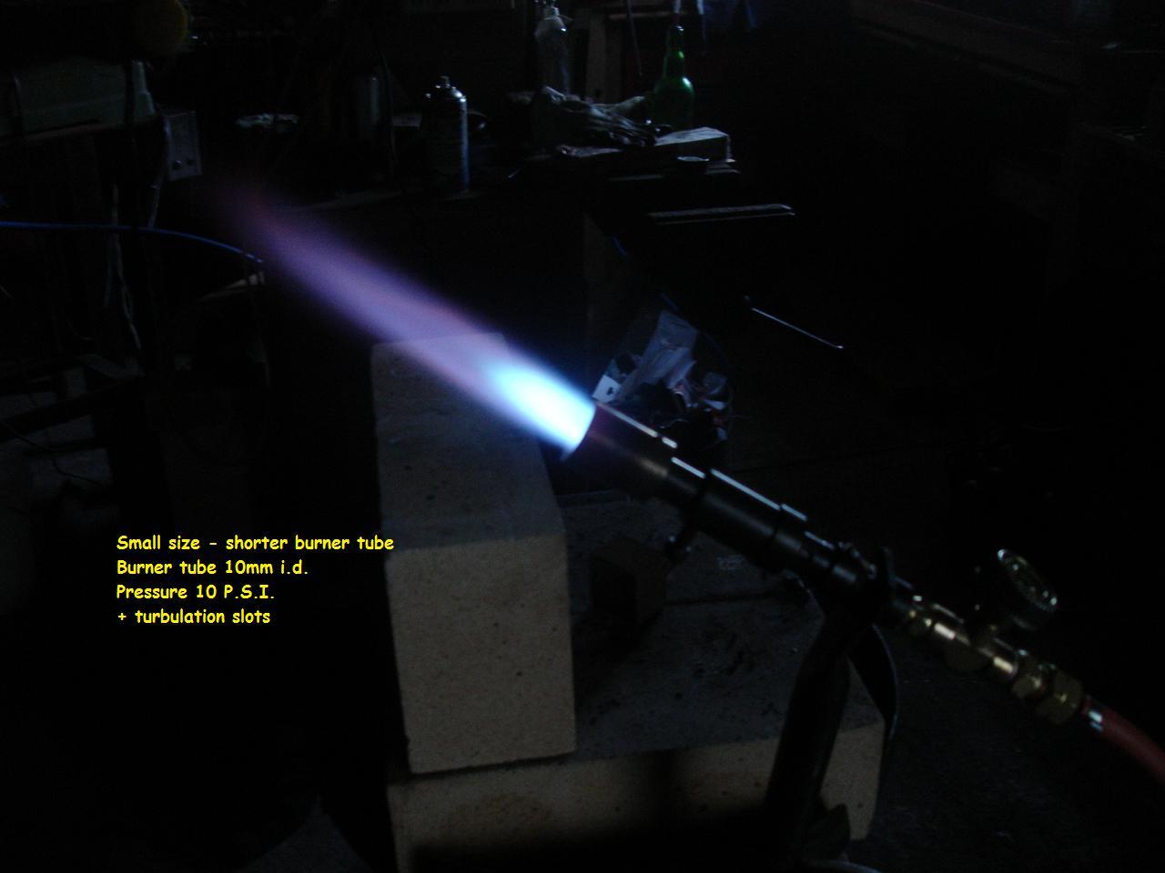

Lads
Some pictures of my early "furnace torch"
I found the "flare" is the most important part of the torch
I used a 0.8 MM mig tip as a jet
Running on up to 30 PSI propane to get a high gas speed
http://i261.photobucket.com/albums/ii63/john970s0/076_zps1f18419e.jpgAtmospheric Propane Brazing Torch Experiments
http://i261.photobucket.com/albums/ii63/john970s0/P5290107-1.jpgAtmospheric Propane Brazing Torch Experiments
http://i261.photobucket.com/albums/ii63/john970s0/P5290110-1.jpgAtmospheric Propane Brazing Torch Experiments
http://i261.photobucket.com/albums/ii63/john970s0/P5290114-1.jpgAtmospheric Propane Brazing Torch Experiments

Offline dranoel58
  • Posts: 4
« Reply #22 on: July 07, 2013, 03:10:06 AM »

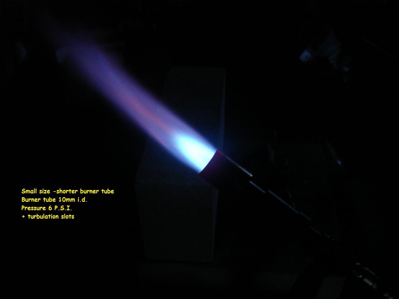

Thanks for the welcome, vtsteam.
The picture was taken before the modification on the turbulance slots.
Wich have made a big improvement.
Now it is a shorter, brush like flame.
The flame seems to hug the heated object more.
As far as your brazing question goes, the answer is no.
That would be streching things too far, for propane/air I think.
Nitrogen content in air, too much of a heat-sink.
mattinker answered your other question about M. Porter.
Have not read the book, but a lot of his info on the net.
Proffesor Google got his name.
Regards.

Have made a few attempts at brazing on a hearth, it is just too hard with a brush type flame, temperature is getting close and it just melts the brazing rod.
But no control, and can’t make a strong joint.

Here some pictures to show that the turbulation slots help to create a smaller, concentrated, primary flame.
It has consumed a lot of time, but it is rewarding to see the result.
Hope it inspires you, P.M. me if you like more information.
Cheers, Regards.
