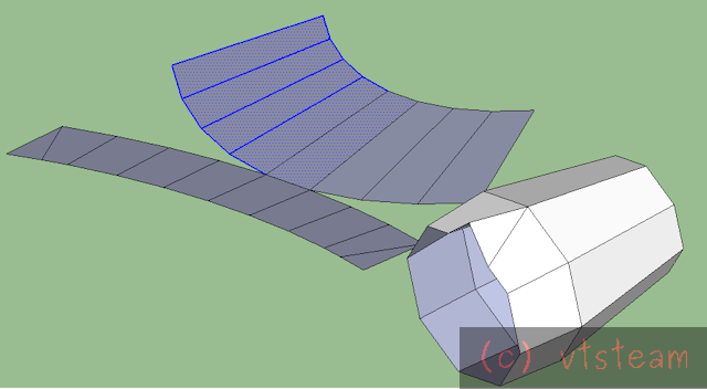

« Reply #9 on: June 07, 2013, 01:09:57 PM »
Since it's raining. I'm just playing around with an older free version of Google SketchUp making crucible patterns. Here's a real simple one -- just two rings, but it does give the bilge shape and has a pouring spout. If you made this, it would actually turn out round rather than faceted into an octagon, though you would see the join line as a hard edge between the two rings.
However internally, it would be smooth since you would line it with 1/2" of clay refractory, and could round the corner out.
This is the same size as the A6 (with bilge added) from the dimensions in  the last post.
I might actually try making this.
ps. I'm not a SketchUp expert -- this is as much a learning exercise as anything else.

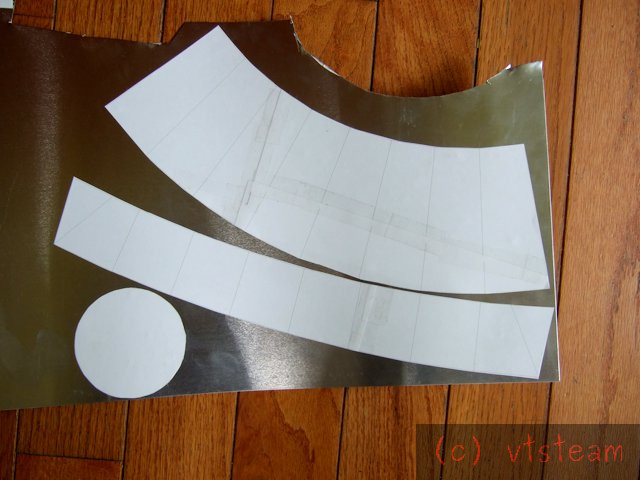

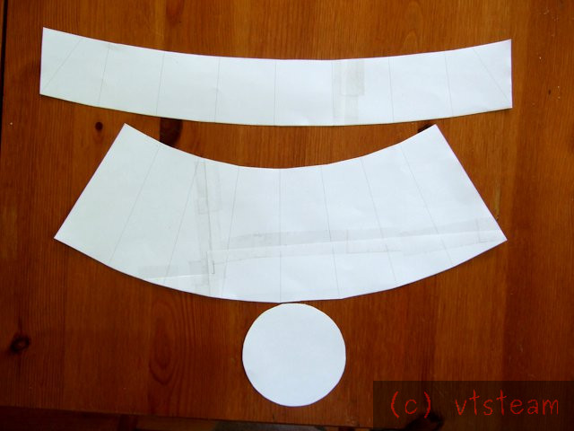

Here's a pattern for making the ladle -- I've made it so it will print out on A4 paper for others here. I'm labeling it a B4 because it is similar to the size of  B4 crucible (or A6 with a bilge added).
Re: Thoughts about making ladles
« Reply #15 on: June 08, 2013, 05:34:30 PM »
Print out and, tape sheets together, and cut them out with scissors:
« Last Edit: January 12, 2018, 09:51:41 PM by vtsteam »

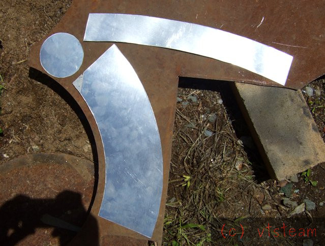

« Reply #16 on: June 08, 2013, 05:36:08 PM »

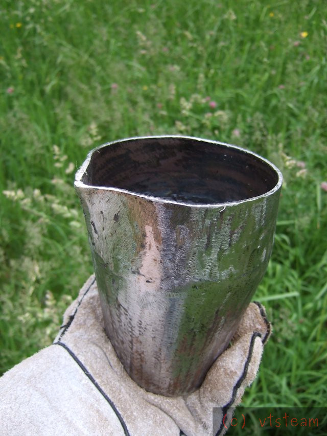

I glued them to some aluminum sheet and cut them out with tin snips to make patterns. I'm sure i'll make more than one, so patterns are handy to have:
« Last Edit: January 12, 2018, 09:52:16 PM by vtsteam »
« Reply #17 on: June 08, 2013, 05:39:09 PM »
Then I used the patterns to mark out some 1/8" plate I had. The plate was cut out with a portable reciprocating Bosch jigsaw, which, with a bimetal blade makes short work of this stuff. Frankly,  faster than a bandsaw, and a lot easier to maneuver on a big sheet of material.
« Last Edit: January 12, 2018, 09:52:51 PM by vtsteam »

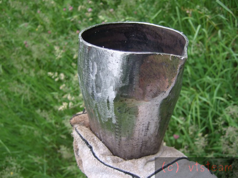

« Reply #18 on: June 08, 2013, 05:41:01 PM »
A little bending, a little cussing, a littl hammering, a little welding, not to mention some grinding and....
« Last Edit: January 12, 2018, 09:53:28 PM by vtsteam »
« Reply #19 on: June 08, 2013, 05:44:37 PM »
An enjoyable little job by the time it was done. I'm impressed with the unfold tool add-on to SketchUp. The pieces fit together perfectly:
« Last Edit: January 12, 2018, 09:54:12 PM by vtsteam »

 :clap: :clap: :clap: :clap:  Very nice Steve  :thumbup:
Offline NeoTech
  • Posts: 826
    • Roughedge Hobbyworks
« Reply #21 on: June 09, 2013, 03:22:29 AM »
That looks brilliant. :)
« Reply #22 on: June 09, 2013, 05:12:16 AM »
Very clever
 :thumbup: :thumbup: :thumbup: :thumbup:

Rob, Neo, Double, Mick thanks!
The unfold tool is by Jim Folz and is available here:
http://sketchuptips.blogspot.com/2007/08/plugin-unfoldrb.html
I use it with an older version of the free version of SketchUp (version 7.1). Along with tools for exporting DXF files and the PhlatBoyz CAM CNC Router output plugin, it makes free Sketcup a much more powerful tool.
For those who want to do similar things to the crucible design without using a CAD program, there is an online  program to generate the projected shape for cutting out cone sections from sheet metal here:
http://www.i-logic.com/conecalc.htm.

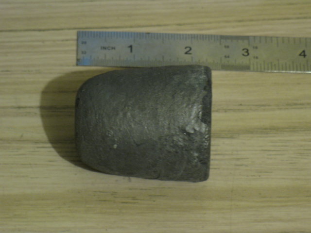

« Reply #32 on: August 03, 2013, 12:07:12 PM »
We were talking about making crucibles on my oil furnace thread, and it seemed like it would fit in better here, since the ladle I made could actually be used as a crucible to melt aluminum or any of the copper containing metals.
But also of interest is the possibility of making an iron melting crucible. Neotech linked to a youtube video of a crucible being home made with graphite, using a press. Although this one, in the end was only used to melt aluminum -- no mention of its suitability for iron. And Vince Gingery wrote a book about using a press to make non-ferrous melting ceramic crucibles -- without graphite.
With the right ingredients seems like you could make one on a pottery wheel with a bilge shape, unlike the prior two.

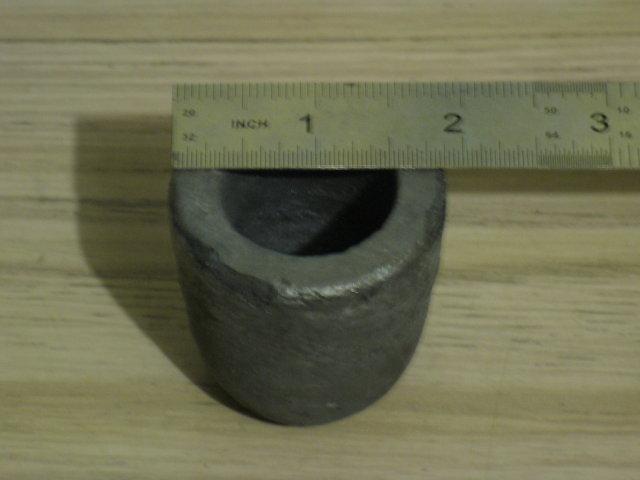

vtsteam Thank you for posting that crucible video it was very informative! It even shows isostatic pressing which I wondered how it was done.
Here is my attempt at using a lump of coke and machined it in the lathe to get the crucible shape. It was used in a microwave oven to melt pewter to pour into a silicon rubber mold.

Isnt turning coke kinda harsh on the machine with all the powders coming off of it?

Wow, Ironman, that was quite an experiment!  :bow: :bow:  :bow: You've found a lot of uses for micowave ovens -- and parts of them.
A place I used to work at used graphite crucibles to do thin film metal deposition on optical filters. As an experiment I once turned one from raw graphite stock for them, but there were too many impurities in it apparently to be useful.
But turning coke is I imagine much more difficult than graphite. Graphite is merely soft, messy and delicate -- but uniform. I imagine coke is not quite so simple. I've also turned graphite to make a hot air engine power piston.
One more example of the amazing stuff you've tried and succeeded with.  :beer:

NeoTech
I covered the lathe with rags to protect the slides and used a vacuum cleaner to suck up the dust before it spread all over the lathe.
Certain coals contain pitch which bonds the carbon to make coke. Pitch is also used to bond coke dust to make carbon electrodes for arc furnaces.
When a crucible says it is carbon bonded it uses pitch as a binder.
