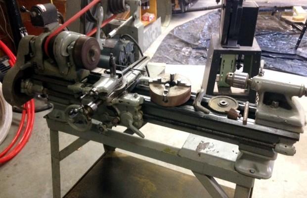

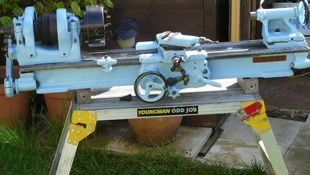

I went to my parents house today and my dad told me his elderly neighbor was selling all if his tools because he was going to a retirement home.  I went over and checked out his shop and found a ton of old wood working tools that I wasn't interested in, but then spotted a metal lathe in the corner.  It was dark in the shop and the lathe was covered in pieces of wood so it was hard to make all of it out, but it looked to be in really nice shape and didn't have any rust on it.  To me it looked like an older South Bend, but it's hard to tell because it was covered with a lot of stuff.  I couldn't really tell if it had a quick change gear box, but it did have a taper attachment.  So far it looks like I may be able to pick it up for one to two hundred dollars and my question to you guys is if this lathe would be better than the 9X20 harbor freight that I have currently.  It does have the old style open belts and I'm wondering if this has the older babbitt bearings?  If so is that a bad thing and are they hard to replace?  I know nothing of these older lathes, but I do know that I'm sick of constantly having to re adjust my 9X20 harbor freight lathe as it's always out of alignment.
This is NOT the actual picture of the lathe for sale, but one that I found on the web that looks a lot like the one for sale.
The lathe had "V" ways and a flat belt.  The tail stock was rather wimpy looking compared to the ones in the photos.
Hopefully I can get back there this week and take a closer look at it.
Thanks for the help!
Dale P.

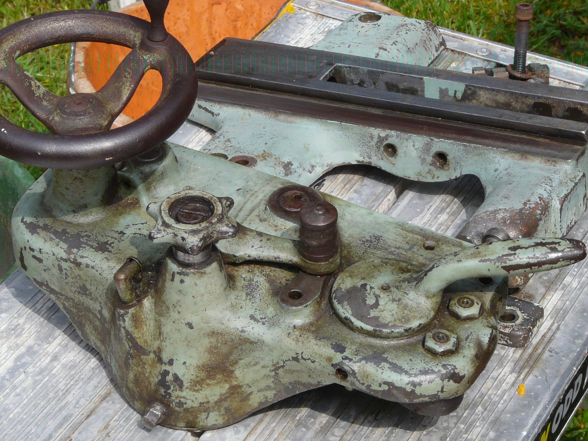

The bearings lasted well if oiled every time the lathe was used , check out Tony's site http://www.lathes.co.uk/southbendmodelfive9inch/ all the information you will need .
Re: Possible New Lathe?
« Reply #2 on: May 13, 2013, 02:34:55 AM »
Hi Dale,
You may find these pages of interest:
 http://www.lathes.co.uk/southbend9-inch/index.html .Note the reference half-way down, under the circular drawing of a ball thrust bearing, to the spindle running direct in the cast iron of the headstock. I suppose this will limit the spindle speed to rather less than your 9x20.
That said, it was a good design, as attested by the fact that it was widely cloned all over the world. The versions illustrated in the above pages all have South Bend clearly cast into the
RH front of the bed; so you should be able to tell if the one you are looking at is real, despite the flimsy-looking tailstock.
In your place, assuming there is nothing obviously wrong, at that price I'd buy it and try it, particularly as it's nearby. But I'm good at spending other people's money.

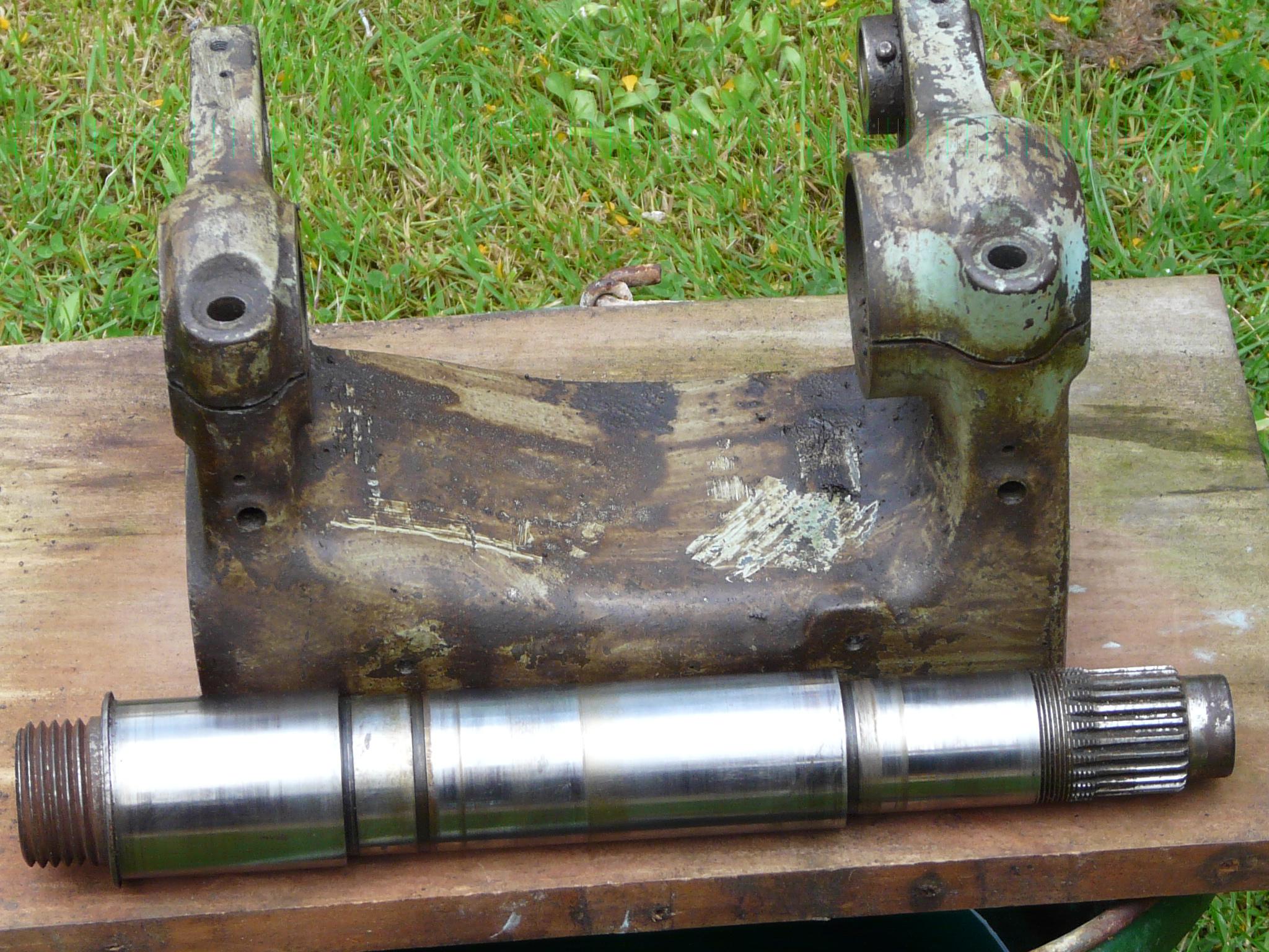

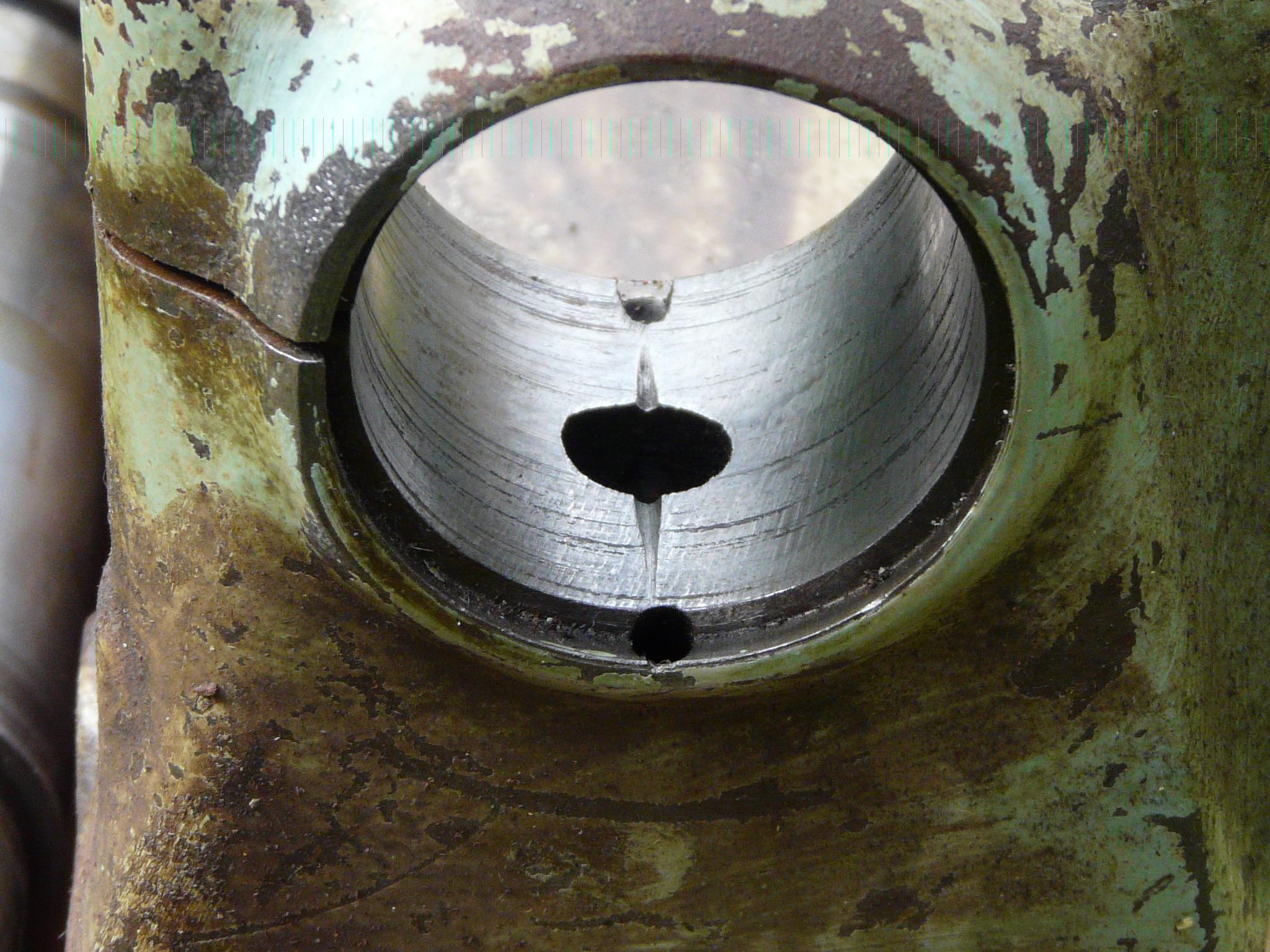

« Reply #6 on: May 31, 2013, 03:40:23 PM »
The head stock bearings are cast iron adjusted by removing shims ,
