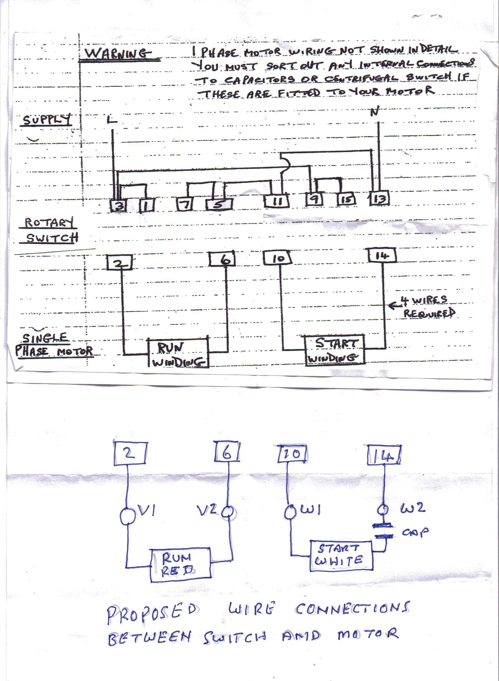

Here is the supplied diagram and my proposed connection to motor.
The connection to the motor are exactly as Rob's picture shows.
Re: single phase motors.
« Reply #21 on: June 05, 2013, 03:51:11 PM »
Looks good to me Dave  :thumbup:

As it turned out there was a problem.  Motor ran forward,  but not backward.
After a couple of checks of the wiring I striped off all the switching and re-assembled as a single direction motor just using the old start button.  It ran with no problem. Even in reverse when I had changed the straps around.
There was nothing wrong with the way I wired the switch.  double checked it.
So I have come to the conclusion there is an error in the supplied wiring diagram.
Anyway,  I know how it should be wired thanks to some of you guys. Earlier today I traced all the connections on the reverser switch and it is actually comprises of 16 single pole switches. Eight work for the forward motion and eight for reverse. Lots of links needed.
I'll let you know exactly where the problem was when I find it.
One chunky double pole double throw switch would do the same thing as this ghastly thing.  Cost me a fortune.

« Reply #25 on: June 07, 2013, 07:03:57 AM »
Dave,
I burnt a bit of midnight oil an and managed to work out how the switch should be wired.  So now it works correctly.
The secret seems to be that the run winding needn't be switched. It stays the same in both forward and reverse.
So, switching the start winding becomes  a simple change-over switching operation.
As it's wired at the moment I don't have a centre off position on the switch.  Two forwards and a reverse. I know why this is but as I will be turning the motor on and off with the zero-voltage stop-start switch it doesn't matter.  Most of the time I will be in forward for normal turning. I do know how to fix it,  but have had enough of switches for the time being.

« Reply #26 on: June 07, 2013, 07:35:25 AM »
That's right, one winding is always 'On'. ie. Not switched.
Just 'end for end' the other one. Doesn't matter which, but usually the start winding.
But if the motor is running and you just change over the start winding the 'run' usually wins and the motor now has the run winding going one way and the start trying to go the other.
As that winding is in series with a capacitor it's current is restricted by the reactance of the cap, so it doesn't have the guts to do much. ( If it's 10uF the Xc is some 318 ohms @ 50 Hz).

Hi,  doing a bit of dead thread resurrection.
I happened to be wondering why the motor (subject of above posts) gets so hot when running.
Could it be because the because the start winding and it's associated capacitor are always in circuit ? And thus are across the run winding.
I was thinking that the phase difference between the two windings may be causing the heating.
Perhaps a modification to cut the start winding out when the motor is running would be beneficial, what are your thoughts ?

Hi David,
In my experience (35+yrs) I have never seen the run winding with a higher resistance than the start
so I think the capacitor is connected to the wrong winding ????
Have you measured the current when the motor is running and compared it to the data plate?
No load amps will be much lower than full load, but incorrectly connected amp readings will be higher
Of course cheap imported motors will not have top quality lamination's and these will run hotter
There maybe a temp rise figure on the data plate ?

John,
Just been looking through my notes, and I also see a reference to the start winding being higher resistance to the run winding.
At the moment I have the wires disconnected from the motor terminal block as I was doing some coil resistance measurements. But tomorrow I will re-connect and see what the current draw is.
My thinking was that as it appears the two windings are in parallel (with one winding having the capacitor in series with it), the winding with the capacitor would be 90% out of phase with the other.  OK for kick-starting the motor, but maybe not so good for continuous run.
I'll get back tomorrow and let you know what I find.
« Reply #36 on: October 02, 2019, 02:00:17 PM »
Well, I ran a few checks, I have come to the conclusion I am worrying unnecessarily.
The motor plate states 230 Volt, 1 HP at 5.6 Amp.
I measured a mains supply of 247 Volt (checked that with another meter, it's correct) and a current of 4.87 Amp.
The above is no-load.
Motor sounds ok. I dismounted it from the lathe and ran it on the bench.
Also found out that it will start and run without the start-winding and capacitor in circuit. But it draws more current (6.64 Amp) and the direction of run is random.
So, I'll clip my thermocouple meter to one of the fins and run it for an hour on the bench to check the temperature does not get too high. Then bolt it all back on the lathe.
