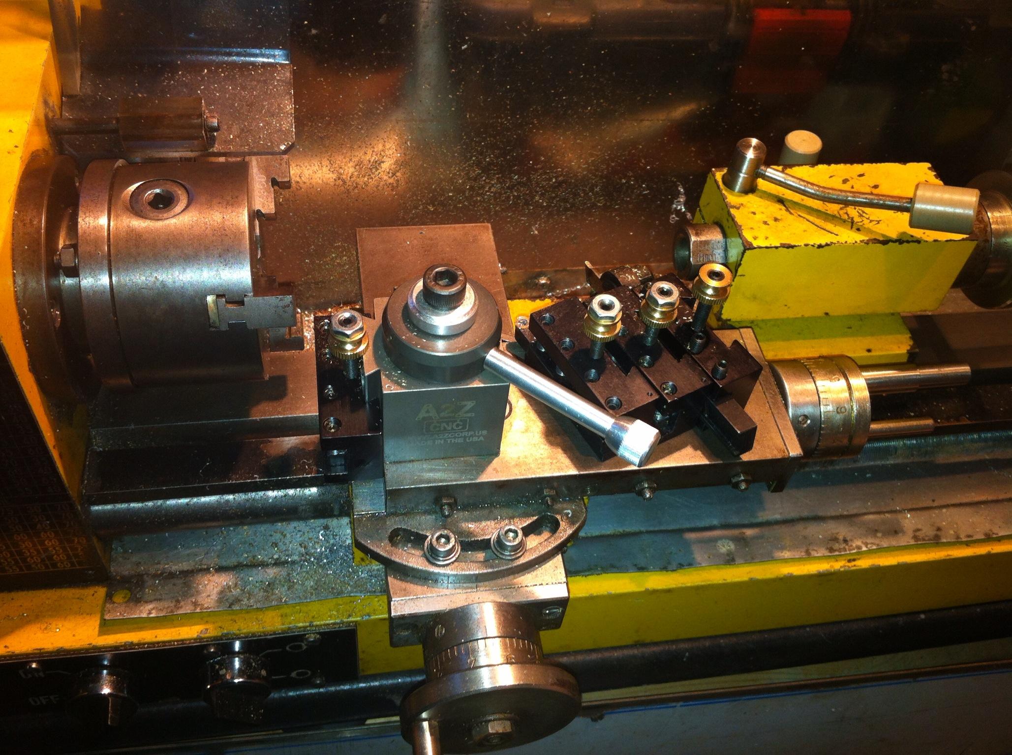

decided to upgrade my hobbymat toolpost to a QCTP i bought
the probolem is i can only use 6mm cutting tools in it  due to the tool holders being so small
So i thought i would make a couple more :smart:

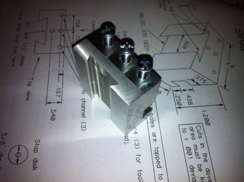

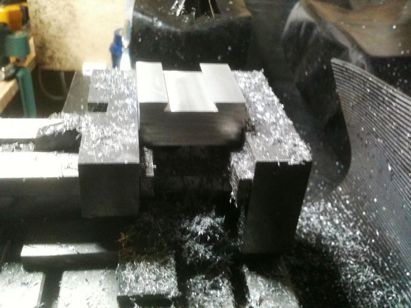

First started off with a block of aluminium in the mill
Roughed out the initial depth and width of slot 26mm wide 8mm deep ish then got my 60deg dovetail cutter(first time i have cut a dovetail) cut the first side using verry fine cuts until it looked right then cut the other side and used the tool post as a guide not verry technical i know but heyho it worked for me :dremel:

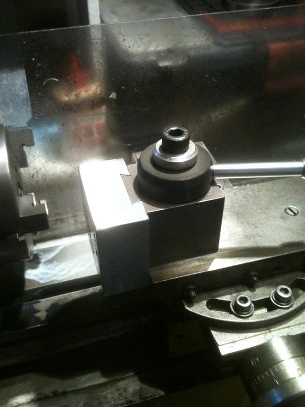

oh yes after the cutting of the dovetail i then offered the holder to the tool post so i could get a line for my cutting tool
then milled out the slot cleaned up the ends and tapped some holes for the clamping bolts

          Nice job on the tool holders, I would change the screws to socket head cap screws. You will be able to tighten them much more with an allen key, ensuring maximum firmness of your tools.

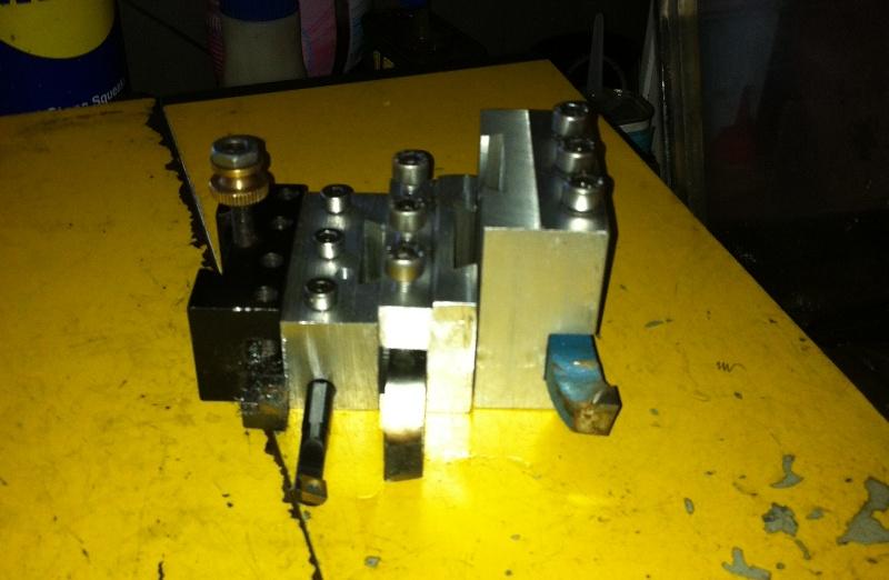

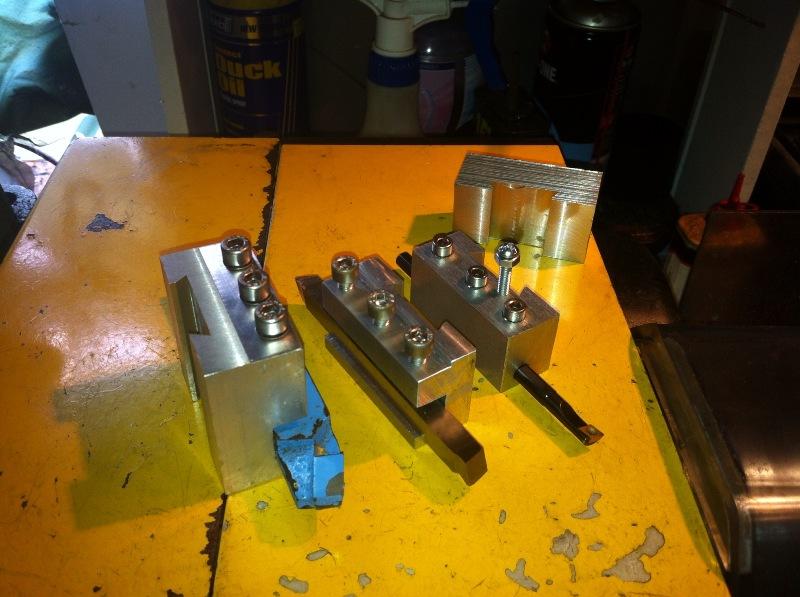

last couple of pictures for now
David i took your advise and used allen bolts
heres the tree i have made so far
1 has a 10mm cutting tool in it
2 has an 8mm cutting tool
3 has mu 6mm tiny boring bar in it
and the next shows against iht origional black holder with 6mm tool

Alb, how are you going to set the centre height i.e. limit the level to which the holders drop down on the post? I assume the black holder came with the QCTP, and has the usual stud sticking out of the top with knurled locknuts on it to limit the drop, but those you made don't.
  • Posts: 6830
Re: HOBBYMAT UPGRADE
« Reply #9 on: May 22, 2013, 07:21:11 PM »
Think I see holes for the depth screw in two of the holders. Didn't see one in the big one, but I bet there's a plan.

           I made my first one to make sure it fitted correctly, then I used an aluminium bar long enough to make six. I machined the bar to the dimensions of the first one including the dovetail, then sawed the bar into six pieces,leaving only two sides to skim. This is a great time saver, and you will find you need more. Glad you fitted the socket screws, now they look right.

Andy, well spotted the large holder will not have a height clamp it rests in the compound slide but i have got them on the smaller ones now.
David i did the three smaller ones the same as you with a long peice of flat bar Note to self dont waist time trying to cut them off with a slitting saw:-( did one in about 1 hour then hacksawed the other in about 10 mins
