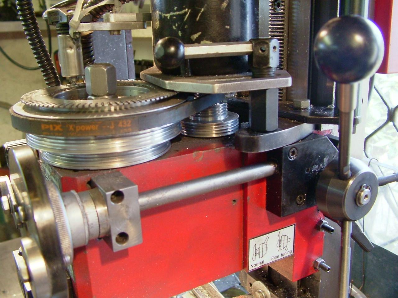

« Reply #6 on: April 05, 2013, 10:03:21 PM »
Are you losing power or is it that the job in hand is stalling the motor. Stainless steel is a very tough metal to work with.
Cutting oil is essential for good results.
If the belt drive is less than 5.45 to 1 then there is reduction in the torque available at the spindle
1100 rpm is the original low speed on an X2 Mill with the motor on FULL speed of  6000 RPM
 Therefore if the spindle speed is is greater in low speed then the drop in available torque is proportionately less.
Please check the ratios on the belt drive you have fitted.
This is the specs for a Steele's belt drive kit lifted from their sales pitch.
""Change speeds without any tools. Simply remove the guard, loosen the lever locks and move the belt from one pair of pulleys to the other. Low speed range is 0-1700 RPM. High speed range is 0-4300 RPM.""
This equates to at least 30% reduction in torque at the spindle.
Hope this is some help  I Added a Photo of my Mk 1 belt drive

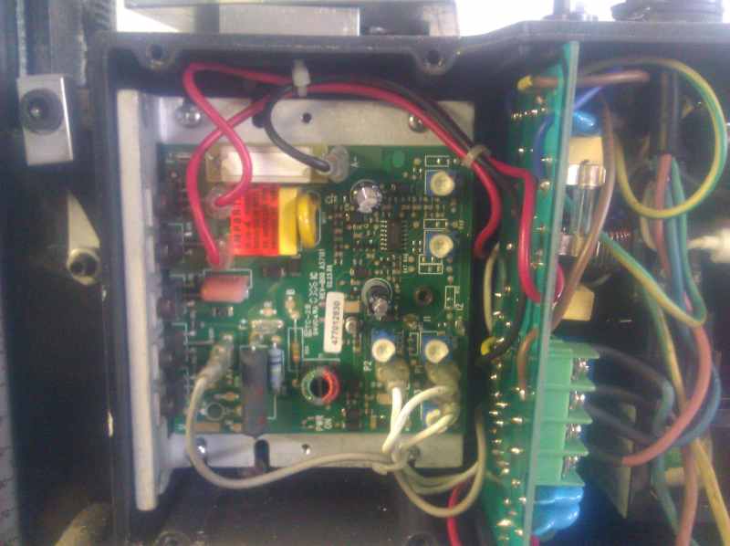

« Reply #7 on: April 19, 2013, 08:46:33 AM »
I thought the power issue was resolved. I twiddled the pot meters a bit and it seemed to be better.
But then yesterday I was drilling a 10 mm hole and again it stalled. Even though I had pre-drilled with 5 mm.
And it was a relatively new drill too.
Anyway, I have attached a photo of my control board. I wonder what the end result will be.
Thanks for any help you guys can give me.

« Reply #8 on: April 19, 2013, 10:24:53 AM »
That's a KB board...
What experience do you have  of electronics?
I can send you the schematic to work through... :zap:
The majority of faults are  caused by dried up capacitors/zener diodes/dodgy potentiometers..
Component replacement isnt particularly easy because the parts are smd or pth...
I'd start by checking the 12v rail and the 22v rail, but you need a schematic...pm me your email addy and I'll email you a copy

« Reply #9 on: April 20, 2013, 08:48:22 AM »
After receiving the schematic from John (Thanks John) I realise this is going to be a bit more of a challenge that I initially thought.
For instance, John told me to check the 12 and 22V rails. I can only find the 12V one on the schematic.
Does anybody know what the IR and CL pot meters are for? MIN, MAX and Accel I can figure out. But the other two, no not yet.
Lykle

« Reply #10 on: April 20, 2013, 09:28:24 AM »
Hi Lykle,
CL is the current limit adjustment, if set too low it could reduce the motor torque, set too high it could cook the motor... If you fiddle with it, put an ammeter in one of the motor leads, reckon about 4.5 Amps per HP on 220/240v, 9 Amps on 110/120. EDIT - AT FULL LOAD - 1 hp load is about a cubic inch per minute of hot-rolled steel with HSS cutters and flood coolant, figure a 1/2" endmill, 180 rpm, 1/16" depth of cut at 32"/min feed, cutting a slot...
The 'horsepower resistor' (tan block on the daughter-board) should be marked with two values, the higher is for 220/240 volt supplies (180 to the motor), t'other for 110-120 (90 to the motor) - check the marked value!
IR is the IR compensation adjustment, which allows for the *resistive* losses in the armature at low rpm where that increases relative to the motor's back-emf (the 'generator' voltage from the coil cutting the magnetic field, proportional to rpm) to maintain torque at low rpm... There's a sweet spot, too far one way and the motor stalls under load at low rpm (Aha!), too far the other and the motor starts cogging (moving in jerks at low rpm rather than smoothly)
If you feel confident and competent to have a twiddle, bear in mind that the KB boards aren't isolated from mains, so keep your fingers clear and your other hand in your pocket...
If the belt-drive doesn't give as much speed reduction / torque multiplication, you may be limited by the change in gear ratio, as others have pointed out...
Just my ha'pennorth,
Dave H. (the other one)
Re: My X2 mill is losing power
« Reply #11 on: April 20, 2013, 12:17:36 PM »
Lykle
Lykle,
The 22v volt rail is straight off the big 15k resistor R17a...and is stabilised by ZD2 which is on the left side of the board looking down with the pots along the front...
If either of these rails are low, then the zener diodes are first suspects...followed by C19 and C1
(I've actually had one of these boards fail where the LM324 has been responsible for low voltages)
