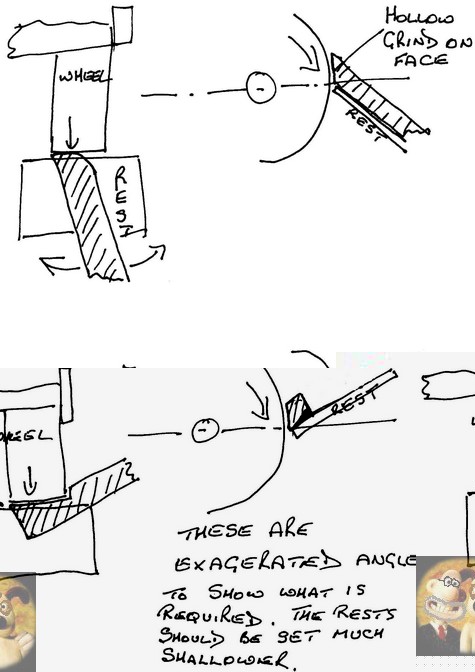

Re: fly cutter
« Reply #21 on: August 17, 2010, 03:27:23 AM »
Wong,
Don't remove the toolrest......  :scratch:     It is there to support the tool, while grinding!  ::)
Hold the tool on the rest, but tilted at an angle to it. (About 5 degrees), to give cutting clearance.  :thumbup:

« Reply #22 on: August 17, 2010, 09:05:47 AM »
Wong,
Leave the stud alone, but file the slot in the toolrest a bit wider (not much is needed! Only from the downside), so it will be possible to tilt it. 5 degrees like Stilldrillin says will be just fine for most things. No need for a protractor here, it´s more like a ballpark figure.
Olli

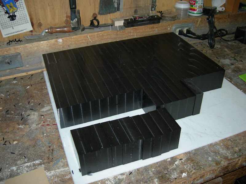

Here's the only 2 pictures that are needed in my opinion:
The black line near the tip is some built up HDPE plastic that I didn't notice when I took the picture.
This tool is held in the cheapest, worst finished piece of Chinese cra..er..steel that I've ever had in my shop...but it works.  :beer:
It made all these blocks the same size within .002" in either direction. Not bad for a hand ground tool and horrible tool holder!
again  :beer:
Can I say that the black line is the edge that was doing the cutting?  Mine was further up to the left (the straight part) of the cutter in your pic.  Could be the angle of my holder.
Yup.  The curved part is what's supposed to be cutting.

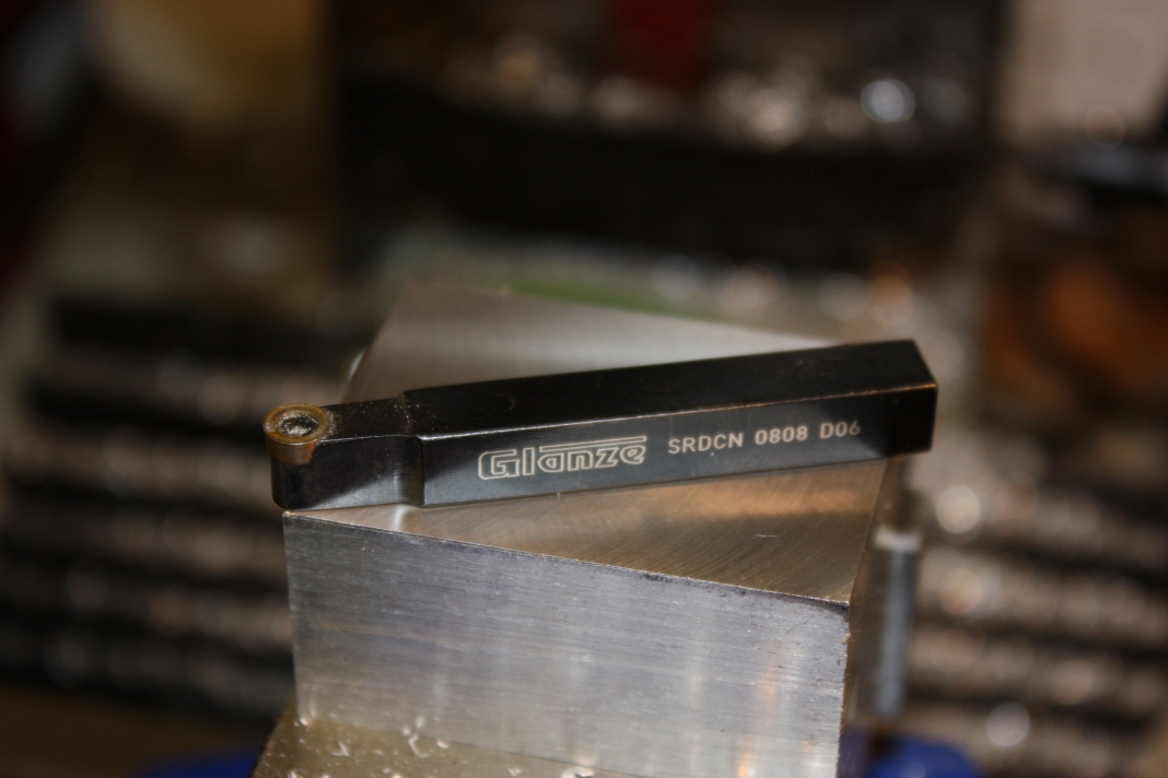

« Reply #47 on: September 11, 2010, 05:06:09 PM »
This is my take on your question:
We're using left hand tool for this. When placed in the slot of the fly cutter, the top of the tool faces to the side. So the top is now the side in this orientation.
I believe that is the case.
Think of it as a lathe tool.  If you used a lathe tool as a fly cutter, you'd need to turn it on its side.
I took this statement of mine, and a bit of  :proj: struck me.  See the attached images.
That's a 5mm dia. profiling tool on an 8mm holder.

« Reply #48 on: September 11, 2010, 05:28:07 PM »
 :nrocks: great idea is that the finish under the tool ?
Jason
Offline No1_sonuk
  • Posts: 242
Re: fly cutter
« Reply #49 on: September 11, 2010, 05:38:37 PM »
Yup.
It looks rough, but it feels smooth - I'm assuming my lack of flycutting experience contributed to the look of it.
BTW, that block is aluminium.

Yup.
Whaddayamean "rough"? That surface looks almost glassy. You'll be there for hours with the ultra-fine wet&dry, polishing compounds and other paraphernalia trying to get a better surface than that...
Seriously, that looks really good. And great idea to use the button insert tool, that should be good for steel and even this lousy ali-bronze stuff I'm using just now.

That's a good idea!!! No need to rely on my grinding skill, or the lack of it...
Are you able to give me the angle of that holder of yours?  The part that is slanted to the horizontal.
Regards,
Wong

« Reply #52 on: September 11, 2010, 06:13:03 PM »
I'm not sure of the exact angle - it looks like about 20 degrees off horizontal.  It's a body I bought that came with an unground HSS tool.  I just took that out and put the lathe tool in instead.
I should think just about any angle would do, though, as the cutter is circular.

Last night I discovered a flaw in my cunning plan...
Be careful if you try fly cutting up to a shoulder using an insert lathe tool.  Depnding on the design of the tool, the support behind the insert might not have enough clearance to get round.
Mine didn't :doh:
On the tool I showed above, the support goes straight down/back with no angle.  It was designed as a lathe tool, which doesn't need a relief angle.  Of course, one could always make or modify an insert holder specifically for the job with sufficient undercut.

Having read this post all the way thru, it seems I caused some confusion with regards to 'TOP'. If you actually go to the first page, and find where I put up the grind pics with the pretty red lettering on, directly under the last pic, I explain what is meant.
Another couple of points that do need to be brought up. The radius of the cutter should be the width of the cutter blank, so for a 6mm blank, the radius should be 6mm, not elongated as some of you have done.
The other point is the direction the faces need to be ground. The direction should be with the grind marks at right angles to the cutting face. Do the radius grind first, then the front of the cutting face. Doing it that way, you are doing just two grinds. You sharpen by rubbing your stone against the vertically ground angled face, not around the radius grind.
I have done a C-o-C to try to explain what I mean.
Bogs

Hi Bogs,
Glad to "see" you in here.  Hope you're better.
I did the radius about the size of the tool width but it seemed that the cutting action was at (or almost) the shank.  So I "lengthened" the cutting edge but grinding it longer.  It could be the angle of my holder being too shallow.
Regards,
Wong
Offline Bogstandard
  • Bogs Group
  • Posts: 1107
Re: fly cutter
« Reply #60 on: September 15, 2010, 10:02:33 AM »
It just might be that Wong. You are not getting the correct edge shape presented to the work.
I do in fact use the back cutting face as well. If I see my tram is slightly out, I use that to my advantage, as the return cut (without putting any further cut on) can just take 'wisps' of material off, and that is what gives you the mirror finish. I will run my fly cutter fairly fast, well above 500 RPM most times, but at a very slow feed.
Plus lubrication always works well, especially with ali, as that is liable to pick up on the cutter and swipe it across your nice mirror finish, I use WD40 for lube on ali, brass or phos bronze and cast iron doesn't need it, and for normal steels (I wouldn't recommend a fly cutter on really tough stuff) I just use normal water based coolant/oil mixture from a squeezy bottle. Basically, to obtain a very nice finish, you have to attempt to keep the removed material from being carried around to the next cut, so by using a lube, the fine swarf is thrown away by the liquid being thrown around by the cutter, the ones that require no lube, automatically eject from the surface by themselves.
Bogs

« Reply #61 on: September 15, 2010, 07:08:22 PM »
Thanks Bogs.  I'll redo the grinding.
Regards,
Wong
