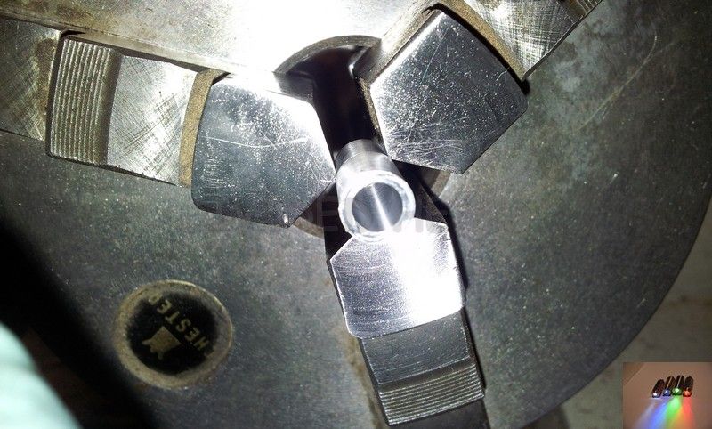

A while ago I needed to get a nice finish on a cylinder I was making... I hadn't got a boring tool small enough for my application.
So, I came up with this. I used it again the other day and thought it might be of interest to others?
A little show and tell....

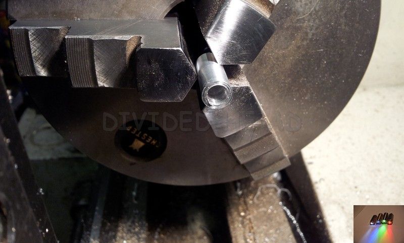

First a sacrificial piece of aluminium drilled out at 5mm. (this will work on 3mm upwards.)

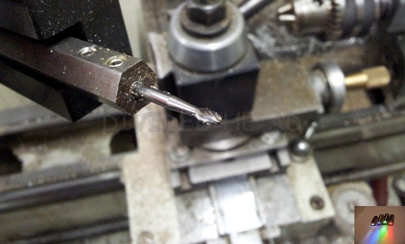

Then the tool... A carbide 1/8th burr held in a piece of steel hex by a pair of grub screws.
A slight kick over to prevent fouling as the shaft is slightly larger then the head of the burr.

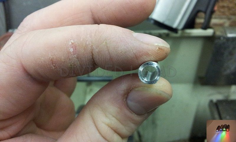

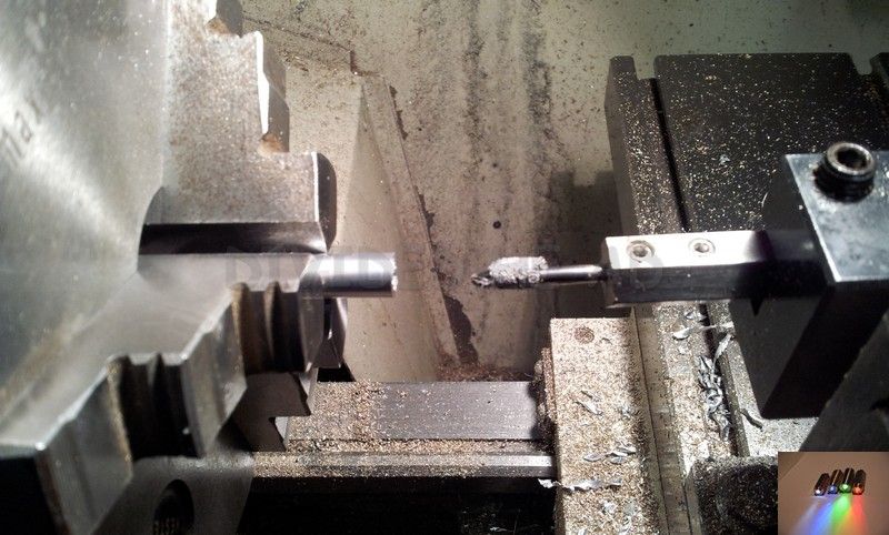

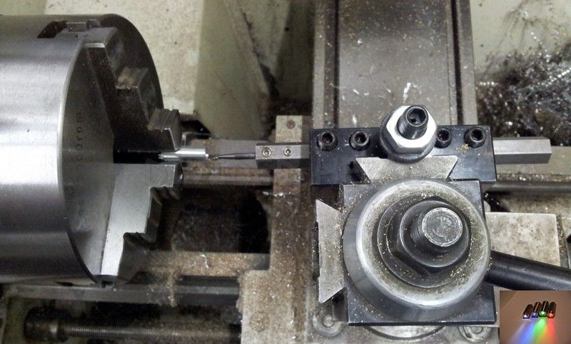

Add a very fine cut and a quick squirt of WD40 and send it down the bore under a slow power feed...  the result is a mass on very fine swarf shavings.
And a nice smooth bore   :thumbup:

« Reply #7 on: May 03, 2013, 12:33:49 PM »
I've used the good side of a 3mm 2-flute slot drill with a chip on the other side, but the burr is a better idea. More cutting edges to go at, and because it is pear-shaped, varying the top slide angle will bring new bits of edge into play.
But how do you set it on centre height, and is there a danger of two edges cutting at once, one above centre height and one below?

Setting the height.... I rotate it so it looks like a flute is horizontal and set it by eye.... Worked every time I've tried it so far :dremel:
That's all I can offer Andy. I'd guess that if two edges contact the deeper one would give the finishing cut? But this is a guess.... Never looked since it always worked.
