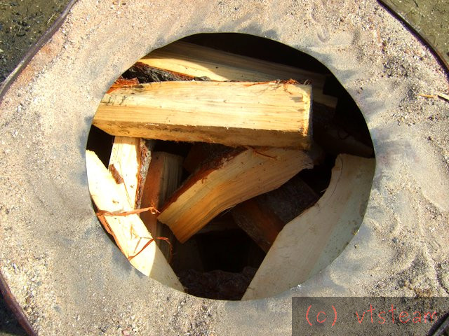

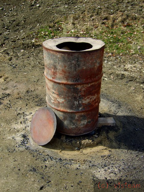

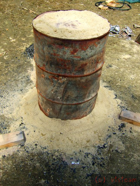

A 55 gallon drum with an open end on bottom and a hole cut in the top. Also a circle of 1/8" sheet a few inches larger than the drum hole to form a lid.
The drum is supported on 3 firebricks. Sand is placed around the base and kindling and old brands are placed in the bottom of the barrel.

A post is set vertically in the middle of the barrel to act as a chimney form when packing the wood in. After loading wood, the post is removed leaving a center space, as seen here.
« Last Edit: January 07, 2018, 02:39:40 PM by vtsteam »

I also regulate the fire by adding more sand around the bottom of the barrel.
Eventually when the wood has burned down to about 1/3 its original volume, I cover it completely with the lid. I pull the firebricks out from under the barrel while supporting it with a shovel in one hand to keep it from tipping over.
Then I put sand on top of the crack in the lid to seal it. Sand around the bottom is piled to seal that, as well

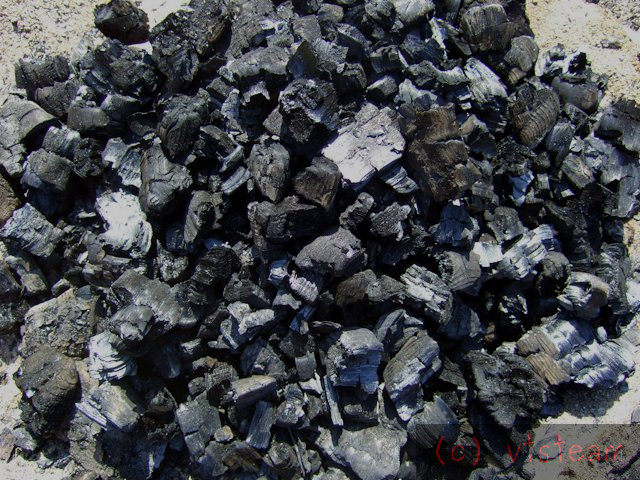

The whole process takes maybe an hour.
Then it's time to let the barrel cool. That may take 4 more hours. It should be absolutely cool to the touch. If not, it may be that air is still being allowed in through a leak. You must seal the leak and make sure the fire is completely out with all embers dead before opening it up. So check after a coaling a few times and wait for cool!
The result, charcoal!

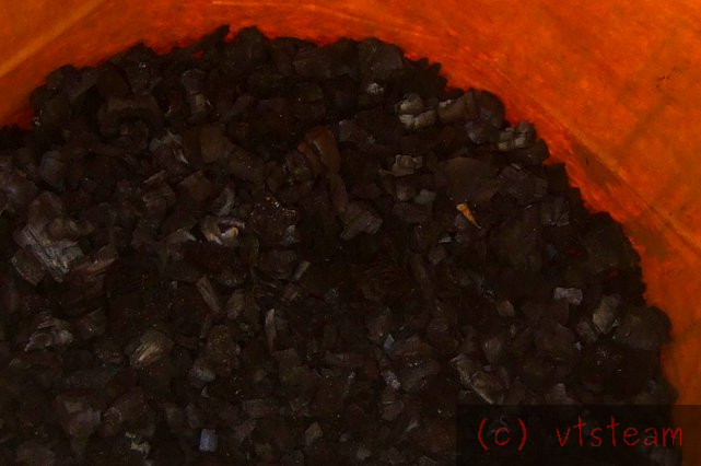

20 gallon leaf bag filled with hardwood charcoal.
Before bagging, be absolutely certain that the charcoal is dead out and cool. Best to wait a day before bagging, just to be safe.

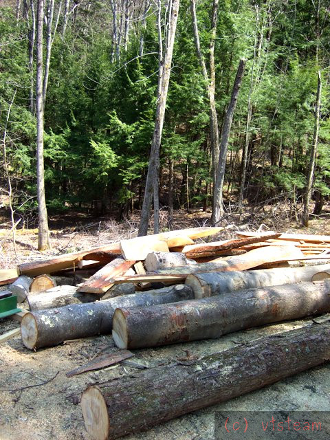

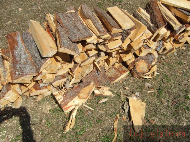

The wood I used in the photos was white pine slabs (wane) from my sawmill. The charcoal is therefore softwood charcoal. Prior burns this week were maple. Other frequent hardwood for me here is black birch (sweet birch).
There are many charcoal making methods, some of which I've tried in the past. But I like this one the best because of its simplicity, speed and easy control of the burn. I don't believe it is much more wasteful than any of the others, and I have a great surplus of wood to get rid of anyway from my sawmill.
Re. pine: hardwood charcoal is denser than softwood charcoal, and a more suitable furnace fuel. But I'm working on an idea for densifying the softwood charcoal into briquets. My cupola needs charcoal in the 3/4" size so I don't need big pieces. A lot of experimentation will go into this starting shortly.
Here's a picture of the pine wane cuts I used for the above burn, and  and birch and soft maple logs and awaiting the sawmill, as well as scrap wood.

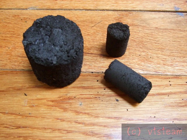

I have been thinking a lot this winter about densifying the charcoal into briquets. If I can achieve the same density as coke then I think the consumption rate might be the same, since they are both pretty much pure carbon.
Briquetting might also make softwood charcoal viable as a furnace fuel.

Above are some experimental charcoal briquettes. The large one was made this winter and is fully dry. The smaller ones (3/4" diam) were made this afternoon from softwood charcoal. They need to be dried before I can get an estimate of density.
The large briquette is probably hardwood, but the grain size is rather large compared to the smaller ones. I think the new softwood briquettes will actually be denser because the charcoal was more thoroughly crushed.
I do have a density for the large briquette. It is 0.58 g/cc.
Charcoal is generally less than half that (0.2-0.3), while furnace coke is 0.6 to 0.7. So I believe I can get in the ballpark.
I can also make it uniform size to suit the cupola. I think 3/4" is going to be appropriate -- at least according to Stewart Marshall.

 What is the binder you are using for the briquettes?

Ironman, I just used a very small amount of flour in water. I imagine corn starch, wallpaper paste, etc. would all work, but flour was handy.

Density of the small softwood pellet looks to be 0.56 g/cc. That means it is about the same as compressed hardwood charcoal. Which actually makes sense. Only the physical structure of softwood makes it lighter. The material, nearly pure carbon, is the same. We're interrupting that structure by compressing it.
The original softwood charcoal it comes from averages about half that density. So I would expect the energy density to be about doubled. Probably less for hardwood, but the result is the same with either material.
One question I have is, will the binder keep it together in the furnace long enough to be useful. I'm guessing yes. I do think the consumption rate will be higher than coke, as I expect it will fragment to some degree, and produce more burning surface. On the other hand that could mean a hotter temp in the melting zone. It may be that the size of the pellets might have to increase a little above rule of thumb for coke in a cupola.
That would reduce surface area, increase space between pellets, and balance the fuel air mix better if compressed charcoal burns hotter and faster. More convenient briquetting also.

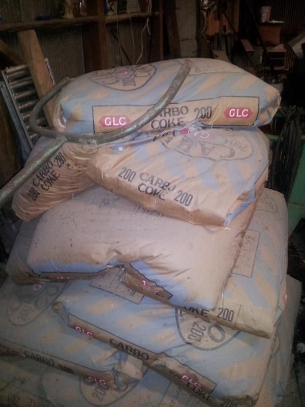

I tried the above with wheat flour and used 91% rubbing alcohol as the wetting agent.  I didn't let it dry but it lit instantly and burned for a while on its own, it didnt crumble when i picked it up either, I concur that probably will last a while.  I was just curious if there were other wetting agents that would be better doesn't seem like stuff that contains water is the ideal thing. I know in pyrotechniques most guys use denatured alcohol to form up a charge since it doesn't contaminate star burst and lift charge compositions.
I've been looking for a way to load up my furnace on good charcoal. Store bought sucks I can burn them up in about 15 minutes on high and the slag left behind is less than desirable.  I got all of this free lumber from the desert this afternoon, it took a few trips in the Ranger to get all of it that wasnt eaten by termites, people take it upon themselves to dump stuff in our desert unfortunately they've been doing it for awhile and that is one reason why we are losing the ability to use it.
http://img542.imageshack.us/img542/9246/85nh.jpgMaking Charcoal
 Everything I have gotten has been from the desert. This score of fuel should last me a few years, or if we do it by furnace re-lining quite a few.
