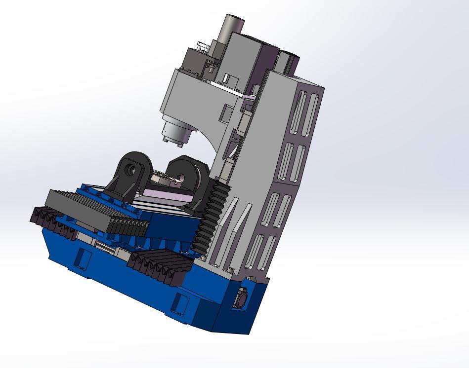

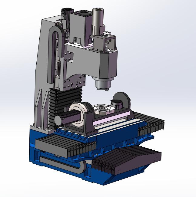

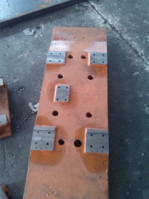

 HI   verybody!
 I come form china

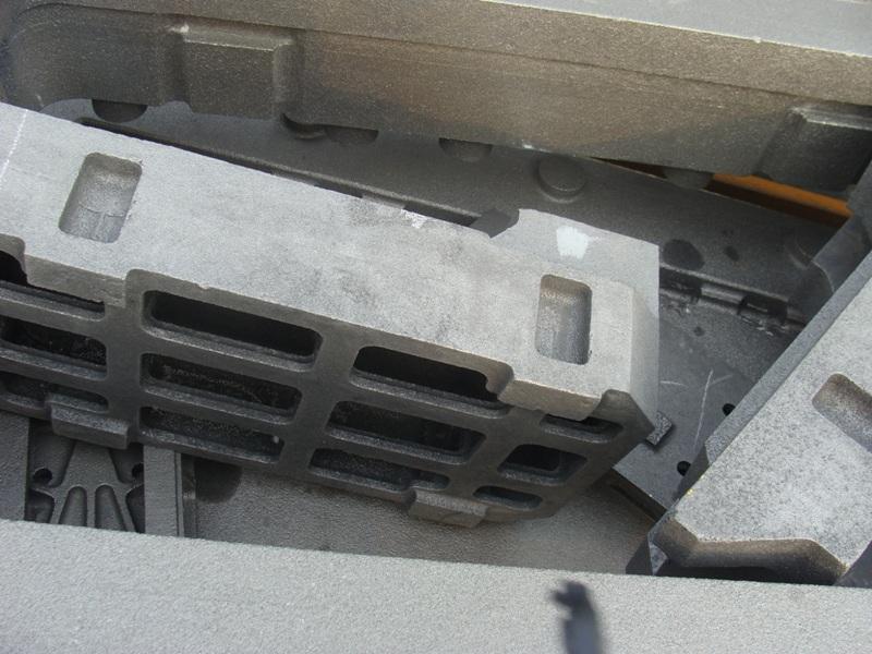

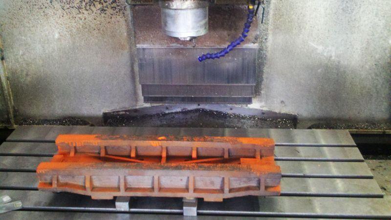

I am going to make a CNC

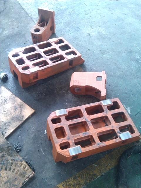

« Reply #1 on: April 20, 2013, 11:34:47 AM »
Hi haoxiaoquan

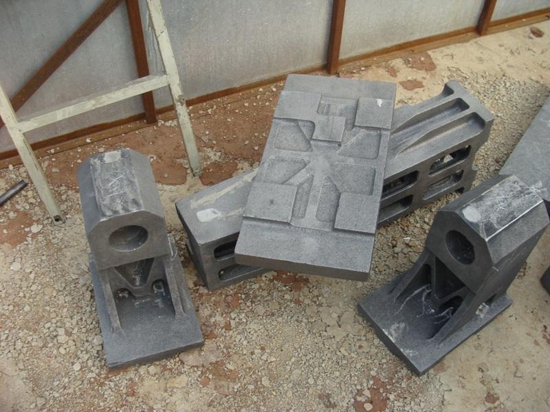

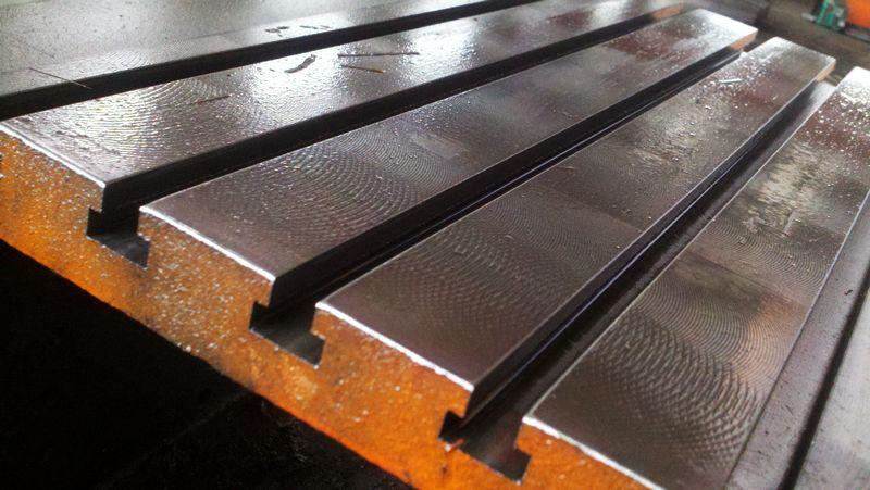

Those castings look great , did you cast them ?

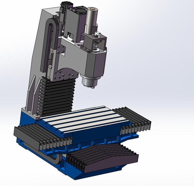

I like your CNC design  :thumbup: , I wish I had just built my CNC mill from scratch .

Hi Haoxiaoquan,
Very nice looking machine and castings.  :thumbup:
I have a few questions:
Are you going to use stepper motors or servos?
Is the smaller unit on top of the spindle for an auto tool changer?
What power and what speed will the spindle be capable of?

« Reply #4 on: April 20, 2013, 12:20:16 PM »
Hi Phil>< :D
the first I have told you my poor English;

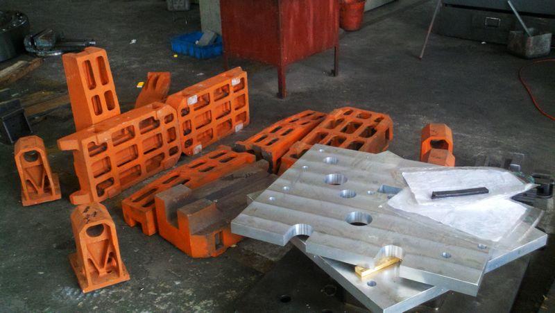

I will use the Siemens servo motor  Model v80 400w
Screw   2005  C7     Track  is   25MM
 The spindle Siemens servo motor,  1.8kw  or 1.5kw  Model  V60
 The spindle   is  bt30,  Has designed eight magazine,Top of the cylinder.

« Reply #5 on: April 20, 2013, 01:50:05 PM »
Hi Haoxiaoquan,
Don't apologise for your English - it's infinitely better than my Chinese!
That's a powerful machine you are building.
What travels will it have in X, Y & Z?
Keep posting pictures of your progress.

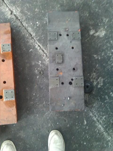

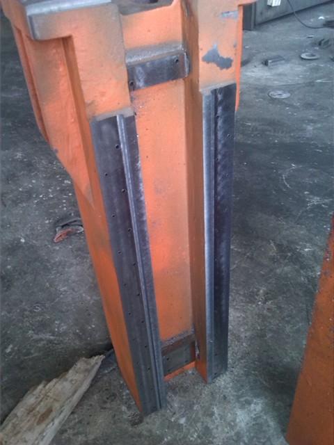

« Reply #6 on: April 22, 2013, 12:29:37 AM »
 :beer:HI  Phil
    X  395   Y 330   Z  445

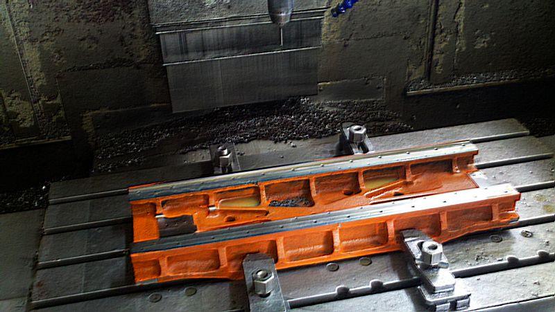

 Casting I will place one year,Let them fully deformation.Then I cut processing
If you need the drawings,Please inform me your email address

« Reply #8 on: April 22, 2013, 03:18:04 AM »
Hi hao xiaoquan,
That's a very useful sized machine.  :thumbup:
How old are the castings now? - I don't want to have to wait another year for the next update!

Hi hao xiaoquan,
   Nice project!  Are you planning about producing these in series?  They'd be a sweet new competitor to the existing Sieg KX3/BF20/Syil X4 of this world.
   I've done a little math, and you literally leave them in the dust, speaking of size:  the workable volume of a KX3 being about 9 cubic decimeter (0.3 cu ft), a syil X4 around 14 cubic decimeter (.5 cu ft), and yours around 58 cubic decimeter (2 cu ft!!!)   :clap:
   The column seems sturdy, and the headstock seems heavy; two qualities for a nice machine.
   I'd say keep us informed of future developments!

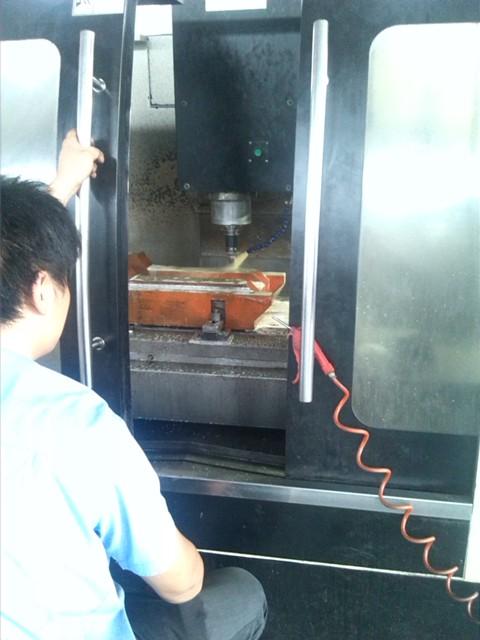

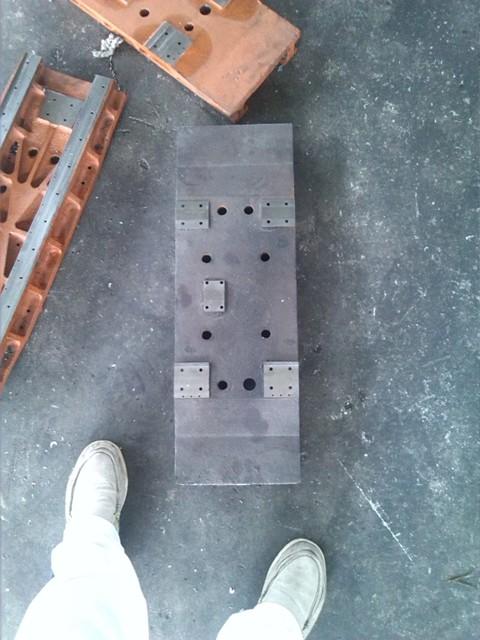

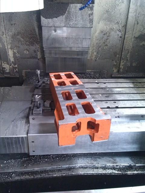

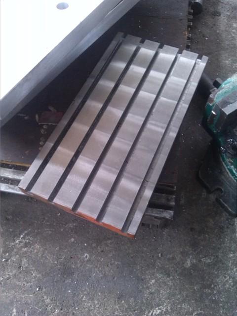

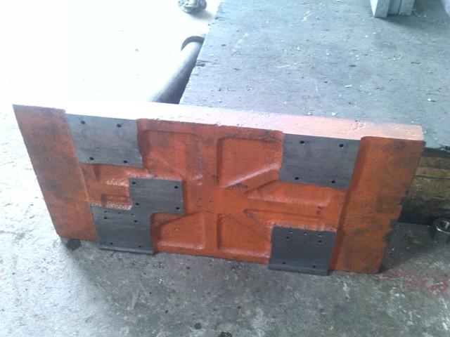

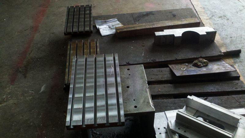

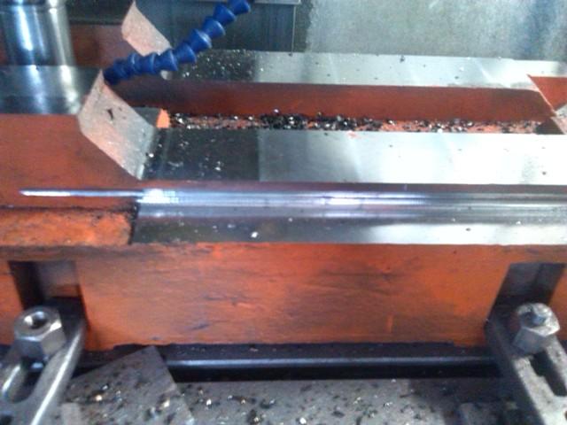

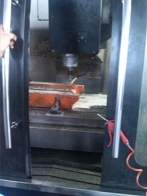

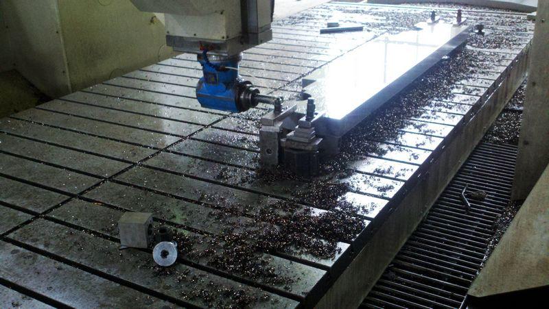

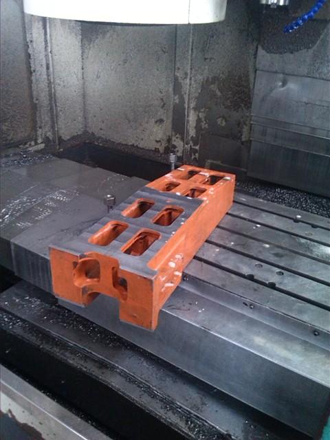

     I'm processing machine tool castings.

Really nice looking parts. Plenty of ribbing and looks solid. Would love to have kit of those parts either cast or (rough) machined to plus tolerances.

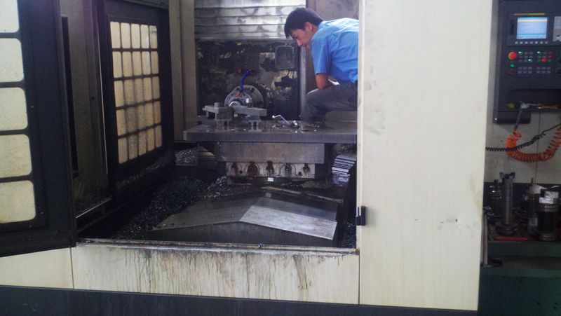

Hi Haoxiaoquan,
Are you going to scrape in the interface surfaces, or leave them as machined?
Must be nice designing stuff when you have access to a foundry and CNC machinshop like that.
Keep the photos flowing.
