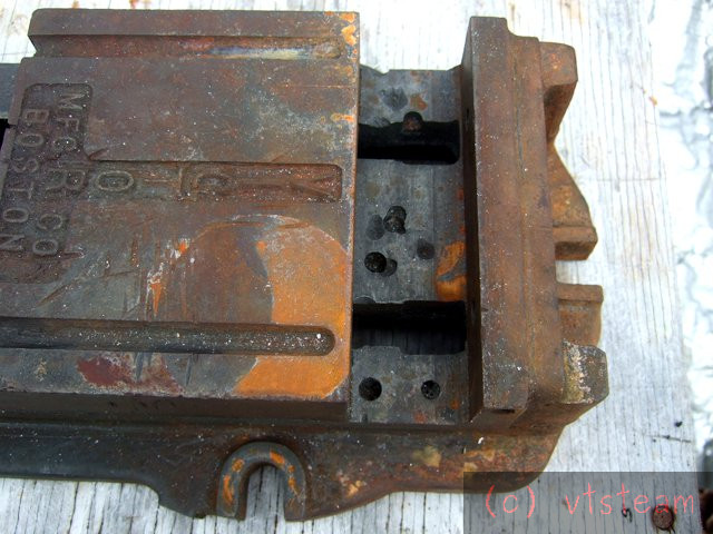

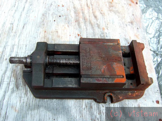

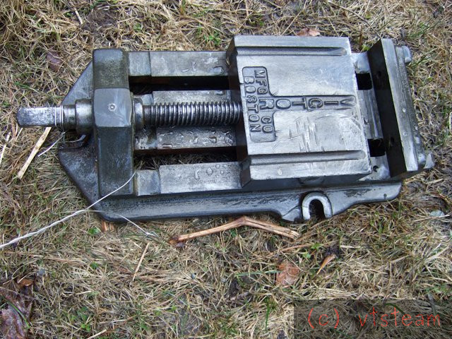

I was given this mill vice with the second hand mill/drill I bought a couple years ago. Scraped some of the crud off and read "Victor Boston" There was no handle, and no jaws.
Some divots, too.

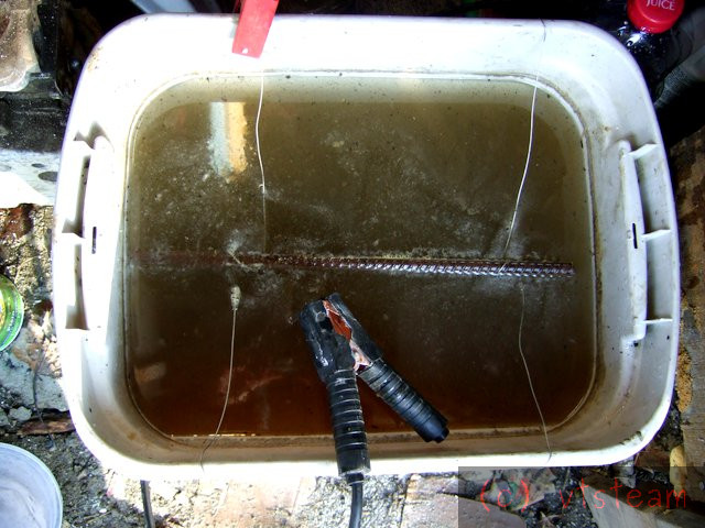

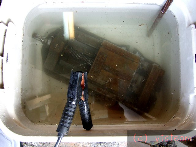

I read Darren's thread about electrolytic rust removal, so I figured I'd give it a shot. Bought some Arm and Hammer washing soda (sodium carbonate) and put a half cup of it in some water.
Used a piece of 1/2" rebar as a positive electrode, and wrapped a piece of steel wire around the vice to attach to the negative electrode.

Connected my auto battery charger and watched the bubbles start to form. Best position for the positive electrode seemed to be parallel with the vice and directly over it. The action does seem to be somewhat directional.
« Last Edit: January 07, 2018, 04:53:08 PM by vtsteam »

I checked back in a couple of hours. I couldn't see anything in the brown water, so I just pulled it out and hosed it off.
Here's what it looked like!  :ddb:

Lots of ways to skin a cat -- I like the washing soda electrolytic method having just tried it. I've also seen sodium bicarbonate (baking soda) used, though it's more expensive, it's even more widely available and still cheap enough.
What I used, was sodium carbonate -- available everywhere at supermarkets --used for clothes washing, and the cost was 15 cents for this tub full of solution -- which can be re-used. In fact I have a big old dividing head that needs to be restored, and that will be next in the tub, plus a bunch of other rusted odds and ends. But chemical methods like citric acid seem good, too, if you have it. Whatever works!
re. explosive gasses and safety -- Charging an auto battery (with the same charger) also liberates oxygen and hydrogen, and in this case I was drawing less than an amp, so the gas evolution (charge) rate was low compared to an open lead acid cell.
I kept the shed door open, and the tub in the open doorway itself, so essentially it was outdoors. (the shed used is unfortunately "ventilated" in the extreme, even when closed!) I also didn't leave it unattended or over night. I checked it periodically, had it on a 2 hour timer on the charger, and that's how long it took to clean up. I always turn off a charger before removing battery clamps from a battery -- learned that one when I was 19 the hard way -- and I did the same for this.
Just including the above in case someone else decides to try it as well.

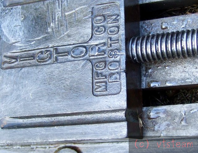

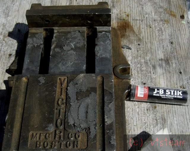

I decided to fill the divots with metal filled epoxy putty -- JB Stick. I've had good luck with it on cast iron in the past. It cures very fast -- about 2 minutes working time after kneading it together. I use rubber gloves and it's important to wet them with water, or this stuff will pull them off. Also you can't easily putty knife it. Best bet is just press it in place.
« Last Edit: January 07, 2018, 04:55:04 PM by vtsteam »
  • Posts: 6940
Re: Fixing up an old milling vice
« Reply #19 on: April 16, 2013, 03:49:01 PM »

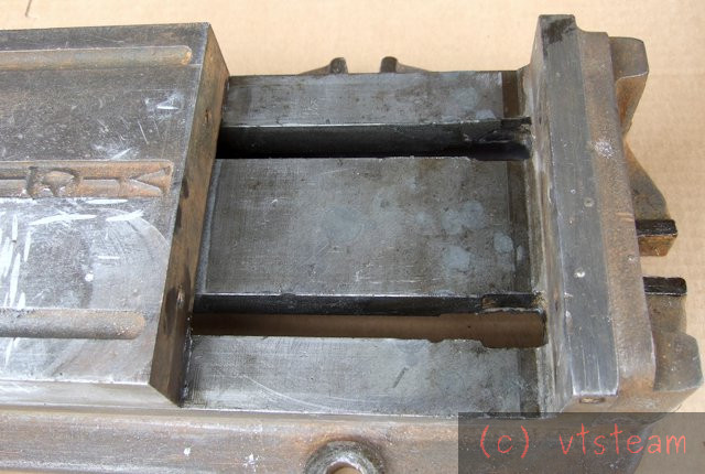

After it had cured for a half hour, I filed the epoxy down with a coarse file. Then I hit the ways with some petroleum jelly, and a few other areas I wanted to mask as well. The drill divots on the ways looked pretty good after filling with epoxy and oiling. The bare epoxy can be seen in some cuts on top of the vice slide.
« Last Edit: January 07, 2018, 04:55:56 PM by vtsteam »

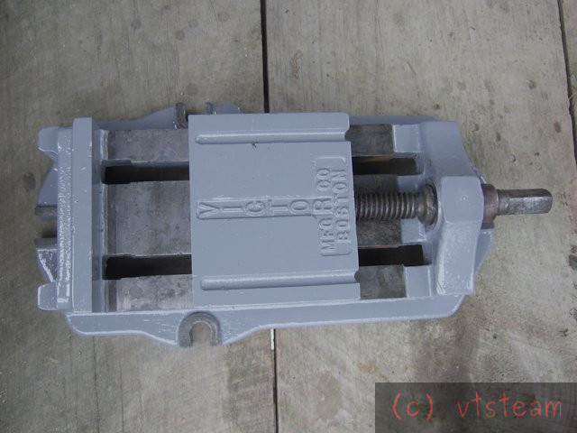

We have predictions for rain for the next few days so I was anxious to get a coat of paint on before then. In fact there were a few drops while I was painting, so I quickly moved it to the porch while still wet. Good to have it protected now that it has been stripped!
« Last Edit: January 07, 2018, 04:56:36 PM by vtsteam »

         Looks well now it's got a coat of paint. Do you have to make a new jaw for it?
                                      Cheers   avid

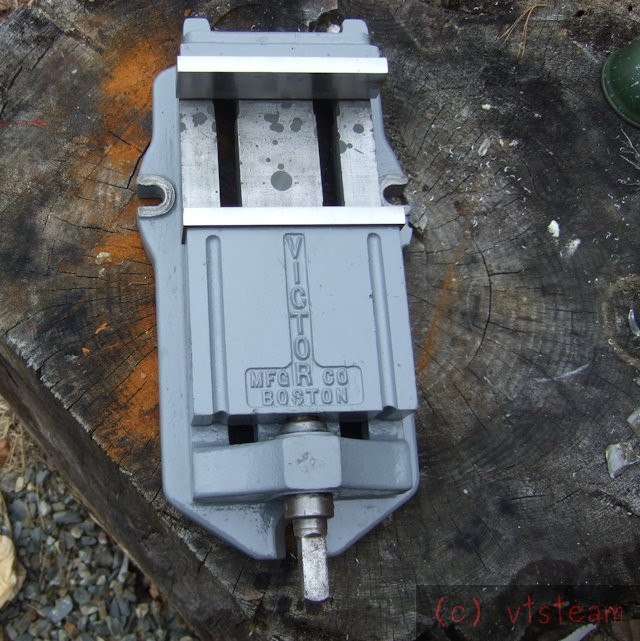

Made some jaws this afternoon and trued them up on the mill. Handle left to do.....
« Last Edit: January 07, 2018, 04:57:22 PM by vtsteam »

That vise is heavy -- not sure what it weighs but should be good and stable. I used it today on the milling machine. Still thinking about the handle and how I'm going to do it.
Now it's making the mill look kind of shabby. Guess that will be another project.....

Thanks Davo. The stationary jaws do bolt on from the back. I tapped the jaw holes, ran the bolts in, and then milled a skim off the whole jaw face so the bolt ends are flush.
The moving jaws have countersunk flat head bolts that pass into tapped holes in the moving block.
All jaw faces were milled at one go, in place, with the vise bolted square to the mill bed. I should probably put some dowels in.
The JB epoxy putty I used is good stuff for filling casting imperfections, but it isn't what we refer to as JB Weld usually, though made by the same company. The putty is not described as "structural". But it's a lot better than Bondo.
Regular JB Weld is a two part metal filled epoxy that comes in tubes, like most epoxies. It has a slow (overnight) cure. It is extremely tough stuff, a structural epoxy with a high temperature rating -- 600F,  believe. By comparison most common epoxies are softened at about 200F.
JB Weld is legendary (or infamous) in the old tractor world, depending on whether you are a farmer or a museum quality restorer!
Case in point: I have a 1951 John Deere Model M tractor that is worked hard. When I got it I noticed that the front axle pivot pin had worn an egg shaped hole in the front casting. There was no bushing. Just a hole in the casting. Probably worn through decades before. I could not replace the large frame casting, but replaced the rubber supported bushings in the floating axle support tube behind it and  filled in the casting ellipse with JB Weld and drilled it circular to correct dimensions.
The pin is not supposed to rotate in that hole, although it had in the past because the other bushings were shot. So there is no frictional wear normally. But the full weight of the tractor front end is on it, and it gets hammered. That repair has lasted ten years since then with near daily use on rough terrain -- log hauling, etc. -- with no sign of wear of cracking.
So anyway, JB Weld is a good product for cast iron repair where other methods are not available or practical. In my experience, anyway.
