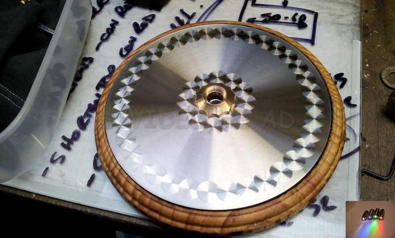

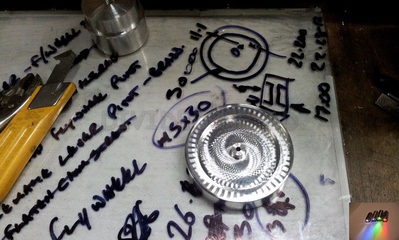

I was trying to think of a design for my flywheel and stumbled on the design for the base instead  :Lol:  Just the way the mind works!
So, I was gifted a few stainless circles by a generous fella last time I visited   :thumbup:
I was thinking of using a 6mm thick disc but the lever would stick out and that just wouldn't do. So I selected one of the larger 3mm thick discs that would allow the lever to lie within the diameter  :)
I mounted it on an arbour and cleaned it up using emery and a little polish... This stuff is tough!! No pic's cause it was quick and basic (and I forgot!)
I decided to have another go at engine turning, last time I tried was on my MkII finger engine. It was ok but some swirls dragged a bit.
Anyway, enough talk more pic's eh   :headbang:
I used the rotary table to hold the disc on an arbour and used 30' for the inner circle and 10' for the outer. I had to go over them twice to get the full circle cause the stainless is so hard. Took a while but I like the result  :)

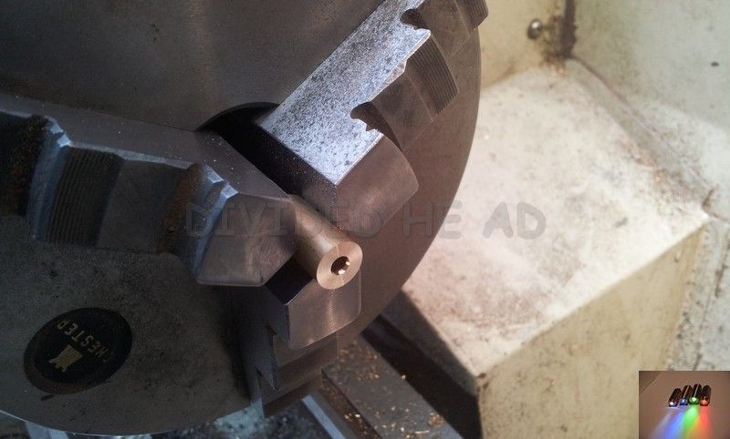

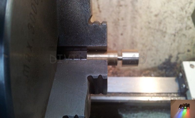

Then I needed a cover for the bit left in the centre where the washer was. I used an old little brass flywheel blank from the bits draw.
I drilled it to allow the M10 thread to pass through. Then turned a spigot to locate it in the base disc.
Then turned it around and bored the recess for the column to fit into.

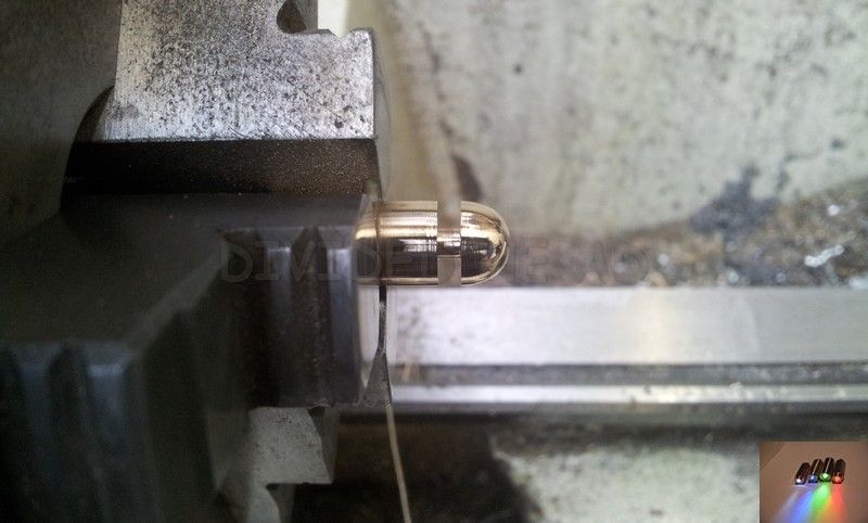

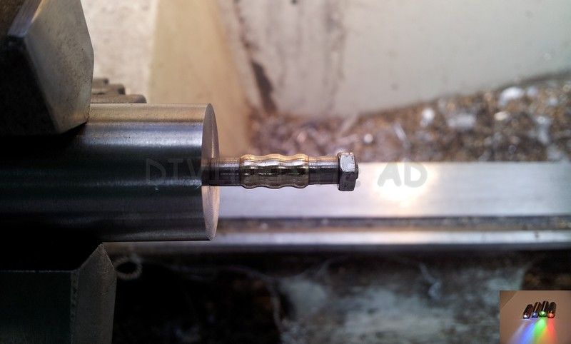

I needed a way to hold this for shaping so I turned the hex off a M10 bolt and cut a slot in it so I could tighten it.
Then began shaping the part.
Then I added the fancy bit to it  ;D
So this is where I ended up at about 10PM

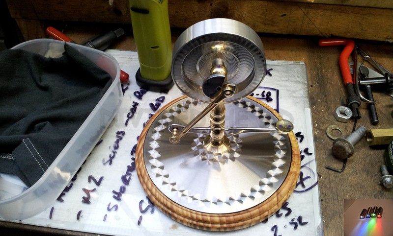

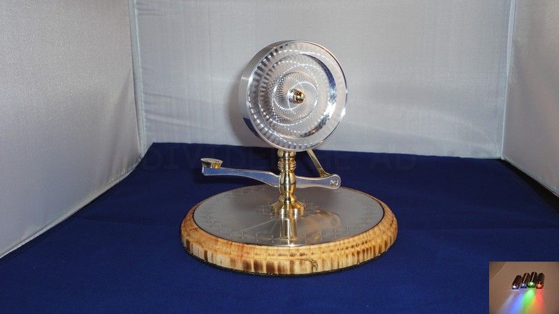

« Reply #17 on: May 28, 2013, 08:31:08 PM »
Evening folks,
I've been able to get a few hours together and pretty much finish this project... I know, in less than a year! (Some people will know I have a few unfinished projects    :palm:  )
So, I left this waiting for a flywheel, a base and some little fixings.
Here are a few pic's of what I came up with....

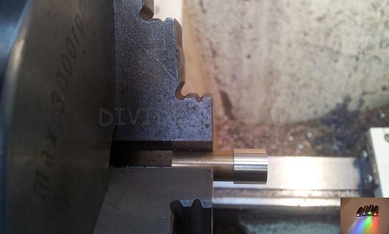

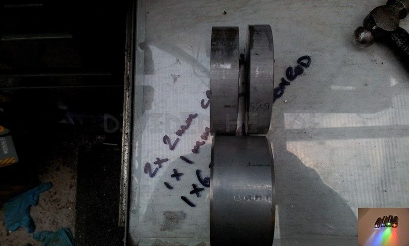

First cut a 3"x1.5"  ali round into two... By hand!   :bang:  Wouldn't clamp in my chop saw.  Finished them both off then started work on the 3/4" thick piece.

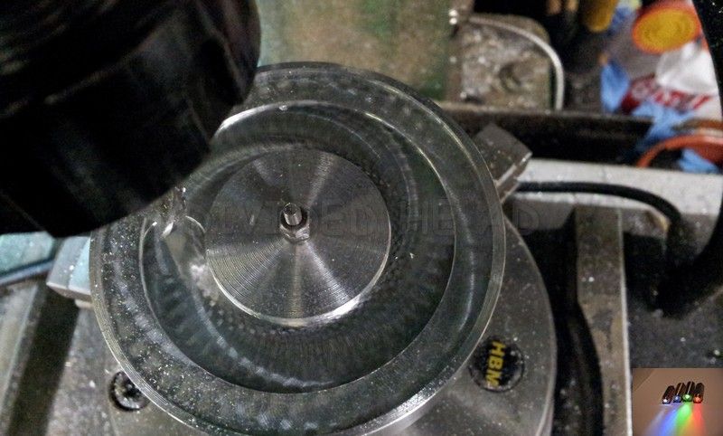

Now, the idea was to use the mill and rotary table to remove the material from the centre of the flywheel before cutting spokes into it... Problem with that was.... I liked the pattern the machining left behind :)
I had to make quite a few little arbours and work holding bits for this as there were a lot of fiddly bits to make...
The Base is in 3 parts. The stainless ET platform and collar for the upright you have seen already. But it needed a thicker part underneath the stainless for the upright to screw into... Wood seemed a good option for this.

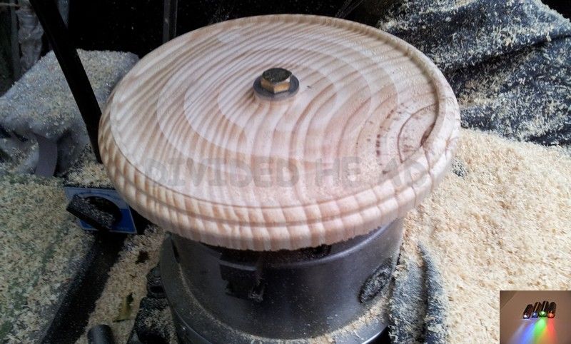

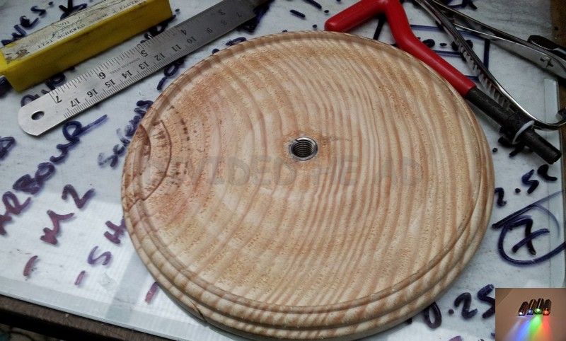

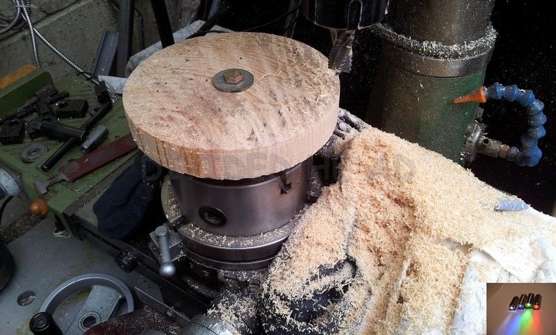

I only had one piece of wood big enough for the job. A bit soft but workable (dunno what it is?)
Cut into a rough shape and then a centre hole drilled and mounted on the RT on the mill... and hacked into a shape to work with.
Taking shape... The little hub in the centre was removed after all the shaping and sanding was complete... carefully by hand with a razor sharp chisel.
I then helicoiled the centre hole to accept a M10x1.5 thread.
Mounted it on the lathe and sanded it down, scorched it a little with a blow torch and then waxed it.... Placed the other parts on and... One completed base.

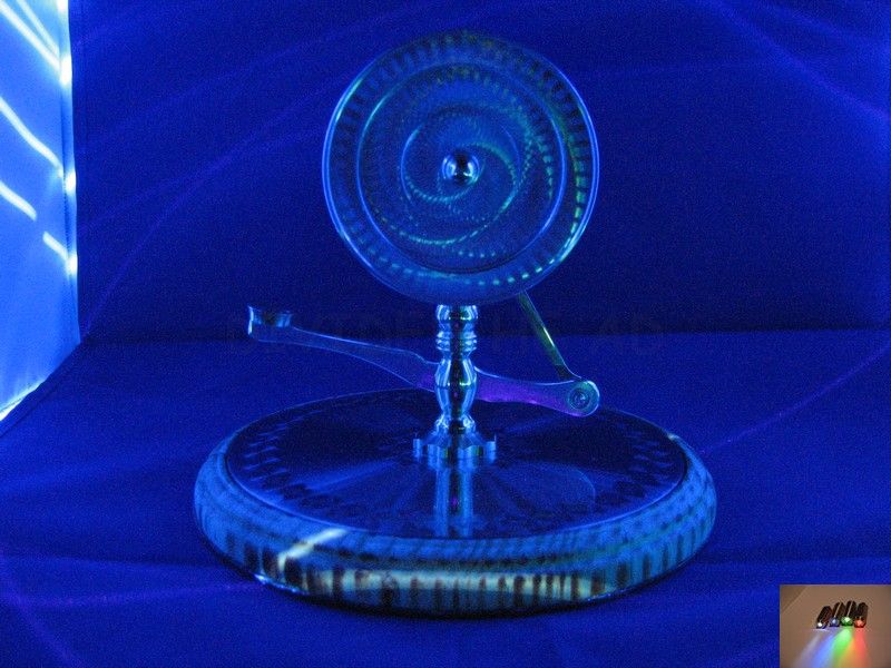

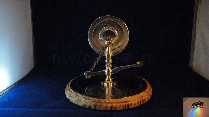

Then add the assembled "engine"

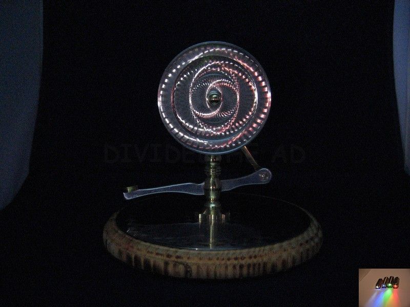

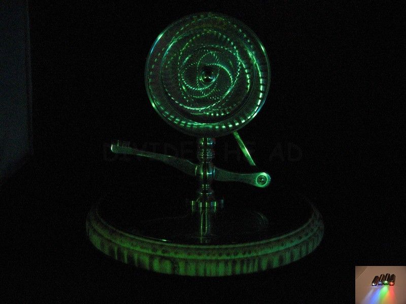

I had a play with some artsi fartsi shots too...
Using 2 GID blobs charged up to do the light painting (10 second shutter delay in the pitch black except for the GID bits)
Then I started waving around the laser I used to charge the GID bits up!   :headbang:
Anyway.... I suppose I'd best show this too "And Action!"   :ddb:

Superb as usual; question.. how did you do the 'engine turning' swirls? that has always confused me, did you use tied wire brushes or emery sticks, I have tried using wrapped emery cloth many moons ago but never came out anywhere near as good as yours, ..would love to know the definitive secret..?

Alan, I couldn't bring myself to destroy the cool swirls left by the mill   :borg:   Not often I leave tool marks :dremel:
George, I use some soft abrasive rubber cylinders mounted on 1/8th shafts that were donated to my cause By John "Bogstandard" about 3 years ago. He was given them by another friend.
From what I have gleaned over the years a few people use things as simple as wooden dowels and an abrasive paste. Like valve grinding paste for hard metals and even toothpaste I've been told on softer stuff.
Also the old erasers found in the top of pencils seem to come up when talking ET.
The use of a lubricant is I believe a necessity.

Ralph
excellent job all round. Smashing in my book.
I love stainless, i love the way you can machine it to look like glass if you have the right conditions.
Any chance of showing the arbor, disc and medium you used on the engine turning? also what speed was used and any other tips you may want to pass along on getting  that effect.
Thanks    Anthony.
