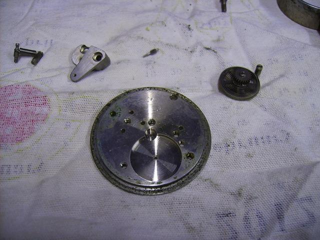

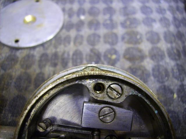

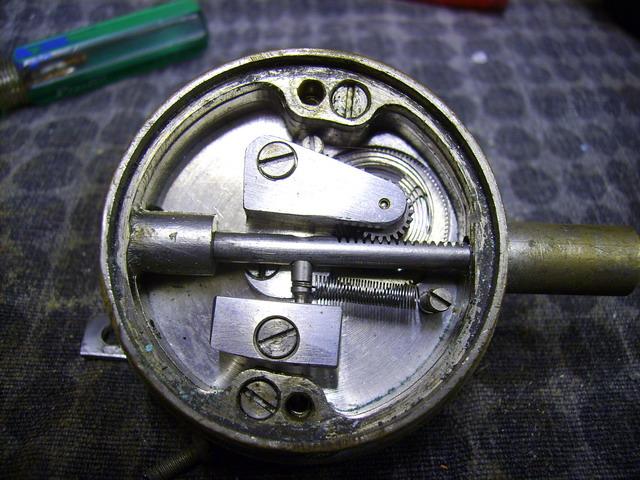

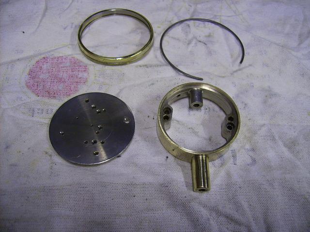

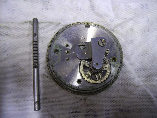

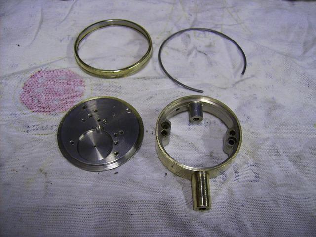

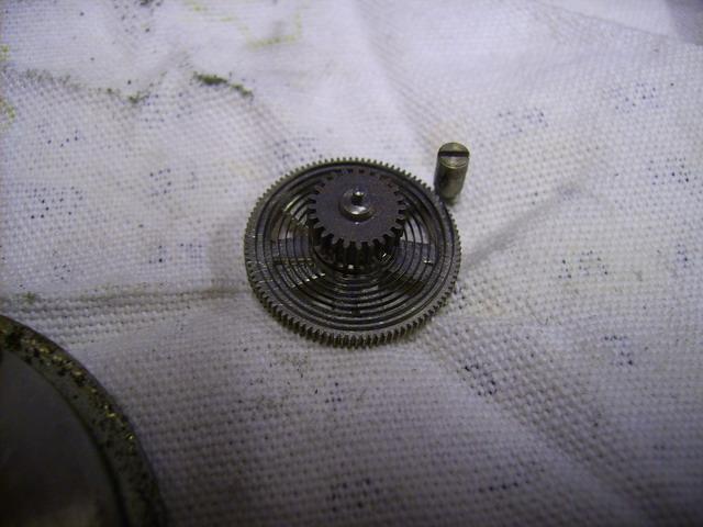

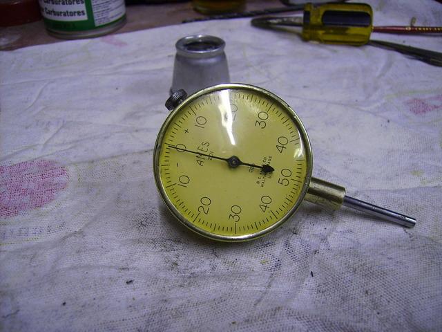

hi all i got this on sunday it just needed my loving touch in all it is OK a part from the mane shaft so it got striped dawn in pic 3 you will see the notch cut out in the bezel to remove the retaining ring once this was out it all came a part with ease and all was given a good scrub up

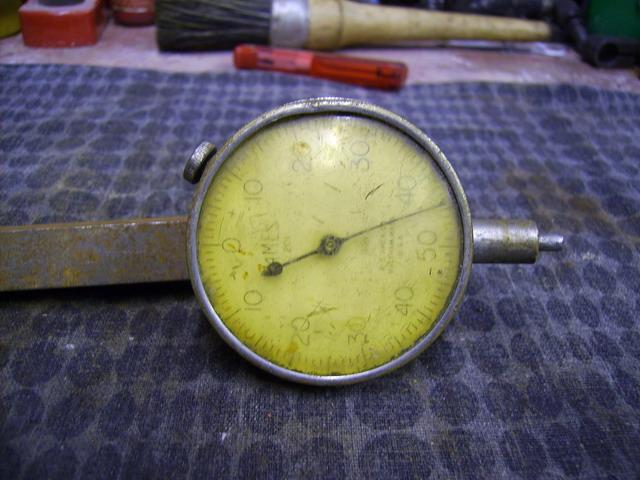

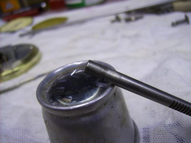

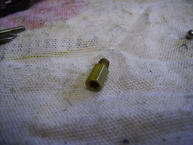

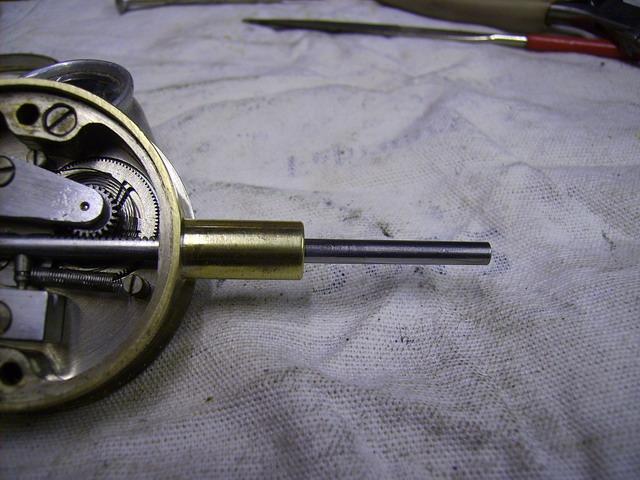

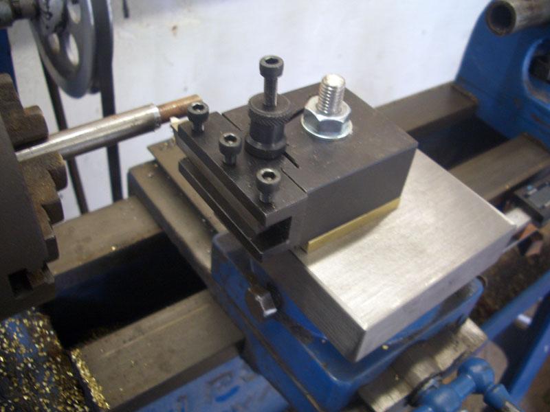

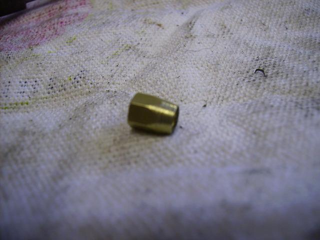

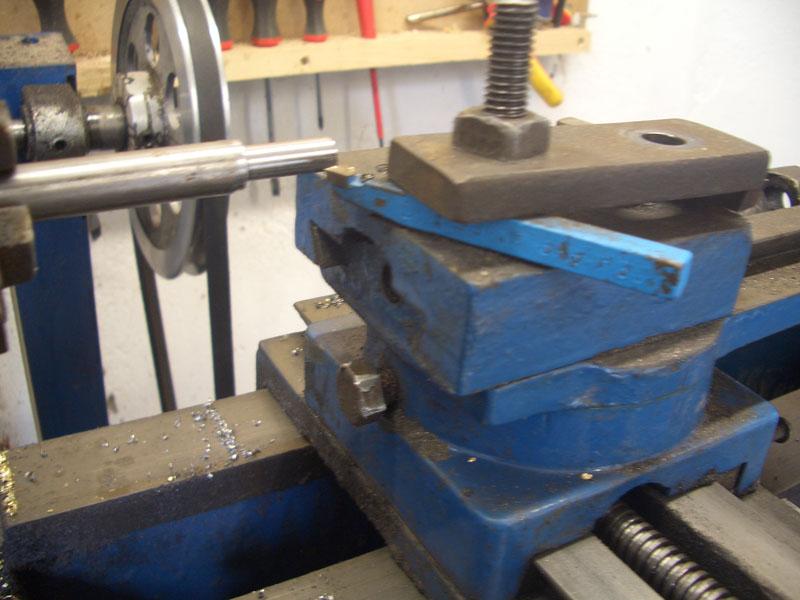

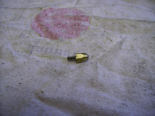

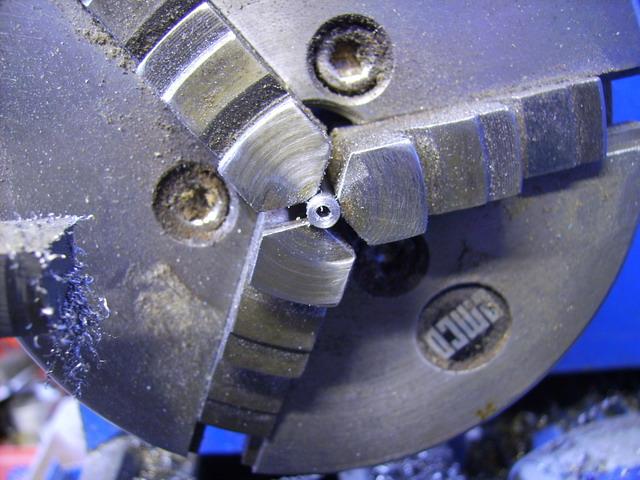

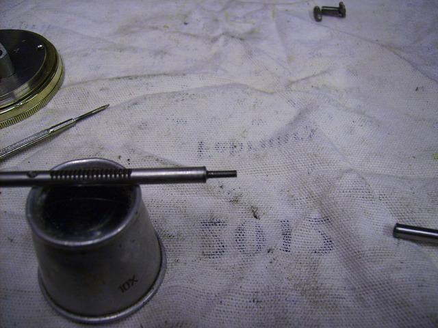

hi well last bit  it needed the push rod sorting out as the old one was bent at the end i cut the rod well past the damige and drilld 1.6mm and tapt it m2 i then got a lenth of silver steel with a od of 5mm this was just a bit biger than the origanal by me mike the origenel one was 4.7mm but the hole that the rod runs in was worn so i reemd it out to 5mm i made the lenthe of the silver steel 60mm long i then drilld 1.6mm in both ends and tapt m2 then with sum m2 studing and bering fit i put the two together i then had to make the end this was moad out of a stand off out of a computer i drilld the end to take a 3.5 ball and drilld all the way thruw 1.6mm and tapt m2 i then mixt sum epoxy up and fild the voyd and prest in the ball i then put a lenth of m2 studing in and left it to go hard gave it a buff up anf fited it right pics

krv3000, you ought to repair new stuff, since what you repair looks better than it started out!

Great piece of re-cycling again Bob, have yet to tackle mine, but learning more and more from your postings, on how to take them apart, many thanks.
