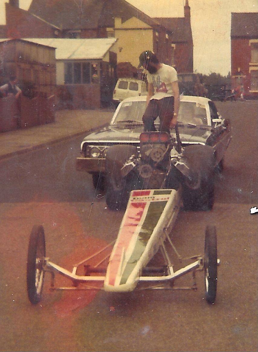

Very nice  :thumbup: Santa Pod stuff !!! been there, done that. This was my effort 40 years ago. That is a 30 odd year old me about to show off in the local carnival.
Cheers Dek. :med:

ooo thats nice its a shame jhon dus not have his any more you cud of had a race

 Dek , they are some class photos , that looks some machine you had  :clap:

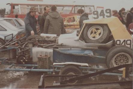

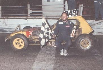

Back to the modding. Photos of my B.R.IS.C.A F11 stock car 1983 - 1992. Strange name as the only stock item is the driver. Photo 1 a bad day p2 not all day are bad. I had hair then. :mmr:
