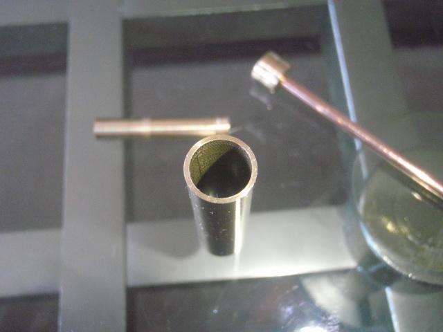

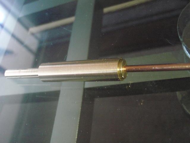

Hi again,
I joined this forum a couple of weeks ago having just bought my lathe but with work and traveling have only just got it set up. Now bolted to a bench in the utility hall I can start on some practice pieces, my first effort a piston and barrel assembly of no particular design but turned out better than expected given this is my first attempt. Will post my results as they are produced and critical advice welcome.
Cheers Mick

Looks like the start of something interesting?  Can now become part of something else   :poke:
Fun making bits from nothing innit Mick?  :dremel:   :)

Hi Mick,
We all start somewhere. Looks like you are off to a good start. Just watch the swarf on the floor...  :lol:

Well you've got 3 bits made already Mick, Soon have the rest done  :)
Have you got any engine plans sorted?  I can dig out some links if you like? lots to look through :coffee:

Hi Mick ,,,,,,,, well your off the starting blocks  :thumbup:  as others have said we ALL had to start  somewhere ,the more you use your lathe the easier things will become  :dremel:
What lathe tooling were you using on the brass ?

Brass and copper are not the easiest things to turn without digging the tool in, so well done for getting those parts made.

Nicely done Mick!
Just making things to fit other things, is great practice, for when you know what you need to make, to fit what you've made.....   :D
It's great to see you progressing!  :thumbup:

Nice work  :beer:
What you've made so far looks very much like most of a pump centre - telescopic with a spring in the cylinder, pointed centre on each end - for centring a centre-punch mark in the 4-jaw chuck. One end runs in the punch mark in the work, the other in a punch mark on the toolpost, adjust until the pump centre shows no runout on an indicator, then you have centred the work in the chuck  :thumbup:
It's a good first project for a new lathe, and a tool you'll use all the time - and you've almost finished it already!
