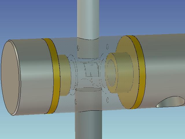

I am making the part as shown in a CAD rendering below.
Everything is done and nice and tight, the bronze bearings are fitted and I put a reamer through them while they were mounted. Everything looks like it is ok.
The only trouble is, the shaft is a very tight fit with the bearings. I can get it on a little but not all the way and also 1 bearing has a slightly smaller inner diameter apparently as the shaft will only go in for about 5 mm and then it is jammed.
Now I want to lap the shaft and the bearings to a good fit. I always thought I knew about lapping but now the practicalities of it are giving me some trouble.
Do I lap with the proper shaft? Or do I make a new shaft only for lapping? I tried to help it along with some sandpaper (fine) wrapped around a stick on the lathe (yes, ways are protected) but that doesn't seem to do much. Maybe it was too loose.
Anyway, any suggestions, practical advice and gotcha's out there?
Oh yes, this is what I am making.

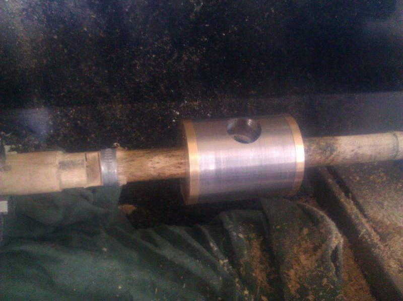

I made a wooden lapping rod. This is a rod cut lengthwise with an angled cut.
So by moving the top part to the left I increase the height of the rod.
All I need to do now is find the right lapping compound and I can go to work. I need to remove next to nothing in the bronze bearings so it should go fairly quickly.
Thanks for all the help.

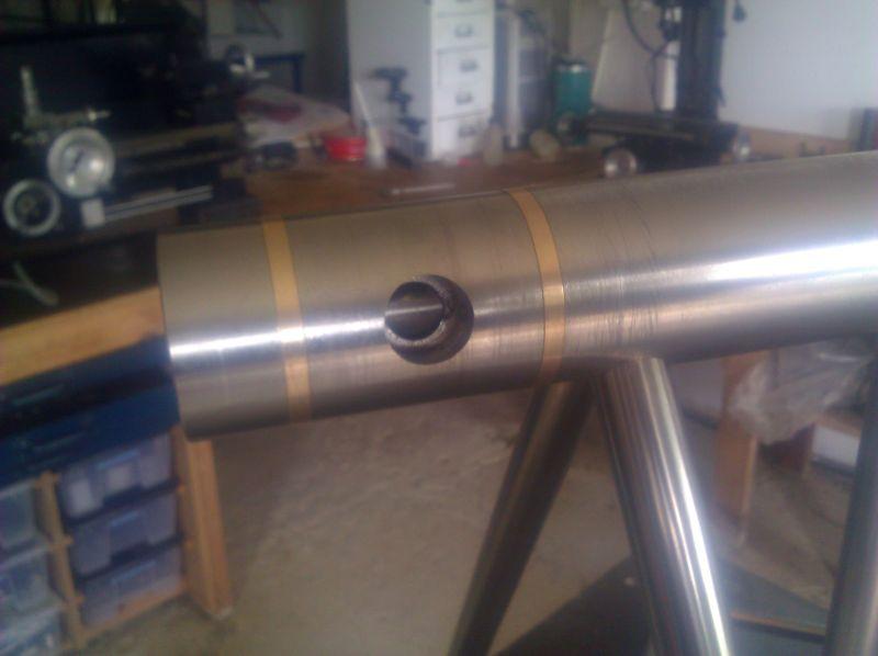

Thanks to all your comments, the bearings are now lapped.

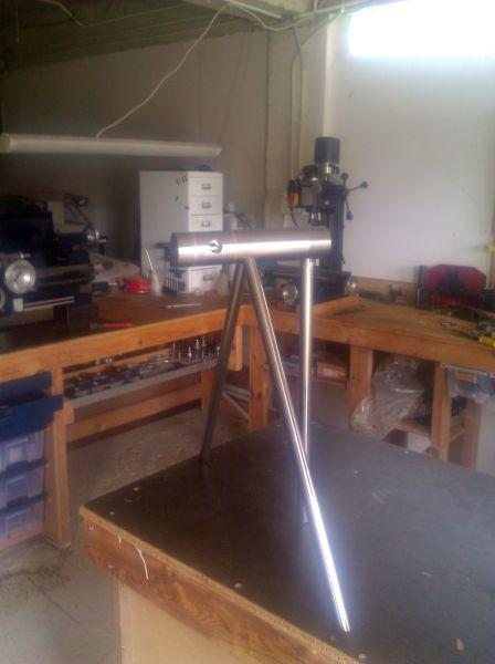

I suddenly remembered that I had a pot of Aluminium Oxide powder, for my airbrush sandblaster. So I oiled the wood, sprinkled some powder on and presto, one lapped part.
Oh wait, I will go to the workshop and take a picture. Least I can do for all the help I have been getting.
The part is now fitted and it has a nice smooth action. After I replace the oil with a thinner one, it will be perfect.
Yes I know, the surface is not great yet, that will be done later.
This is the part in place. I also added an overview to show you the whole thing.
Lykle
