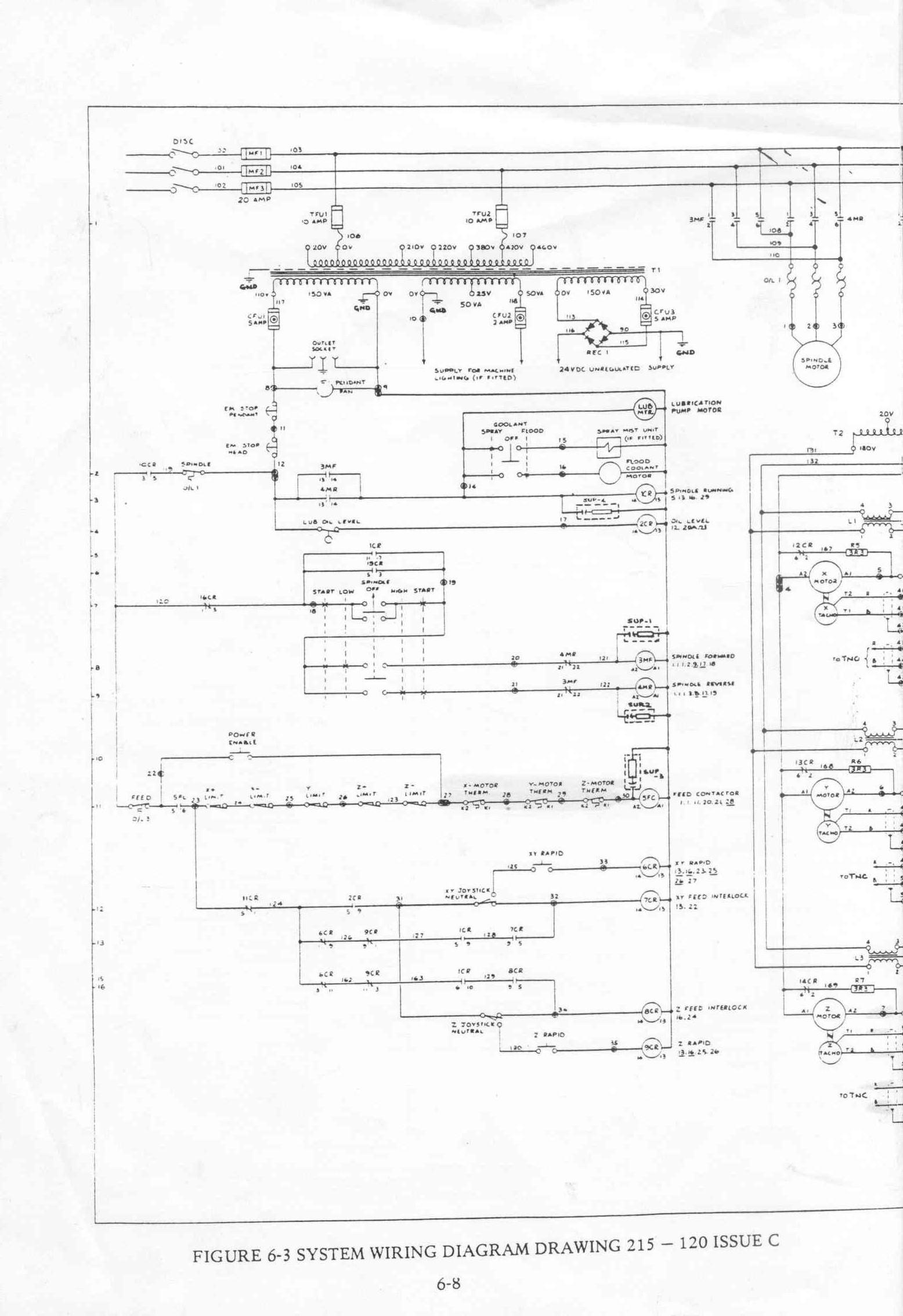

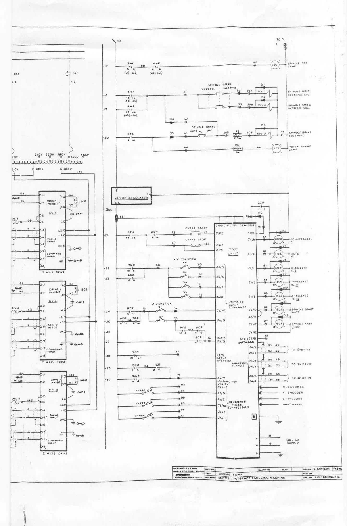

AdeV I can't imagine the 400mV will be the problem. IIRC there are two 24v DC power supplies on the interact - one is the regulator board we talked about, and the other is an unregulated supply of just a bridge rectifier and capacitor. Maybe it's the other one that's u/s
The following .jpgs are the circuit diagram, and they are shown on them.
NB These are uploaded full size otherwise you couldn't read them !!!!

Ta kindly, I have those diagrams, mine is subtly different (24v unregulated feed comes on wire no. 100, not 116 as shown in yours (but 100 as shown in mine)...
Having traced the 24v regulator circuit, it's extremely odd, doesn't look like any regulator circuit I've ever seen before. However, now I know its feed is already rectified, maybe that makes it more sensible.
The chip that cme off it has TIP32A as its designation - that is an NPN power transistor, not a voltage regulator... I'm wondering if I can substitute the whole rectifier board with simply a capacitor & vreg, instead of the weirdness it has now.
Oh, and since I wired the vreg in place of the TIP32, I got 41v DC for a few seconds, then 0v. So now I need to find the fuse that blew...

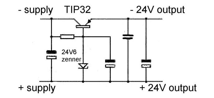

what does the 24V regulator board look like ?     a picture would help
just a very simple voltage regulator  with a resistor , 25V zenner and the TIP32 as a emitter follower ?
if it also limits the maximum current output your likely to find 3 or 4 small transistors and a power resistor to sense the current ( 0.3 to 1 ohm ?)
what voltage regulator did you use a 1A  7824 regulator IC    ?

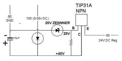

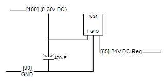

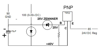

OK, the rectifier regulator circuit, as per Bridgeport, is below.
Below that, is my proposed replacement circuit.
Do I need to add further decoupling caps, as are often shown, near the 7824 device?
Lines 100 & 90 are from either end of the bridge rectifier. 90 is also tied to GND in several places. 100 is the direct supply. The transformer is supposed to be giving 30v, I guess that 1.4v would be lost to the bridge rectifier? (or just 0.7v?), so there should still be plenty left to run the regulator.

« Reply #8 on: March 23, 2013, 02:17:29 PM »
Hi Ade ,
just a quick question
what is the off load voltage out of the transformer T1's 30 V winding ( terminals 113 & 114) ?
if the output is more than 28Vac
then 7824's maximum input voltage of 40Vdc will be a problem to workaround
http://docs-europe.electrocomponents.com/webdocs/0609/0900766b806090e4.pdf
a circuit like the simple regulator in my last post can be used as a pre regulator
to limit the DC voltage into the 7824 ic
the 0.1uF decoupling capacitors on the 78xx data sheets are needed for stable operation of the regulator

****  PPS note the circuit will not work with a PNP transistor like TIP32
you must use a NPN transistor like the TIP31       *******

Re: Bridgeport Interact II failure
« Reply #17 on: March 23, 2013, 05:15:10 PM »
Hi Ade
yes
the TIP31A is a NPN transistor
http://www.st.com/web/en/resource/technical/document/datasheet/CD00104631.pdf
the polarity of the circuit will be reversed
***** update circuit using TIP31A added  *****
« Last Edit: March 24, 2013, 02:12:45 PM by John Swift »

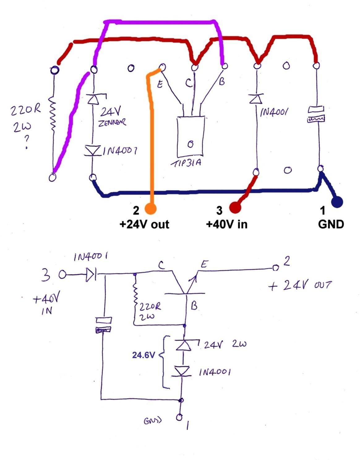

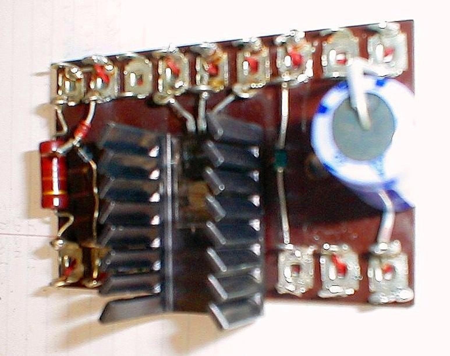

« Reply #19 on: March 24, 2013, 12:43:31 PM »
Hi Ade,
I've had a quick web search for the bridgeport 24V regulator
the only result was a picture of some components mounted on some tag board
using your first circuit and the tag board picture to come up with the picture below
( note -  the wiring between the tags is my guess )
not sure why I could not upload 2nd picture as jpeg - see pdf
« Last Edit: March 24, 2013, 02:20:16 PM by John Swift »

In fact rather like my description of your circuit in words a few posts ago! thus :
"I wouldn't mind betting that the TIP32A is being used in an emitter follower configuration withe the collector being the input, the emitter being the output, and a zener diode from it's base to common 0v, with probably a bias resistor from the top of the zener to +ve. The idea is that the emitter will follow the voltage on the base but offset by 0.6 - 0.7v which is the Vbe drop of a silicon transistor."
I have a vague recollection that the regulator on my late lamented Interact was mounted on tag strip.

« Reply #21 on: March 24, 2013, 01:32:39 PM »
we have come full circle !
If Ade can let us know the value of the resistor , capacitor and part numbers for the diodes
I'll amend the circuit and if Ade wants to get parts in a hurry ,
possible alternatives from Maplins limited range
( just looked and they sell the TIP31C and BZV85 1.3 Watt zenners both 12V &24V versions
depending on the resistor you may need  two BZV85C12V in series will give you a 24V 2.6W zenner )
RS components sell the 78S24   24V 2A   IC regulator but the maximum input of 40V
could be exceeded without a preregulator!

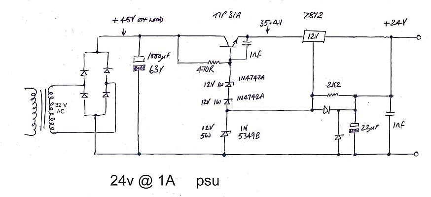

as an  example the circuit below is  for a   commercial 1A 24V supply
the simplest solution is to rebuild the original 24V regulator
« Last Edit: March 24, 2013, 02:02:27 PM by John Swift »
« Reply #23 on: March 24, 2013, 02:12:04 PM »
Andrew - yep, the 24v regulator is on a piece of tag board. I notice there are a few circuits on this size/style board dotted around the machine...
John,
The components are as follows, connected top-bottom or as described:
Capacitor: 470uF, 63v electrolytic, negative to top strip.
Empty tag pair
Mystery diode (signal diode I think), looks like "4002" printed on it. -ve end down.
TIP31A base (bottom tag only)
TIP31A collector (bottom tag only)
TIP31A emitter (bottom tag only)
Empty & unused tag pair
Zener diode BZX61C24, -ve end faces down
Resistor, 820 ohm (confirmed with multimeter)
The top left 3 tags have GND, +24V, and INPUT from bridge rectifier (pins 2,3,1 on the schematic Andrew posted).
Andrew: I've had the unit functioning, but it kept cutting out (stating "Emergency Stop"), which I hope is due simply to the 7824's not delivering sufficient current.  I was obviously overvolting them as well, as the output voltage was beginning to drift downwards away from 24v...
Edit: Please note the wire link between the -ve end of the Zener & the resistor... that is original

That'll be a 1N4002 which is a 70v piv 1 amp diode. The output (emitter) is tied to the base less 0.6v Vbe drop, so they are putting another diode in series with the 24v diode to make (effectively) a 24.6v zener to give 24v output!
« Reply #25 on: March 24, 2013, 02:45:08 PM »
Right, scratching my head a bit now, I rebuilt the circuit according to John's diagram (minus the reversed diode behind the Zener, which isn't on my board); I get 0v & a hot resistor...
This is on my test bench, I am feeding it anything from 0-35v, 0-2A...
If I give it less than 24v, the resistor stays cool. Above 24v, it gets hot.
This _has_ to be nearly what I had before....
I have a spare N4002(ish) if adding the reverse diode will make it work...

The resistor should drop your input voltage minus 24.6. (=DeltaV) So using ohms law you can calculate what current it draws (DeltaV/R) And what power it dissipates (I squared x R) Is that less than or greater than the assumed 2 watt power rating? Is your TIP31 ok or is it blown up?
« Reply #27 on: March 24, 2013, 02:57:57 PM »
It _should_ be OK, it wasn't in the circuit when I saw 41v, and whilst the whole thing was giving out 26.4v when I removed it, that's more or less within limits...
I tried adding the reverse diode: Nada.

the  revised picture with the component values added

Hrmph, looks like I've toasted the TIP31A. Time to order a new one....

Hi Ade ,
looking at the regulator circuit again
with 16V dropped across the 820 Ohm resistor
the current through the resistor is 16/820 = 0.0195 A  = 19.5 mA
if about half of this current  passes into the base of the TIP31A ,
( with the minimum current gain of 25 )
the maximum current that can be taken by the TNC control will be about 250 mA    (1/4 A)
before the output voltage starts to drop
with a little more current diverted from the 24V zenner and  a transistor with a current gain nearer to the maximum of 50
  you may be able to take around 700 mA  provided the heatsink is big enough
with too small a current through the zenner diode the regulation will be affected
using a 6 watt 100 ohm resistor as a load
you could test the repaired regulator  before its fitted  in the machine

Woohoo! We are back in running order! Turns out the Zener was toast (probably, might have been the TIP31A as well); fortunately I bought enough parts to build a whole new regulator (er, or two) if needs be, so normality is now resumed.
Phew!
