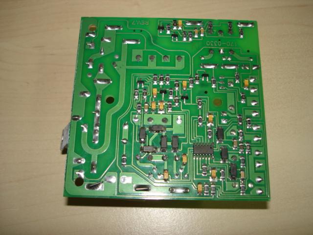

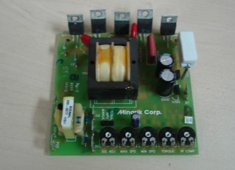

Here is a picture of the controller taken off it's heat sink.  There are two SCR's and three diodes in the middle of them. (I'm pretty sure they are diodes as they are labeled D506, D507 and D508 and only have two wires, but looking at it closer I see they use to have three wires and one wire was clipped off.) They say 071-0039 on them and a D2, but that doesn't seem to reference anything when I try to google it.  I'm guessing Miniark has their own label on them so you have to go to them for replacements.  The two outer "diodes" read shorted on a meter, and the middle one tests as a diode should, no reading one way and around 650 ohms the other direction.  Having the two outer ones read a dead short makes me think they are at fault.  They are right inline where the power enters the board too.
On the back I see four diodes in a bridge rectifier formation, but they seem too small for the motor and must be for the signal transformer to convert AC to DC for the circuit on back.  I tested all of the diodes and they all seem fine as well as the two small diodes next to the input transformer on the top side of the board.
I'm going to order a new controller this week, but would also like to repair this one for a spare.  Hopefully I can find some replacement parts for a reasonable price.
I would be very interested to know how to add a transient suppressor to the main input as sometimes the motor kicks in hard when first started and it blows my GFI outlet.

After lots of clicking, I found a link that says the blown parts are Minarik's own part # and are a 800 V, 20 A Diode.  I will have to look and see if I can find one in a 220 case.

« Reply #10 on: March 22, 2013, 01:26:52 PM »
""looks like I have two blown diodes"".
I would concur with John Rudd
Diodes are often poorly rated for the job.
If you rapidly change voltage on a inductive load the back EMF spikes can be very large 10 or even 100 times the normal run voltage.
Replace the diodes  with the highest voltage in that type. (cost is negligible)
If you give the number on the diode I can look up a better replacement.
Also a small capacity ie 0.01 µf, high voltage (1000volt non electrolytic ) capacitor is wired across the brush contacts it will reduce the damaging spikes.
Good luck
Trev
Re: Lathe went down.
« Reply #11 on: March 22, 2013, 01:47:57 PM »

Can you read the numbers on them?
Trev
Offline ibuildstuff4u
  • Posts: 190
« Reply #13 on: March 22, 2013, 02:47:47 PM »
The only numbers on the part is 072-0039  which according to my research this is Miniark's own part #.

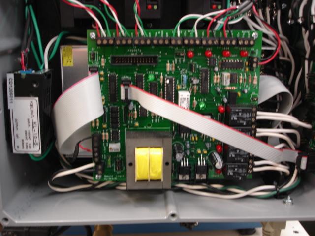

I went with a breakout board from Sound logic.  It's their combo board which has four relays built in as well as the 0 to 10 volt control for the spindle speed.  The breakout board is kinda pricey at $250.00, but it had every thing I needed as well as built in power supplies to power the breakout board and an extra 12 volt source that can be used for extra relays and proximity switches. You don't need two different 5 volt power supplies with this breakout board to keep the computer isolated because it has them already built in.  Just power it up with 110 VAC and your good to go.
There is a large external resistor hooked up to my spindle speed control to provide breaking so I already have that, and as far as reverse goes the chuck is threaded on with no lock so I can't do it.  I guess I could make some type of set screw to prevent it from backing off, but I don't see the need since I don't have a fancy second tool post like yours.

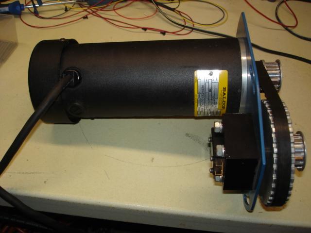

I thought the lathe had a pretty nice looking motor though!  It's a 1HP Baldor with an encoder attached to run the tach on the front of the machine.

Mine definitely is for DC motors, PM or wound fields.  I have a Baldor 3/4 hp, 1750 rpm DC PM motor.
Looking at the picture of yours with the reduction belt drive and smaller diameter motor, I'm guessing yours is a higher speed Baldor...3500 rpm?  Nice!

Wouldn't you know I just put the motor back in and never read the plate on it.  :doh:
So I don't know how fast the motor spins, but I do know the spindle will do over 1200 RPM in low speed and 3600 RPM in hi range.  More than fast enough for me.  I think I'm running my manual lathe at 650 RPM and the finish is always nice.

When sourcing replacement diodes or scr's for that matter, remember the KB or the Minarik decies are isolated tab....  Dont think of fitting anything else without using isolation bushes and micas if you need to else you will continue to blow fuses
  • Posts: 190
« Reply #29 on: March 23, 2013, 10:13:56 PM »
 John I wondered about the isolation on the tab because there isn't any type of isolation on this drive and I'm pretty sure I'm the first to take it apart.  There is just a thin film of thermal compound between the tab on the diodes and scr's to the heat sink.  There are NO bushings, or micas between them or any evidence that their was ever one there as the micas usually leave a mark larger than the tab on the heat sink when you remove them.
Sounds like I should add some isolation?
Dale P.

« Reply #30 on: March 24, 2013, 05:21:57 AM »
I wondered about the isolation on the tab because there isn't any type of isolation just a thin film of thermal compound between the tab on the diodes and scr's to the heat sink.  There are NO bushings, or micas between them
Dale P.
Dale,
Perhaps I wasnt as concise as I thought...
The OEM devices have an isolated tab....Nothing else required....
If you obtain devise from another manufacturer, they may need micas and bushes..
  • Posts: 190
« Reply #31 on: March 24, 2013, 10:47:24 AM »
Ok I get it.  Makes sense now.  Thanks for the tip, I will check out the info sheet on the diodes and see if the tab is isolated or not.  Guess I could just test them with a meter too, or just insulate them to be on the safe side.
