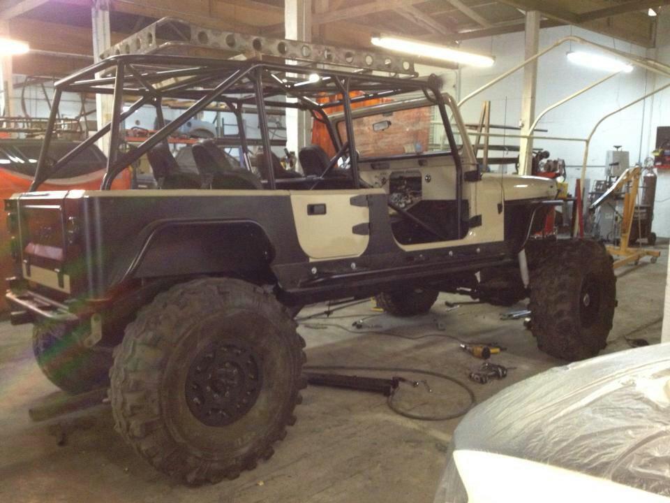

this kind of where I'm heading with the build. Stretching from a 2 to a 4 door. Just your typical family SUV......... :headbang:
Re: Project "Bugout"
« Reply #20 on: March 23, 2013, 04:50:31 AM »
Ah! Thanks for the pic. Lots of questions answered........  :thumbup:
Don't think that would fit on my drive. And, definitely not in my garage!  :palm:
Watching, appreciating, enjoying.  :wave:
