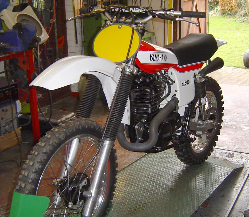

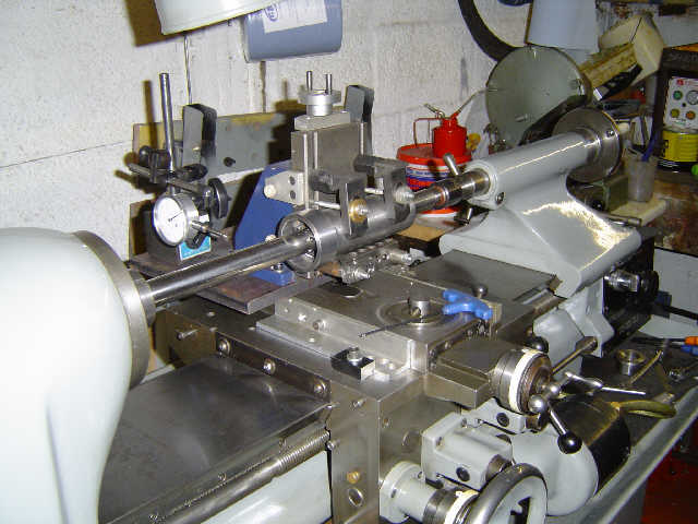

Best to line-bore this sort of thing:
This is how I bored the motorcycle headstock for the frame of my brother's HL500 replica

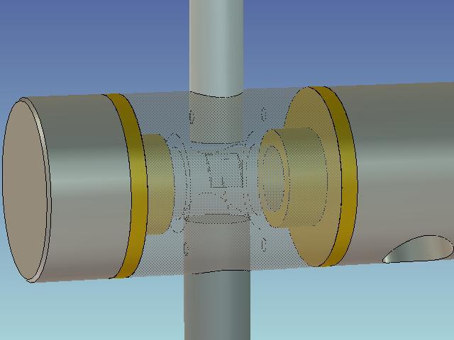

This pic shows the part in question. I rendered it slightly transparent so you can see what the structure is like.
If you guys really want, I can take some photos of the part and the mandrel, but the part is made now and besides, the wobble will not show up on the photo.
