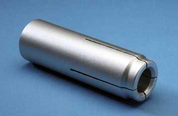

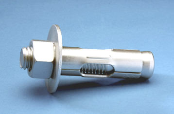

I have used concrete anchor bolt to expand slit mandrel. Saves me from makin tapers. This type:
http://www.confast.com/images2/products/main/drop-in-anchor.jpg
Haven't tried this one:
http://www.confast.com/images2/products/main/sleeve-anchor-hex.jpg
I should mention that I had about 50% success rate...for some reason does not work allways very accurately. Looks like good idea to tighten and loosen just only eneough...no extra 1/4 turn "just in case".

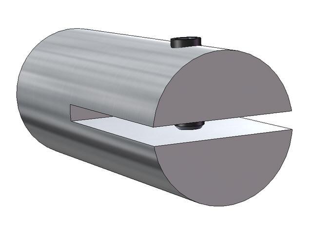

This is essentially the same as awemawson's idea :
1, saw a long slot in a piece of HRS
2, Drill & tap half way through
3, fix in chuck
4, turn & face to size (by doing this at this stage it will be absolutely concentric and square to the axis)
5, insert screw & tighten to fix piece
