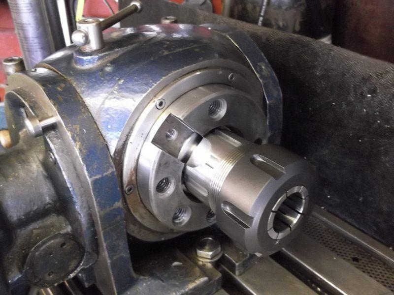

I would buy a collet chuck/collets for the mill and make the rest ,using the one closer and set of collets for all . With you having a bolt on nose on the lathe spindle , you could add two slots to lathe collet holder  and use the same holder flat on the mill table , great for holding work vertical for say slotting a screw ,or mount it on a RT . Just an idea.
This one I use a fair bit ,its been bolted flat on the CNC ,on the RT ,angle plate and face plate of the lathe .

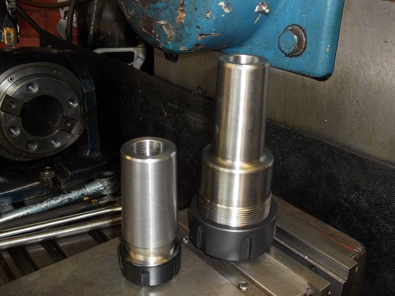

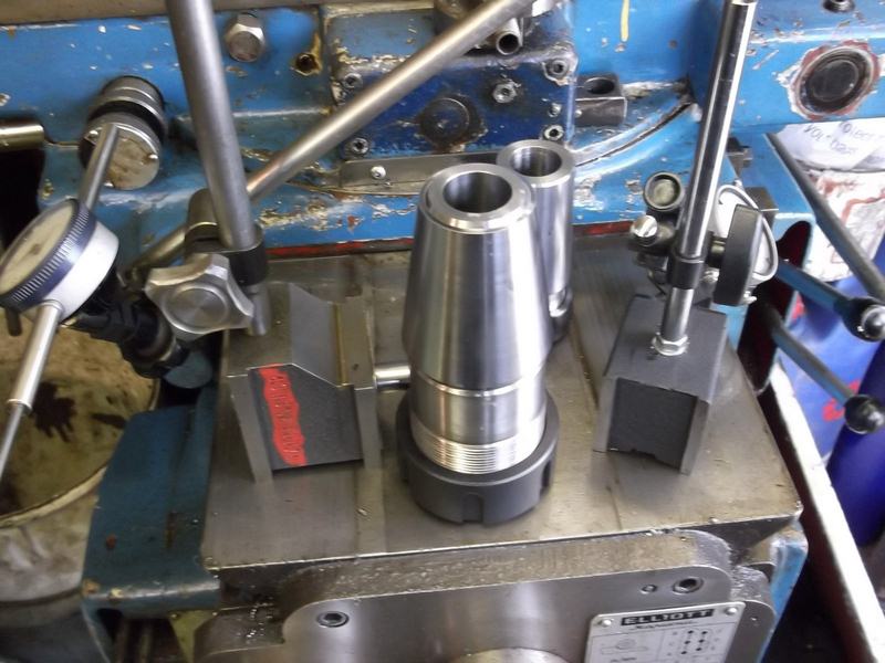

I felt the morse taper collet holders very limiting, so I made through chucks for my Colly Master at MT5, 1 for ER32 and 1 for the bigger ER50.
To make them versatile for both lathe and miller, I also made a 50Int sleeve down to MT5, to fit my Dividing head.
A few pics tell the tale.
