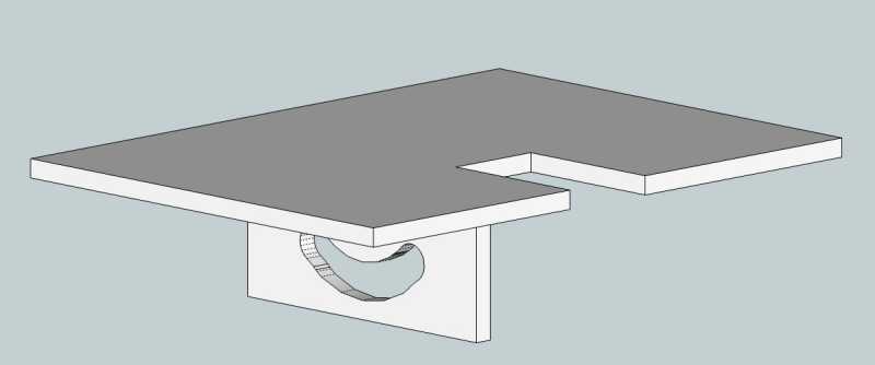

I've been meaning to make a grinding rest since I bought a grinder but have managed with freehand grinding.  I've been spurred into action by noticing the tearing on one flank of a thread I was cutting and decided that the remedy was more accurate tool grinding.
I looked at some designs many of which seemed overcomplicated, and most needed resetting to the wheel after adjusting the angle.
I thought it might be possible to make one that would stay set to the wheel as you adjusted the angle by making the edge nearest the wheel the centre of rotation for angle adjustment. :scratch:
I thought about adding pivots to the side of the rest but realised they would have to stick up above the surface and may get in the way. :scratch:
I thought about a curved slot (and even drew it) before I realised that it would tend to pivot about the bolt rather than slide in the slot. :scratch:
I thought about half a tube resting on two support rods with a clamping rod inside before I realised that the rods would have to go through the grinding wheel. :scratch:
I've finally come up with a design I'm going to try.  I don't know if it's original but I've not seen one like it.  There may be a good reason for that. :lol:

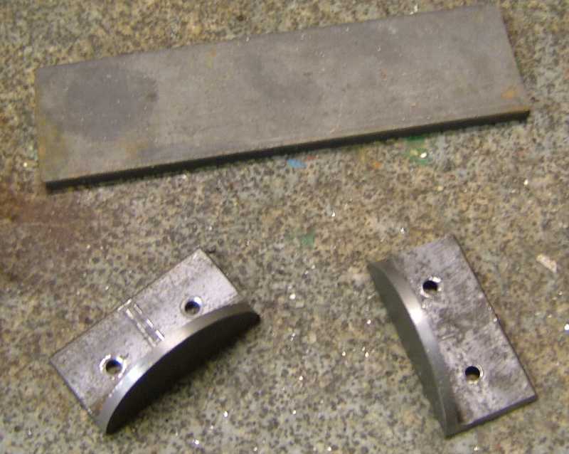

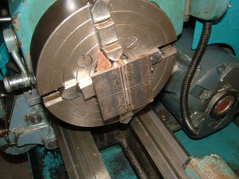

First I drilled two holes in a 2.25" piece of 1" angle and used them as guides to drill another piece of angle and two scraps of the steel I plan to use for the top of the rest.
Then I bolted them together, set them up in the lathe and turned them to 2".
I filed the edges to match as these are not critical.
This was the result.

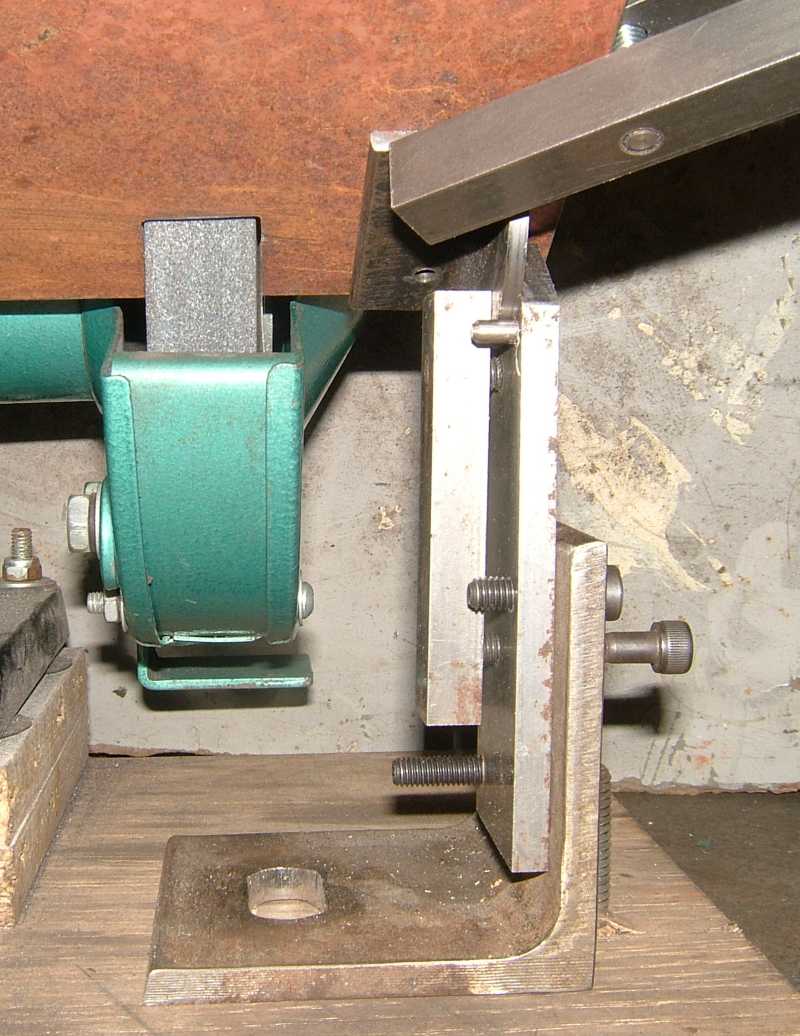

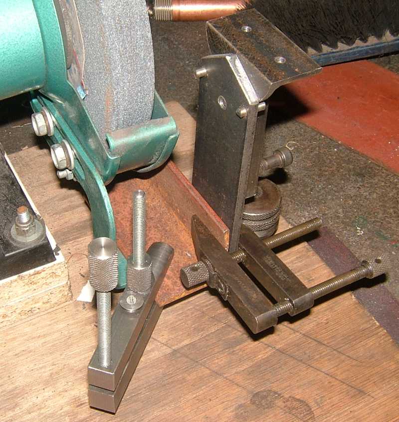

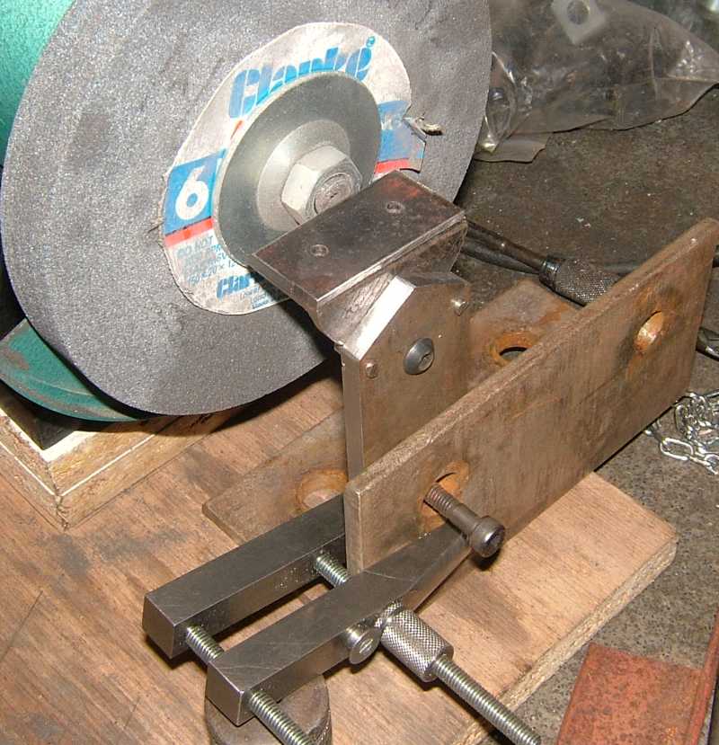

I've made a bit more progress.  As I suggested in the last instalment I decided to make the upright thicker to reduce bending and move the table mounting toward the centre of the table and I've also been trying to work out how to make a rigid mounting and see if it will foul the machine's existing guards. :scratch:
I briefly considered a mounting along the lines of the existing rests but ruled it out as being far two floppy.  The experiment shown in the photo convinced me that it was unlikely ever to be firm enough if it was mounted to the grinder - and it was getting over complicated too - so I decided to mount it to the baseboard.
I decided to mount it at centre height - I'm not sure whether there's any reason to as the whole point is that the angle can be adjusted.  In the photo the rest is level with the top of the nut.  The nut is 19mm so it needs to go down 9.5mm.
I hunted through the "come in handy" pile for a bit of angle to mount it to the baseboard and chose this one as it already had a hole in the right place for the clamping screw.  It won't go rusty either as it's stainless.
I cut the angle in half with the angle grinder (obviously what it's for :lol:)and here's the progress so far.  Did I mention I was making two?

I like the setup you used to round off the angle iron.  I wouldn't have thought of that.
-Sparky

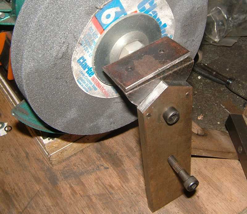

There's a bit more progress today.  A bit of drilling and tapping to secure the upright to the mounting.  Then I cut out the top surfaces and cut a couple of notches with angle grinder, chain drilling and file.  I extended the holes in the bottom of the base to make adjustable mounting slots.  These are deliberately a bit wide to allow some adjustment.
Here's the progress now.
The cutouts around the grinding wheel are deliberately a bit tight to allow for fitting after they're fixed to the pivots.  So far it seems as though it will work OK.  I can't see any in and out movement of the edge against the grinding wheel when I adjust the table with the edge about 0.5mm from the wheel.  The aspect that I have been struggling with a bit is how much movement I need to build in to allow for wear in the grinding wheels without fouling the guards on the grinder and I was considering having the table wrap less around the side of the grinding wheel.
Rob's comments on grinding wheels were helpful and I decided that it was better to replace them sooner rather than later so I made the notch in the table 25mm deep and I made the slot in the base long enough for 15mm of in/out adjustment - which is enough to take a six inch grinding wheel down to 4 3/4".  I can always take a bit off the table or the guards if there is a problem.
Here's a picture showing how the parts fit together.  Bolts will be reduced in length.
The only remaining tasks are to fix the table to the mounting and fasten the rest to the grinder baseboard.  I'm thinking about how to do that - my plan was to use some countersunk Allen bolts from the bottom but I'll have to buy some before I can do that.  I might just weld them instead.
Sparky, I'm glad you liked my setup, it worked OK but would have been better if I'd bolted all the bits together a bit over size and then cut them down together before I put them in the lathe.  That way I'd have had a flat surface for all the jaws to seat on.

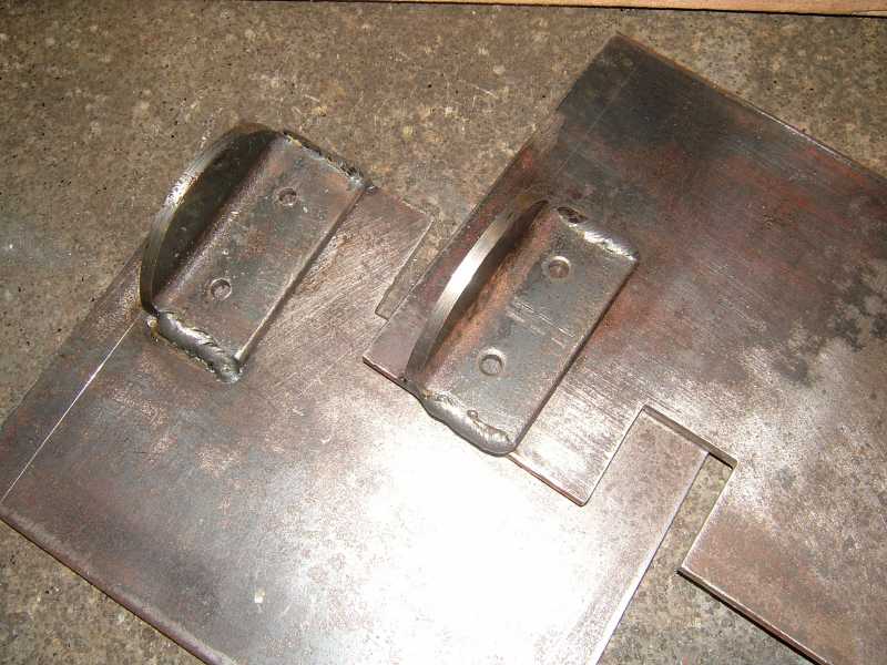

I decided (impatience won) to risk distortion and weld the tables to the mountings.  The results were OK.  There was a little bit of a bump opposite the welds near the middle but a few minutes work with a file made it acceptably flat.  Just one picture today.

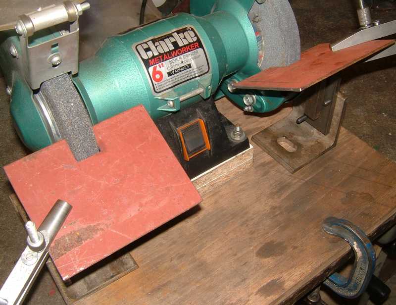

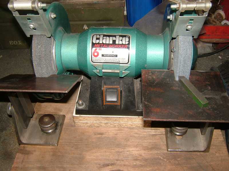

Thanks for your interest David.  I don't have quite as bad an opinion of the wheels as you.  Perhaps my expectations of a cheap grinder weren't very high.  The coarse one isn't very good in fact the fine one may be quicker but there have been several occasions when I've touched something to the wheel to take a little off and taken off too much.  Better wheels might be nicer but I think I only paid £14.99.
I do regret not getting a grinder with a bigger motor as it's very easy to slow it down if you're trying to take off a lot of metal.

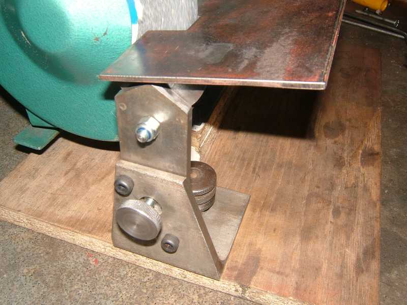

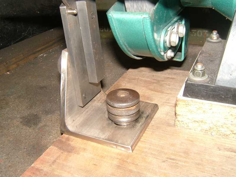

I've finished off the grinding rests.  I've shortened some sticking out bolts, and found some knurled nuts and bolts to hold them to the base board.
I've replaced one of the clamping screws with a stud and a nyloc nut so it stays adjusted and I've made a knurled knob for the other.

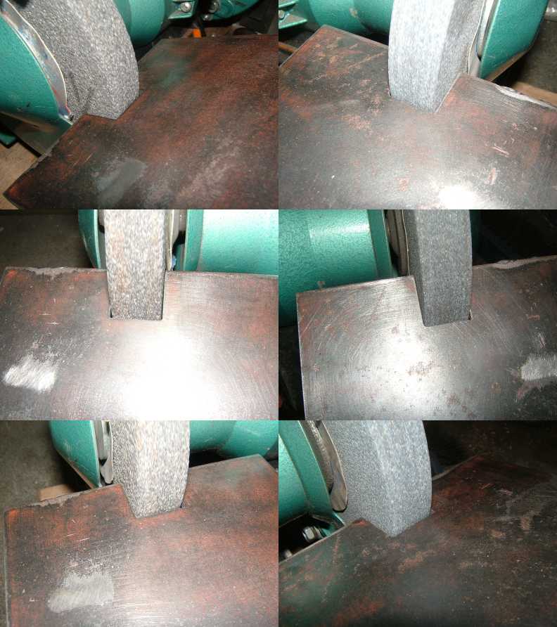

Then I've tried it.  This composite picture shows the tables at different angles.  The bases weren't moved and the grinder is running.

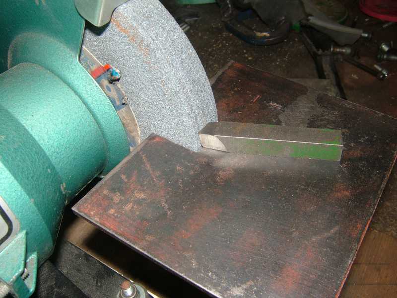

This is the table set up to grind a lathe tool.
So, does it do what I wanted it to?  Yes, definitely.  It is easy to adjust.  The tables tend to ride up on the support pins as I alter the angle but it's easy to push them to the correct place.  The angle can be adjusted without altering the in/out adjustment.  Construction was simple.
