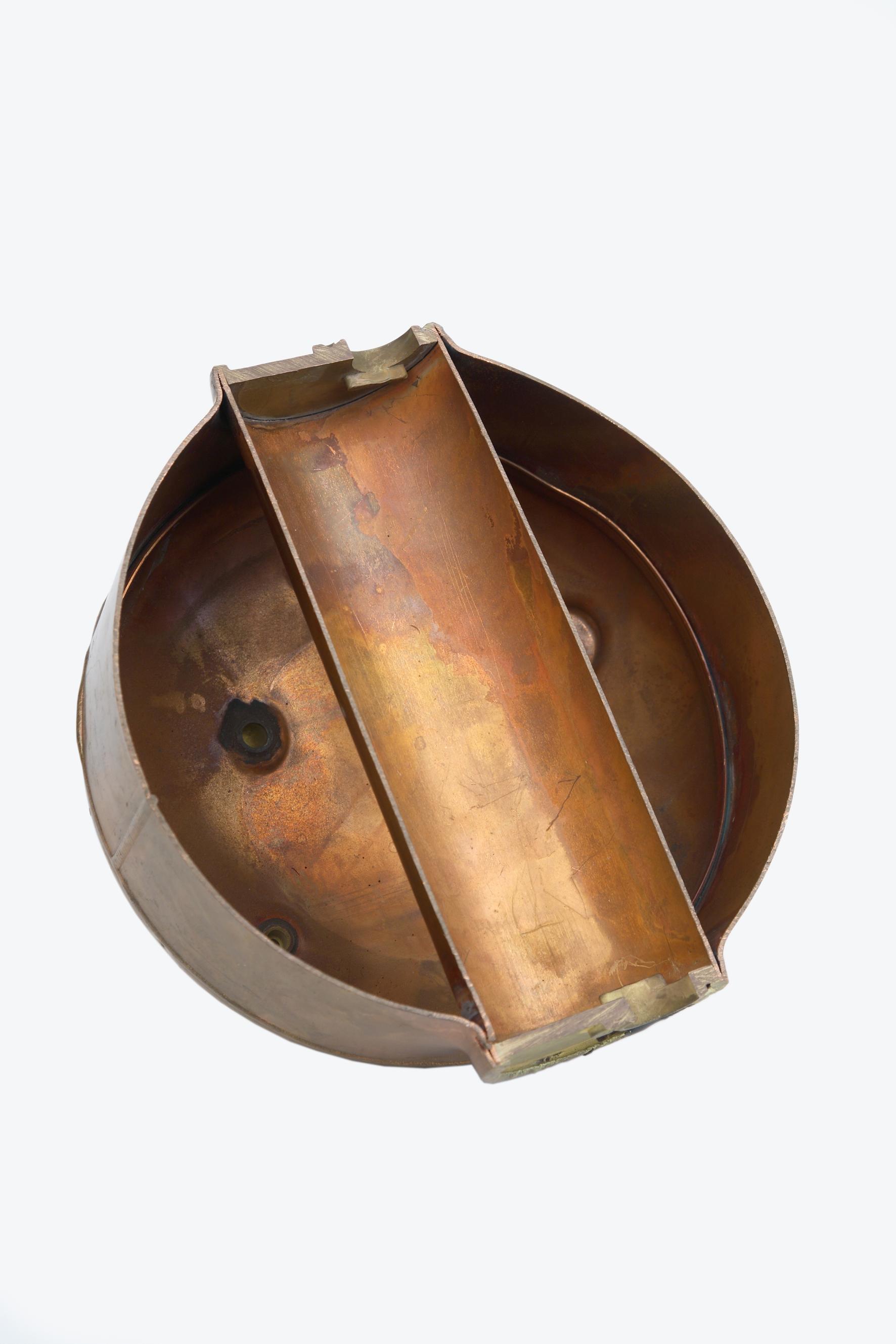

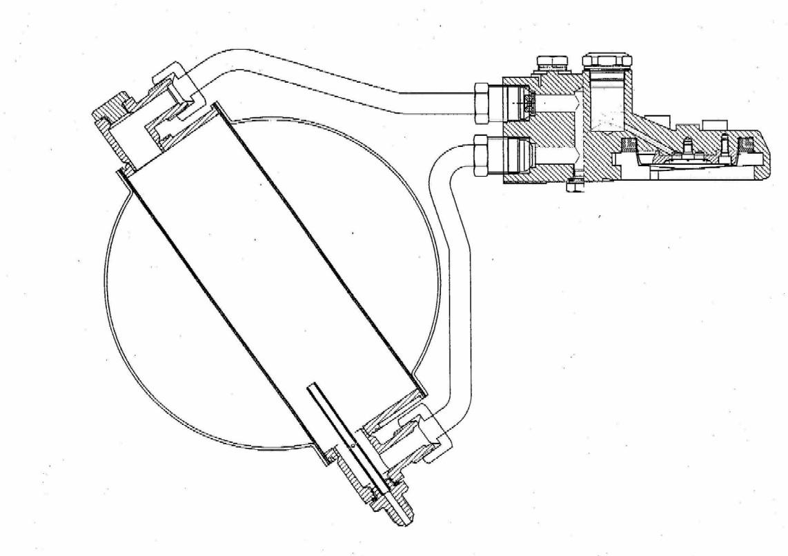

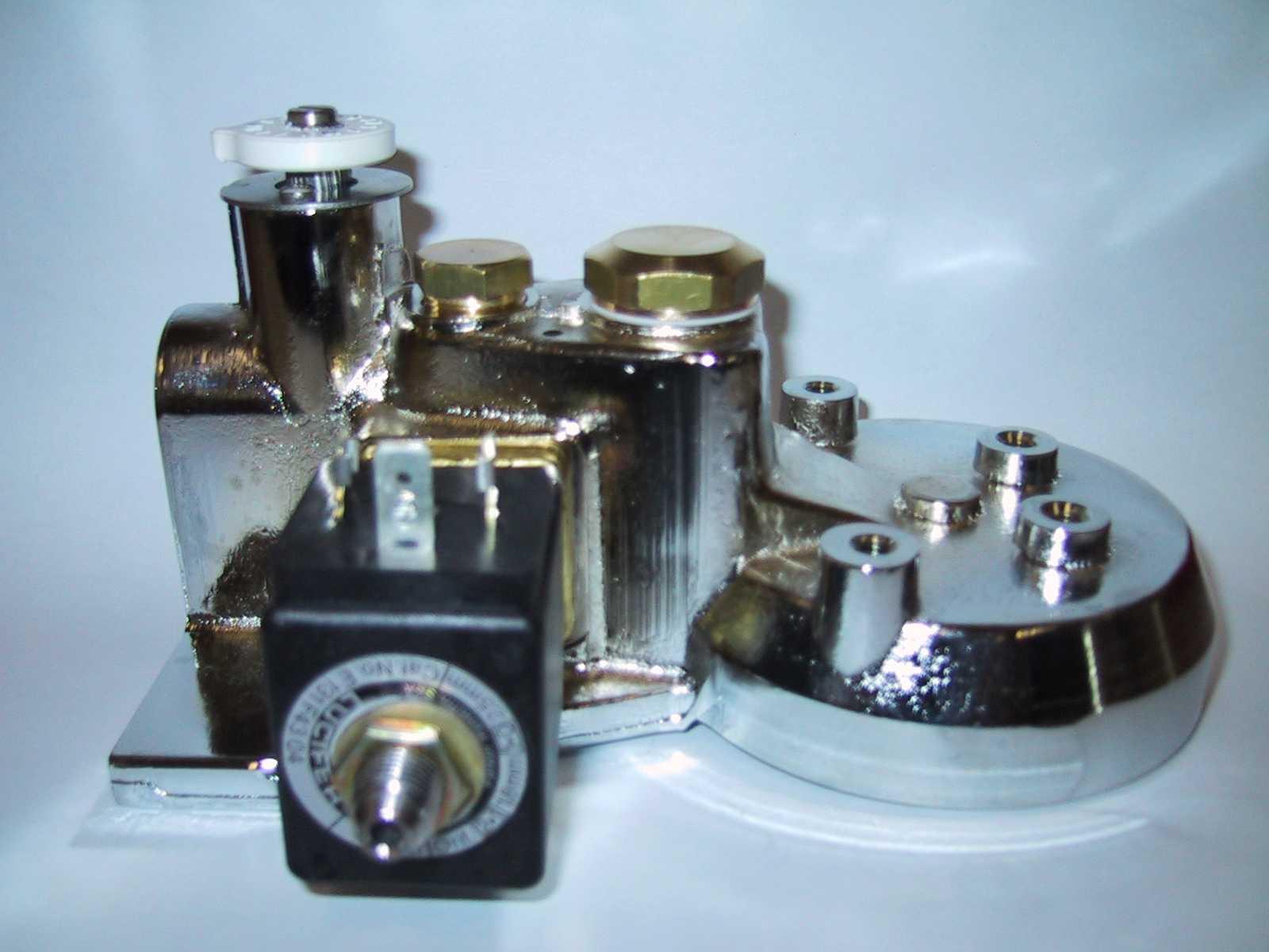

Not that well up on this.If you had a chamber and pumped the water in and restricted the outlet via a jet would that work?
Its the way an espresso machine works.The boiler is at 1.8 to 2.1bar water is pumped in at 8.5bar to a heat exchanger it then goes through a 0.8mm jet to the brew head and gives an outlet temp of 86 to 90 degrees celsius as the jets block the temp goes up eventually on some machines you end up blowing steam out of the brew head
Guess who plays with coffee machines :D
I worked in the plastic industry for a while the oil you need is HTO heat transfer oil if I remember correctly we ran up to 210 deg C
