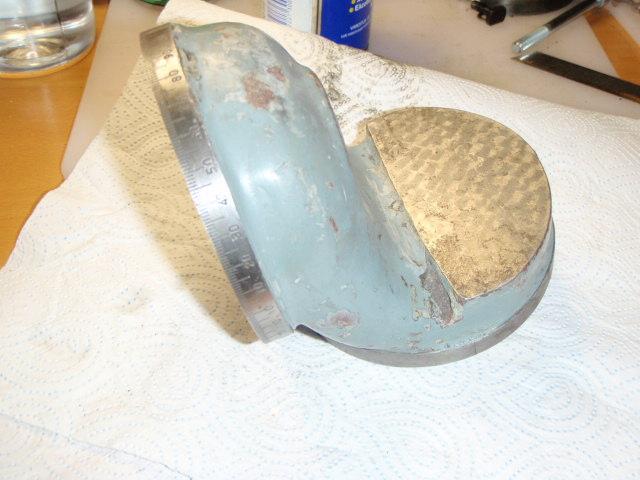

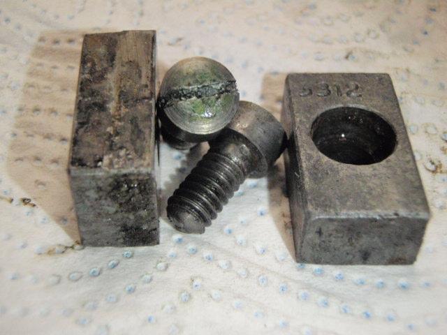

Cut into latest sceene:
I have tried rust removal with different methods. It now appears that the light surface rust / gunk removal with household chemicals for iron metals is:
1) Pre-wash the car prewash / rim spray. Duration of soak is for a few minutes to something like 10/15 min. I have used stiff nylon bruch to remove the gunk. This seems to remove most of the grease.
There must be better detergent? Some degreasers I have tried smell pretty bad. On the other hand this method catches major part of the waste on the newspaper at the bottom of the bucket and it is easily removed with all the debris / grease. Whole lot easier to deal with semi solid waste that liquid.
2) Dunk into car wash / water mixture according to the instructions. It looks that dish detergent (Fairy lemon) is equally effective. I soak the parts pretty well and long in warm water + finally a light brushing.
3) Dunk into phosphoric acid (1-3%, I use cofeemaker descaler) or citric acid in water. Warm water seems to help more that higher concentration of the accid? Until parts looks "right". Some larger parts seem to take hours to overnight.
4) I feel that I have to neuralize the mild accid coctail. I use drain cleaner (Liquid plumber?), it seems to have 10% of caustic soda lye PH 13.5. I have diluted it somewhere in the 0.5 - 1%, and leave iron pars there for a 10 mins or so to wait for the final rinse.
5) The final wash / rinse
6) Drying
7) I remove remaining rust and residue with a quick application of Mirka Mirlon VF abrassive sponge. This really should not abrade anything, but I make sure not to rub any more than strictly necessary. I don't use power tools or sanding papers or such.
8) Then I should prepare them into interim storage.

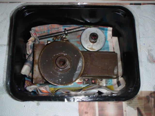

QUESTIONS:
A) How should I rust proof the parts that are not goining to be painted?
I'm soakking them in lamp oil to get rid of the residual water, then drying and leave them like that. These parts are going to be in the gringn machine I don't want to use too much lubricant to collect any grit.
B) How should I rust proof until summer the parts that are going to be paintted? Or I just dry them well and stuff them under couch and hope that my wife won't spot them?
This procedure soulds longwinded, but I have groups of square paintters buckets and I have one liquid in each. I get awfull amount of grit out on some parts, but I usually save them last and use liquids first for cleanest parts.
Comment?

If you are using common household strength acids, then a baking soda dip or a wash-off with old fashioned lye soap should be sufficient to neutralize them.  Drain cleaner (potassium lye or sodium lye) can be as bad for your parts as acid.  All you need to do is neutralize the acid.
The approaches I use to keep iron or steel unrusted in my shop are: (A) clean and wax steel using a good wooden floor wax; (B) oil the steel using WD-40 type oil (understanding that it has a small percentage of shellac in it), wrap with kitchen plastic wrap, and store in well-closed plastic bags; or (C) treat with Naval Jelly (i.e. thickened phosphoric acid) and wrap in kitchen plastic wrap.
The "A" approach is relatively neat and I have bar stock sitting in my rack dating to the mid-1990's that is bright and unrusted here in western Washington State where the standing joke is, We don't tan, we rust!  The wax comes off with most solvents (IPA is common, but I have acetone in industrial lot drums).
The "B" approach is good for small or complex shape parts.  A dip in an acetone solution followed by a good air-hose clean gets rid of the coating oil.  I use this approach for shipping parts to minimize packaging issues.
The "C" approach was what I was taught as an apprentice.  It works reasonably well, but I find that waxing ("A") works better.
I hope this helps.

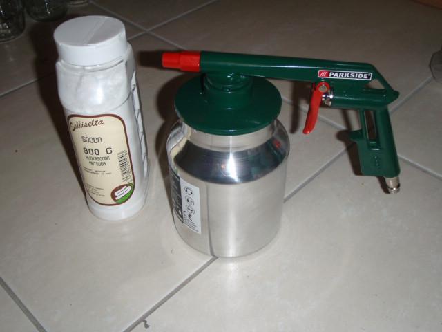

Soda blasting should allow part to cleaned without disassembly - that't what I have been reading and told. But I don't know for sure.
I tried firs normal can-type sand blasting gun and baking soda. You can get baking soda in industrial kitchen pagages, but wife bought me two one kilo jars. That was enough to try and clean about half a litre of small parts. There was soda dust everywhere! Lucily I did it outside. Nice thing is that baking soda is much nicer on clothes, teeth and cellphones than blasting sand....but I still wear respirator and glasses. See pictures. That is not a proper soda blasting gun, but I wanted just to try it out. Worked somehow, but spew out soda like there were no tomorrow.
I bought proper soda blasting gun. And a can of soda, but haven't tried it yet. I heard that it is even more critical about moisture removal from pressurized air than sand blasting. Borrowed a pretty good one, but it needs some work.

Can't see it here, but someone told not to go overboard with chemicals. I have washed some parts with warm water and soapy detergent.
Re: Rust removal, short term storage, paintting and lubricating

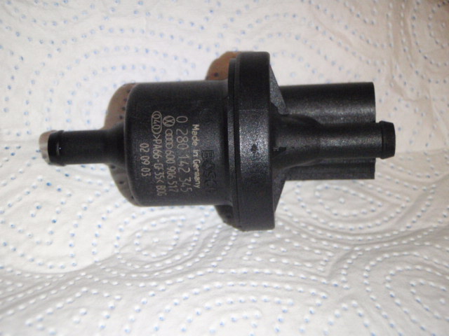

One polution control valve was gunkked up my wife's car and threw an error code. Used industrial cleaner and then removed water with denturated alcohol (Thanks Pete W!) to clear it. 5 mins of washing and 1 mins of rinsing with denturated alcohol sorted it out. It's working again. Weird thing is that it looked very dirty inside out, but practically new after such a short cleaning.
Does anybody knows a good primer/DIY instruction about ultrasonic cleaner use and detergents?

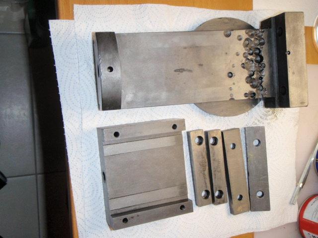

Now I only have to figure out what do with this vice. Swiss cheese does not look appropriate here.
Well you could fill the craters in with pot metal, solder, braze, or an epoxy like JB Weld.
Or you could mill the whole top down say 3mm and laminate a 4mm piece of steel back in place using a suitable epoxy. Then mill the top surface true and to proper thickness.
« Reply #25 on: February 27, 2013, 08:09:27 AM »
I don't think I want to reduce thickness of the top - it is in tensile load and I believe that is not very ideal for cast iron to start with. My first instict was cast iron stick welding....but the heat is an issue and generally I don't have too good understanding on cast iron welding. Filling epoxy could be the way to go, it really does not fix anything, but should make it easier to clean.
Pity it was drilled...It probably was put into pilar dril, because the base did not have keys/screws in it...have to find repalcement for them - imperial standard I think.

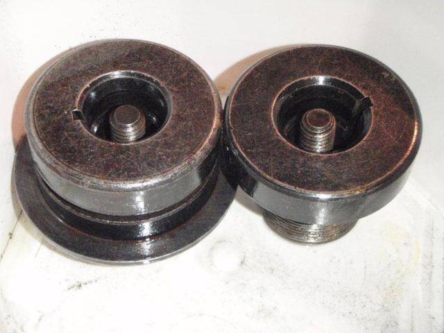

One grinding wheel holder was so badly gunked up it didn't come apart, bit oil, bit soakking, bit soft hammer, but to remove all grud took so long time that bluing was gone. That one too needs some attention.
  • Posts: 6940
« Reply #26 on: February 27, 2013, 01:15:30 PM »
Old tractors sitting unused in fields, seized, can usually be restored if you are patient and use kerosene (paraffin) to let the parts soak. Just about anything can be loosened up if left in a jar of kerosene for a period of time. Maybe it will take a month, but it will come loose. Rust seized pistons are loosened this way -- kerosene is poured into the cylinder and kept full for a month, or more -- when it begins to leak down through the rings you can knock the piston out through the bore using a piece of wood as a drift.

One item crossed on my list:

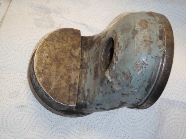

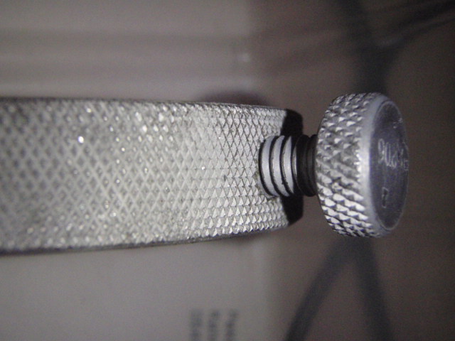

Filled the drilled face with Plastic Padding Chemical metal. Grease removing, soda blasting, fill, file and ready. Considered filling it with auto body lead or some metal, but I'm trying this firs.
Also tried soda blasting to a larger piece that was not disassembled....cleans really nice, but does not remove rust. Need a bigger compressor. Funny thing is that this expensive soda blasting can works whole lot better that sand blasting can on soda....there must be a small difference on the structure? It is also whole lot economical...very much less soda is blown, but it cleans better!
