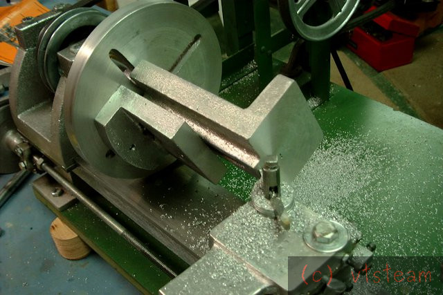

Re: Gingery Lathe and Accessories
« Reply #75 on: February 20, 2013, 06:00:38 PM »
And the second pass.

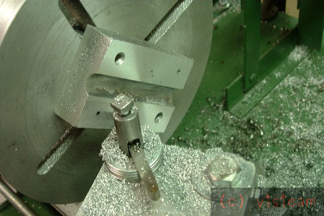

« Reply #78 on: February 21, 2013, 10:27:55 AM »
After milling the way location, that reference surface was bolted to an angle plate and then I faced the base of the vertical ways on the faceplate. I like these Gingery pattern angle plates because one leg is shorter and radiused -- so it can be placed closer to the edge of the faceplate, to accommodate larger work. Each long leg has one tapped hole and one through hole, for ease of bolting up. The base legs have two tapped holes. These are in line and work well with radial slots in a faceplate.
btw, the turned aluminum seems to have a good non- skid grip that I believe wouldn't necessarily be improved if it were polished steel or iron. I have a shiny purchased faceplate for my Atlas lathe, and don't like it quite as well. I may actually cast an aluminum faceplate for that lathe.
The ease of using separate mandrels for turning and milling by simply loosening two setscrews on pulleys in the headstock and transferring was becoming apparent. I liked it better than maintaining a single mandrel and removing the faceplate because it was difficult to maintain faceplate alignment -- even when marking the positions on faceplate and mandrel. After this point I started casting workholding fixtures, like faceplates, and chuck backing plates directly onto their own mandrels. They stay in perfect alignment that way, and it is therefore much quicker to change over.

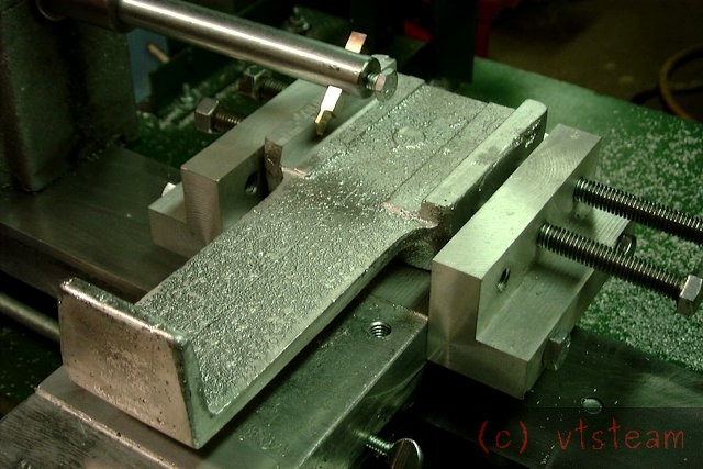

« Reply #79 on: February 21, 2013, 10:50:20 AM »
Now that the base is squared to the way face of the pillar (I guess that's the proper term) it is time to attach the steel slab that will be the actual way. The base is set on the lathe ways and a machinist square is used to align the steel piece. One screw holds it in place and two two small pre-drilled 3/32" holes at the top are spotted through to mark locations for drilling and tapping to accept the other attachment screws.
We are again using the actual parts we want to be in alignment as their own references -- in this case the lathe ways and the vertical ways are directly aligned with each other through the machinist square. Naturally you don't have to do it this way, and the vertical portion could be aligned with any flat surface off of the lathe. But it becomes a habit to use the actual parts for reference or metal removing operations, wherever possible -- and in many cases this does make a difference to the accuracy of operations. It's also a satisfying way to do things.
« Last Edit: January 04, 2018, 10:46:03 PM by vtsteam »

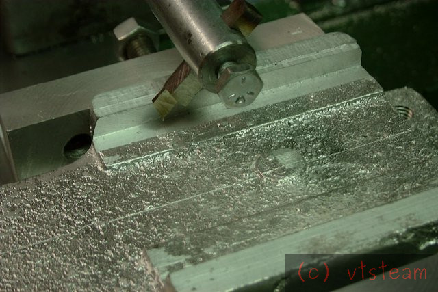

« Reply #80 on: February 21, 2013, 11:00:26 AM »
With the vertical pillar made up it's time to pay attention to the vertical slide casting. First step is to machine the top flat, and then use that as a reference surface for doing the underside. I'm using the square bar workholders on the milling table here.
You can see the half round channel left by the core when cast. It is rough and undersized here -- it will be bored larger once the upper clamping piece (another casting) is attached.
« Last Edit: January 04, 2018, 10:46:30 PM by vtsteam »

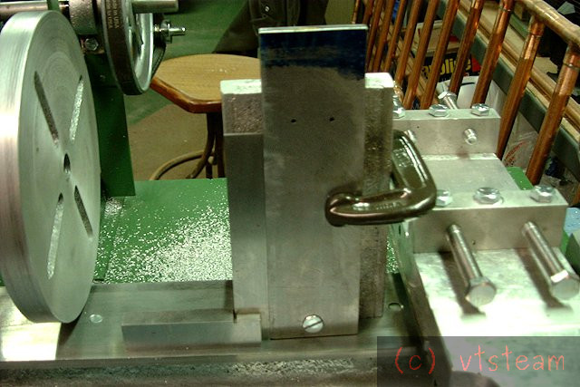

  • Posts: 6835

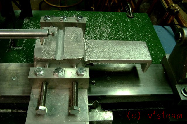

« Reply #81 on: February 21, 2013, 11:05:52 AM »
After the top was flat, I removed the rectangular clamping blocks, and attached the angle clamping blocks to the side of the milling and boring table. Then clamped the vertical slide bottom up to machine the wear pads.
Note that the L shaped clamping blocks can either be attached with the base leg inward -- to widen the boring table -- or outward, as done here, to bring the clamp bolts closer to a narrow workpiece.
« Last Edit: January 04, 2018, 10:46:54 PM by vtsteam »

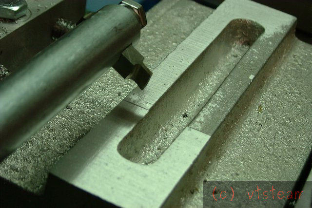

« Reply #82 on: February 21, 2013, 11:12:46 AM »
Cleaning up the inside corner of the wear pad.
After I finished milling this slide I checked the sliding surfaces with machinist blue, intending to do a final hand scrape to bearing. I was amazed that it didn't need it, and how little time it had taken to make the slide ready for use. I couldn't get over the savings in time -- usually it took a whole evening to file and scrape a slide and install gibs. And that was after a lot of practice. Now I could have a working slide from a rough casting in minutes. Just amazing!
« Last Edit: January 04, 2018, 10:47:18 PM by vtsteam »

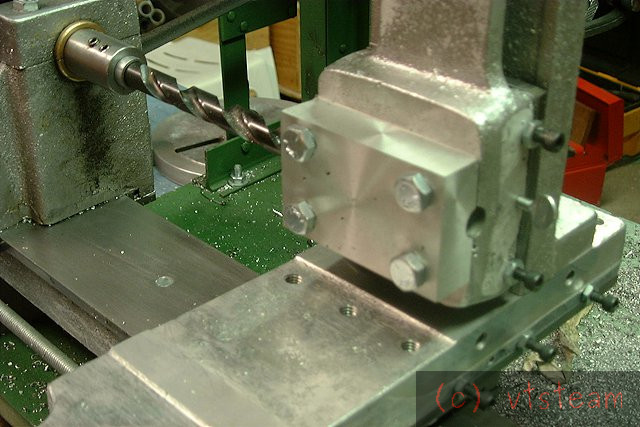

« Reply #88 on: February 22, 2013, 09:47:07 PM »
Here the clamping block has been attached to the vertical slide, and the through hole is being enlarged. Afterwards it will be bored to exact size with the boring bar.
The vertical slide ways have been bolted to the milling table. This drilling operation again takes advantage of the fact that the workpiece is in its proper finished working position, and being driven along the ways to insure that the hole is parallel with the lathe ways, rather than drilling and fabricating from measurements and measured set-ups.
« Last Edit: January 04, 2018, 10:48:13 PM by vtsteam »

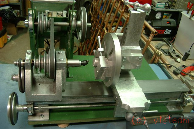

  • Posts: 6835
« Reply #89 on: February 22, 2013, 09:56:48 PM »
And here is the basic vertical milling attachment put together and ready to fly cut a surface -- probably as a test -- can't quite remember what that workpiece was for!
Notice that the lathe's faceplate is being used as a vertical milling table, and that the lathe's 2 jaw chuck is bolted to that as a work holder. The milling spindle has replaced the faceplate arbor in the headstock. The lathe is now backwards, in a sense!
We are now at the stage where we are able to take advantage of interchangeable parts, and have built up a library of useful and reusable patterns to further extend this machine, or build others.
While it looks finished in this photo, the faceplate/milling table is still not a rotary table -- there isn't a means of rotating it yet, but it can be clamped and used to mill parts on a large flat surface -- larger than the horizontal milling table, at this point.
« Last Edit: January 04, 2018, 10:48:42 PM by vtsteam »

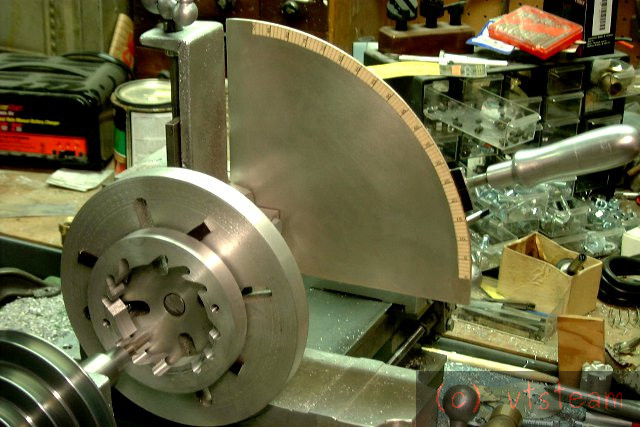

  • Posts: 6835
« Reply #90 on: February 23, 2013, 10:43:17 PM »
The final stage in building the milling attachment was adding a big angular measurement sector of aluminum to the vertical slide, and a handle and arm (tommy bar) to rotate the work arbor and rotary table (faceplate).
The handle can be seen mid right, and there is a black aluminum index strip also attached to it that gives a reading against the graduations on the sector. I only made one index mark, since there was already sufficient accuracy for my needs with such large spacing of the graduations, but I could have put 10 marks on the black strip and made a vernier reading that way for measurements of tenths of a degree.
To make the markings for the sector, I printed out a scale with a computer printer from a layout I did in a simple cad program. This was glued to to the aluminum sector. To turn the work arbor a full 360 degrees you would need to do that in 4 steps, releasing the arbor to bring the handle back to zero after turning the full range of 90 degrees.
The handle had a wonderfully simple mechanism for attaching and releasing to the work arbor, as needed. The work arbor was 5/8" diameter. So I simply took a 5/8" machinery collar (shaft collar) and removed the set screw. from it. The handle rod consisted of a length of 5/16" steel rod with the end threaded to match the setscrew thread. It simply screwed into the machinery collar. You could grip the arbor by twisting the handle, or release it by twisting in the opposite direction.  The top of the rod had a cast-on grip of aluminum. I used a wooden file handle as a pattern when I cast it. This whole mechanism was practically put together from ready-made components.
To turn the rotary table to any particular angle all you do is twist the handle, tightening the machinery collar on the work arbor and then rotate the arbor to the angle desired.
If it is more than 90 degrees, I would first rotate to 90 degrees, twist the handle to loosen the collar and bring the handle back to zero, then twist to tighten and proceed to the measurement desired. That's all there was to it.
This is the last picture in this series. It is of cutting a scroll housing for the Tesla disk turbine (for an experiment trying it as a compressor, rather than a turbine). The Gingery lathe, and own milling attachment are finished and doing interesting work.
Thanks to madmodders for asking me to write about this, sort through these old pictures, and get them out for people to see. I hope it stimulates people to imagine new possibilities for their own equipment if they have a limited shop or limited means. Again thanks also to David Gingery's inspiration and guidance through his books.
