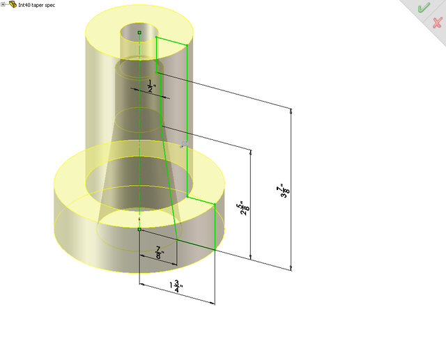

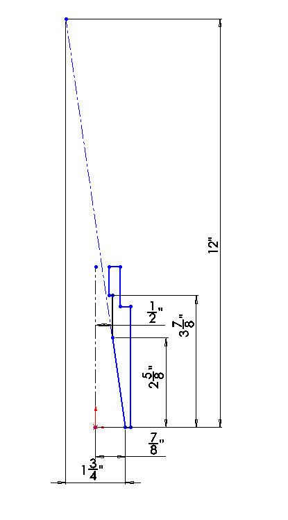

Well i got my filthy hand on this tool holder that states BT40.. after some googling i found that the taper is of the type "7/24".. well that is some ancient way of telling degrees or angle i guess.. 7 inch per foot.. right.. How do i convert that to well.. modern measurements.. like degree of angle....

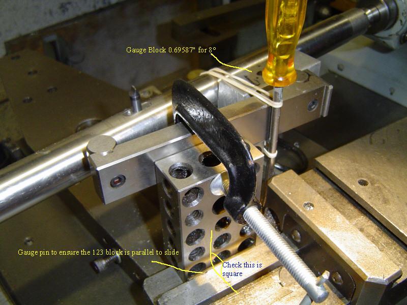

Do not convert ! (it's much easier)
Tapers that are specified in inches per foot are best set-up using a displacement and length. Converting  to angle will always produce an error.
If you are trying to cut the taper with a top-slide, either set the angle with a sine-bar* or dial in on an existing taper.
BTW - BT40, Int40 , Int30, BT30, BAT50 etc. etc. all use the same 3 1/2" per foot (on diameter), but the drive end will vary (some are designed for auto changers)
* if you are using a 5" sinebar and want a 3.5"/' taper, the spacer block should be  3.5/2 * 5/12 =  0.7292 (OK this produces a tiny error ;))

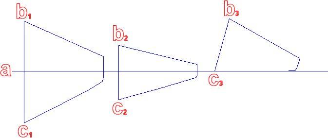

Russell - that's what I thought.... but the reason we're wrong is actually relatively easy to show using a diagram; see attached.
The first figure shows the full 7/24 taper. The included angle between b1 and c1 (from an imaginary point at the rear of the taper) is arctan(7/24), or 16.whatever degrees.
If we halve the taper angle, to 7/48; we get the 2nd figure. Now the included angle between b2 and c2 is 8.3 degrees. However, if we rotate the taper so it sits flat on baseline a; you can see it no longer forms a right-angle triangle; and thus, our trig rules go out of the window..
Indeed, it should be clear that if you halve the b1/c1 included angle, you end up with the actual angle of taper; that is the angle between a and b1, or a and c1.

Gage line (diameter of large end) = 1.7500"
Pilot diameter (parallel at small end ) = 1.000" +/- 0.005
Length  (gage to end of pilot)  = 3 7/8" (3.875")
Taper 3.5" per foot
[edit] Helps if one keeps to fractions :)

As Bill says, you don't need to know the angle. Not having a sine bar, I would arrange a plunger indicator lying flat and with the plunger at exactly 90° to the lathe bed, and the plunger touching the side of my top slide. I would then set the angle of the top slide so that, when the carriage is moved along by 24 units, the dial indicated a variation of 3.5 units. The greater the distance over which the measurement is taken, the better. My top slide is 120mm long, so I would  look for an indication of 14mm over a carriage movement of96mm. 14:96 is the same ratio as 3.5:24.
It is easier to measure distances precisely than to measure angles accurately, though the dial indicator stil has to be set horizontal and at 90°  to the bed.
Alternatively, you can set the toolholde up to run true on your lathe, and adjust the top slide angle until a DTI mounted on the top slide with its finger at centre height shows no movement as it is run along the taper. The top slide should then be at the right angle to bore the taper in your spindle, using a tool at centre height.

Hope this is clearer.
A spindle nose diameter of  (3.4993 - 3.4986) is also specified
Ade
I think you were right the first time - I've attached a diagram. :scratch:
The triangle ABC is the taper we are trying to make.  It starts 7 units wide and over a length of 24 units tapers to 0.  (I've drawn it to a point to make it easier to visualise).  The triangle ABC has no right angles so we cant simply apply arctan.  We need some extra lines.  To get the included angle we could draw a centre line from the midpoint of AC to B to give us two right angled triangles.  They would be the same shape as the triangle BCD and the angle would be arctan(BD/CD).  So the included angle is 2arctan(BD/CD) and the angle to set your topslide to is arctan(BD/CD) or in this arctan (3.5/24).
I hope I've got that right.
