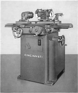

Pure guesses -- could the 63.05 refer to date of manufacture? and CK = Cincinnati UK?
Is this it?
Re: Cincinnati no.2 (English made?) tool and cutter grinder - buy or pass?
« Reply #6 on: February 02, 2013, 12:06:40 PM »
Is this it?
OMG  :clap: excluding the electrics it looks 1:1!
Thanks for the links...I found those newer ones too, but they are quoted something like 10" bigger in every dimenssions and about 1 metric ton...hoping old SAE inches and pounds would translate lighter :lol:
Value would be closer to 500 - 600€ with motorized work head + 100 kg of accesories, so it would be on the ballpark, unless the table or spindle is shot.

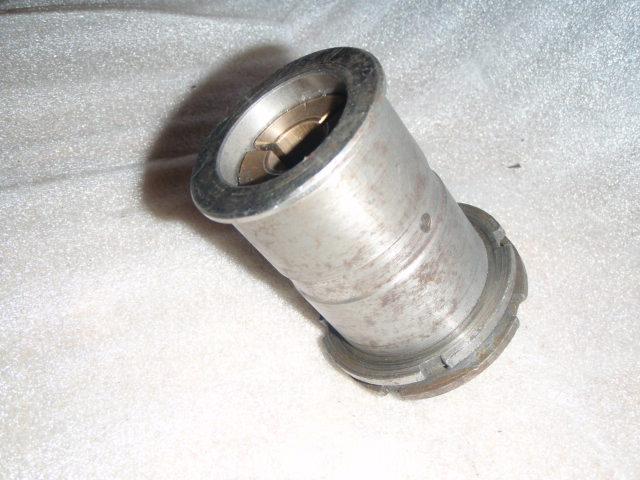

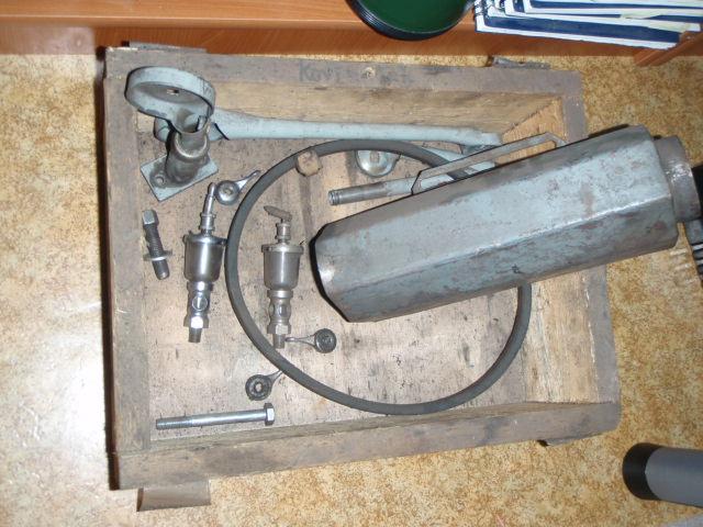

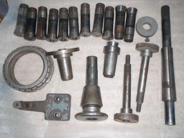

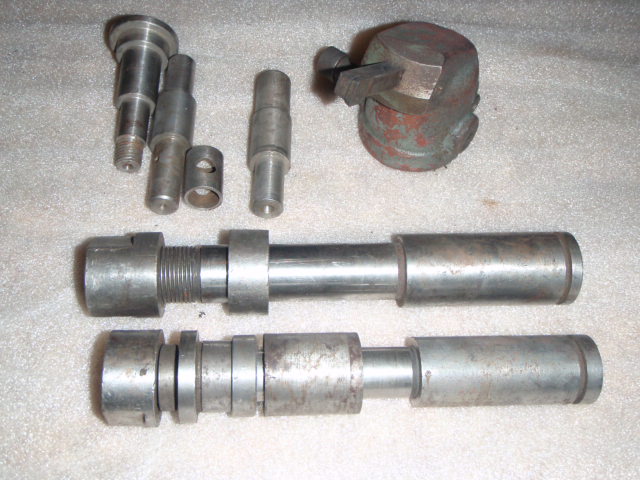

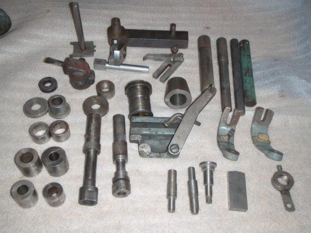

Got the eManual (probably the same than I ordered) and tried to coin the name and piece accessories together.
I have the workhead in the garage. Haven't really had a look for it yet, but this is what I have:
These items I'm pretty sure I have a idea what  they are.
Looks like someone got 14 mm collet really well stuck into MT5 collet holder.
Also the ID grinder attachment bearings are shot. I think I have oilers in the wooden box.

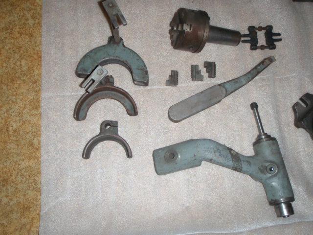

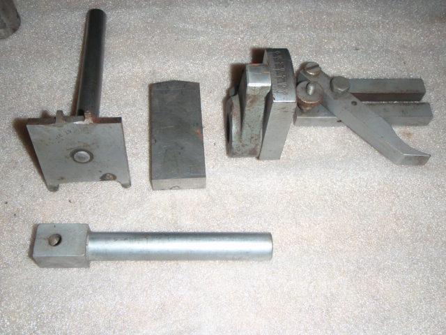

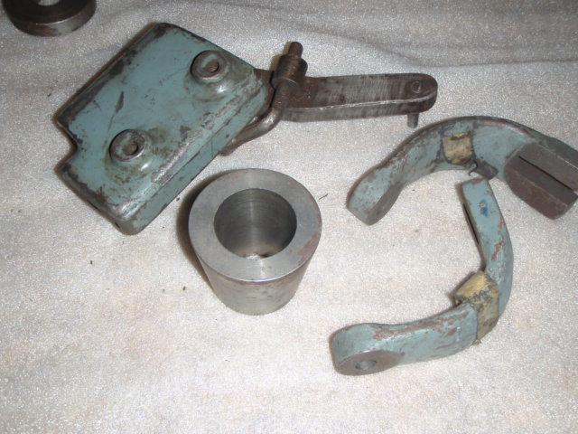

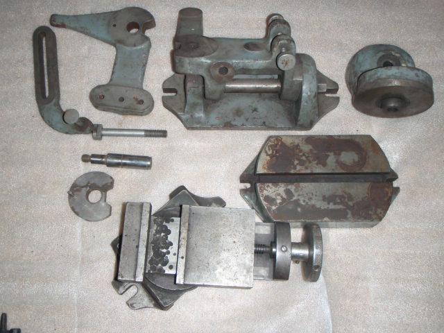

Following items are mystery to me in a large extent.
And some close-ups.
They must be important. :lol:
That ISO50 holder seems to be an adapter for same cone , but smaller dia.
Last item is probably a flat belt sheave, for what?

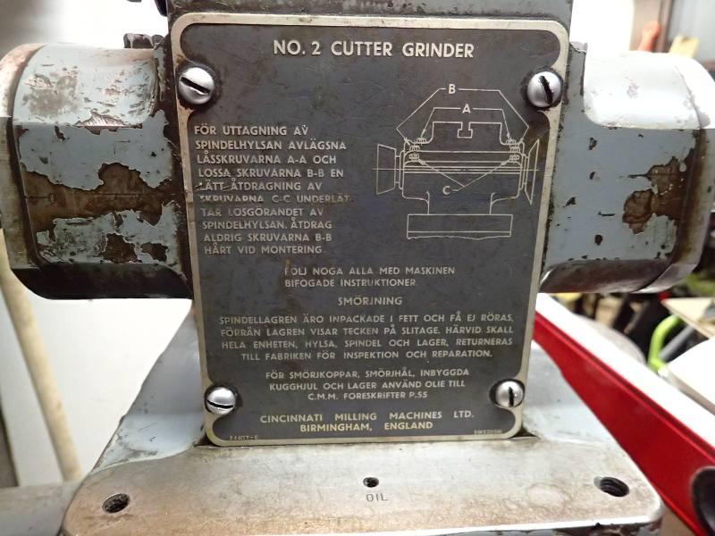

Stuf got cleaned and the monster got transported into my garage. I have been cleaning it and laest stuff was to check insulation restistance of the motor (pass with flying colors). Machine feets are ready to fit and only one more thing left before firing it.
What is the spindle oil?
How do I change it properly?
Anything else to know about the oil?
The plate is in Sweedish. but I don't regognize the oil. Does this picture tell anything abou the oil?
I bought the manual CD, but I have to prise other laptop from my daughters hands. Mine has no CD-drive.
Update:
CMM Co. - N0. P-55
Rust and oxidation inhibited mineral oil. Viscosity 200 to 220 SSU at 100F.
Sounds - jep - it's oil?
