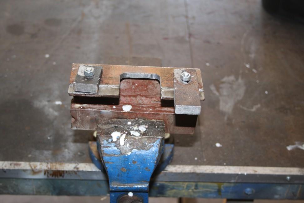

Easy enough to do....
I made a jig from some 40*40*4mm angle...About 6 inches long. Cut an elongated hole about 20mm wide in the middle of one of the limbs, this is where the 2 halves of the blade will be placed..
Make a couple of clamps from an offcut of said angle and place around 1.5 inches from the central hole/opening.
Grind the blades to form a chamfer across the width so that when the blade ends are placed one on top of the other the ends meet with no step...Assemble and clamp onto your fixture and silver solder...Dress the joint to ensure the blade contour is uniform..

« Reply #4 on: January 22, 2013, 09:01:23 PM »
Heres a pic of my home made clamp for joining bandsaw blades. Since the photo was taken I have reduced the size of the long clamp using the rejoined bandsaw blade

« Reply #5 on: January 22, 2013, 09:25:27 PM »
A trick I read about recently to get scarves that match perfectly is to twist one end of the blade backwards (teeth face away from each other) and lay them on top of each other, then grind your scarf with both of them together.  This makes sure that both are exactly the same angle.
I just cut a V-notch in a piece of angle and clamped the two ends to that.  The notch gives you room to do your brazing and the angle keeps things lined up.
-Sparky
