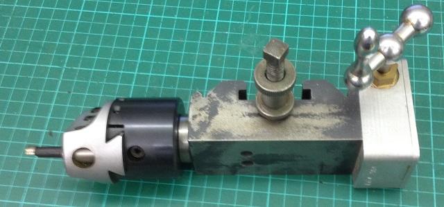

There seems to be heaps of threads on ball turners on the forum but not much said about using a boring head to do this. So here is one set up to fit on a BXA tool post.
When I bought my boring head, I bought an additional straight shank mounting flange for it. It had a 20mm diameter shaft. I bought a pair of 42mm x 20mm x 12mm bearings which only cost $5.50 each. The body is made of aluminium (from 50mm x 100mm flat bar) and the handle is 12mm steel. I found some plans online but I had to redo them as they were for a CXA tool post.
I improvised with the height adjustment  over the weekend for now and used a washer sandwiched between two nuts and I was able to centre it OK. You only need to do this once and is pretty easy. It is just a matter of adjusting the height until the tool touches the top and bottom of a piece of round stock in the chuck.
So drill and tap the end of some bar stock, part off the piece so it is the same length as the diameter and go for it!
Just wind the tool in gently and take your time with small cuts.
Umm... loosen the ball before you polish it as it was very hard to get a grip to unthread it from the mandrel (just use any old bolt the right thread)

To polish it, with the lathe running at 500 rpm, I started with 240 grit sandpaper  and moved up to 400 wet and dry kept wet with some kerosene. Then moved up to 600, 800 and 1000 grit (with kero) before the final polish with Autosol metal polish which you should be able to get from a car accessory store. Looks like chrome!
I hvae yet to try a concave radius but it should still work just by turning the cutter round the other (I mean right) way.

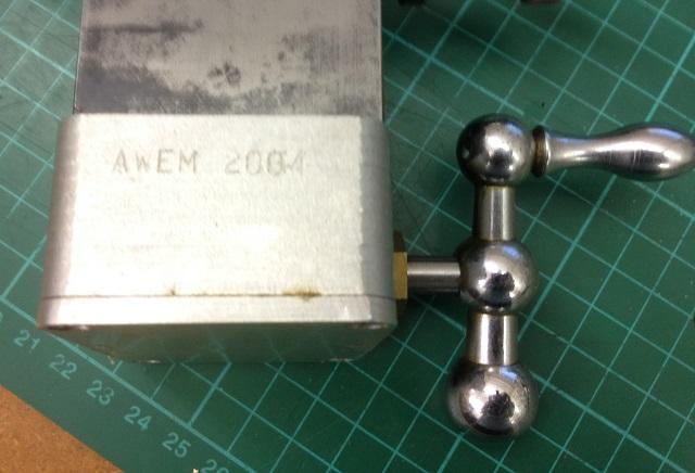

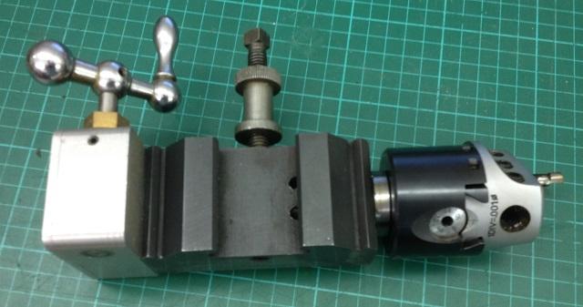

« Reply #7 on: April 28, 2014, 12:37:41 PM »
I made a ball turner using a boring head quite a while ago - just dug it out, 2004 according to my stamp on it, so ten years ago  :bugeye:
Mounted on a Dixon T2 quick change holder with a custom made 90 degree worm & wheel. I seem to remember the holder started life as  a N0 2 Morse socket, which I softened, and parallel bored to take the boring head spindle. Can't remember if I re-hardened it  :scratch:

Awemawson,  you have given me an idea, I should date stamp my accessories. I also have a logo stamp I got made to brand a particular part I make but when I  polish stuff like the balls shown,  I just can't bring myself to use it! I put quite a long handle on this tool (12" or so) to give me some control of it, I think I could have made it shorter but so far, I don't see the need to add a gear train to a simple tool.

Rod,
The idea of the 90 degree gearing was to allow reasonably accurate 'partial arcs' to be turned, both concave and convex. The handle variant will do the same if you add stops to it.

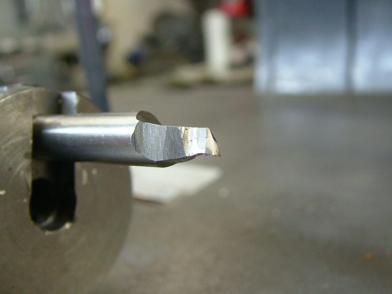

A boring head for ball turning I find one of the most satisfying tools to use in the workshop lots of feel a real hands on tool.
Personal preference for cutting tool is a round nosed HSS tool with 4 - 5 deg top rake,  6 - 7 deg front rake  and used upside down of course.

Can someone pleases explain to me the geometry of the cutter. For the life of me I cant see how this can work, it obviously does,
It  just seems all wrong with the cutter operating vertically as the cutting edge would be 90 degrees out.
Regards
Dave, I put the tool in the opposite way to what you would use for boring. On one cut it is using the back of the tool but it works. Some people have made up a custom tool with a better profiled insert tip for the job in hand. I might do that one day.

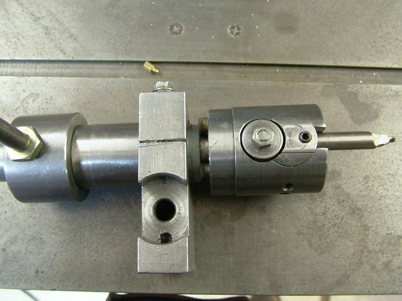

Hi can I add to this earlier posting
""Personal preference for cutting tool is a round nosed HSS tool with 4 - 5 deg top rake,  6 - 7 deg front rake  and used upside down of course.""
This will produce a very good finish on Stainless steel aluminum an mild steel. Take fairly light cuts and use cutting fluid.
I remove the toolpost and bolt the Ball Turner - Boring Head in is place.
Just an idea that this may help for the smaller lathes.
The Housing was bored with the boring head mounted in the chuck so it is on the Centre Line.
A couple of photos show the boring head built from plans in "Model Engineers Workshop".
