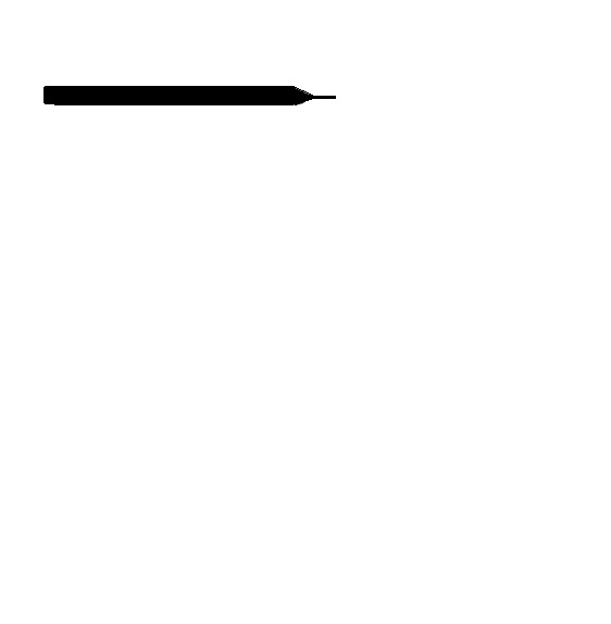

Help! I cannot remember how to set up my lathe to turn a taper. Back in college I has to turn a 60° point on a plumb bob...
Now I need to turn a .205" rod with a 45° taper down to a .045" pin that's .375" long. I remember it wasn't hard but not the setup.
My search foo has been weak and I can't find out how to do it. :(  Any help would be greatly appreciated!

 Rotate the compound to the desired angle and use the crank on the compound to the finished dim's. I am not sure what the part should look like, but I think the point is .045 dia. by 3/8" long at a 45 deg. on a .205 rod?

Hi Paul... Yep!  Like this picture... except turned, not drawn in MS Paint, LOL!
I guess my question is, which way do I rotate the compound?  Mine is almost always set at 29.5 degrees for thread cutting (the handle is back and right).  I'm thinking it needs to be on the back and left?

If you say you need a 45 degree taper - is that the inclusive angle, in other words if the piece was purely turned down to a point on the end and you held a square against the point it would only fill up half of the square ? - from your drawing it appears that is what you want.
If so, you need to set your top slide to half of the angle offset to turn it (22.5 degrees).  Setting your top slide at 45 degrees will give a 90 degree inclusive angle.
From your comment that your top slide is set normally to 29.5 degrees for thread cutting, it appears that your top slide scale is marked to read 0 when the top slide travel is parallel to your cross slide travel and thus square to the stock in the lathe... If this is the case, you'll actually have to set the top slide to
a)  67.5 degrees with your top slide handle to the left front of the lathe.
