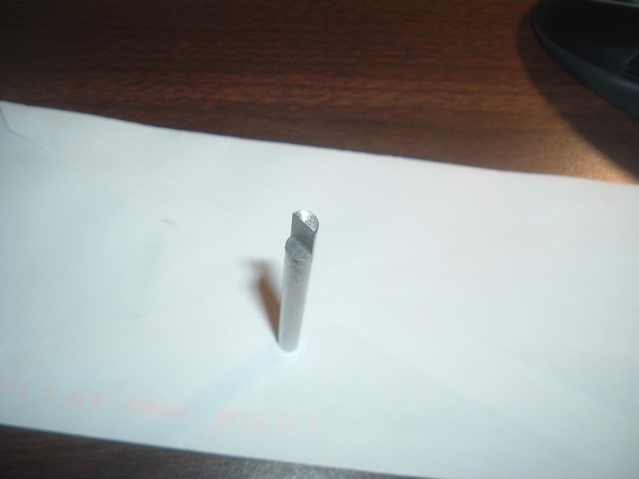

 I need to make a 'D bit' to ream a bearing for a connecting rod. I purchased 1/4" O1 drill rod for this purpose. This is my first "D bit", as well as my first reamed hole.
I cut a 3" piece, chucked it in the lathe and faced the ends. Next, I placed the blank in my mill vise on a paralell and attempted to mill to 1/2 the diameter. I touched the mill cutter to the top, zeroed the Z axis DRO, and lowered the Z axis to .125, locked it, and milled the blank for approximately 1/2". The bearing is 1/4" thick brass. When I removed the blank from the mill vise it measures .118 on the "D" part. Is this going to work? How critical is this thickness to the accuracy of the reamed hole? Do I need to try again?

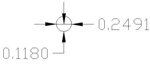

Hopefully this "sketch" of the end view of the rod will help:
If you start with a rod that is .2495" dia and remove a .125section so the remaining thickness of the D is .118", the diameter of the flat on the D will be .2491" as opposed to what I previously posted as I "assumed" a diameter of .2500" as the starting diameter.

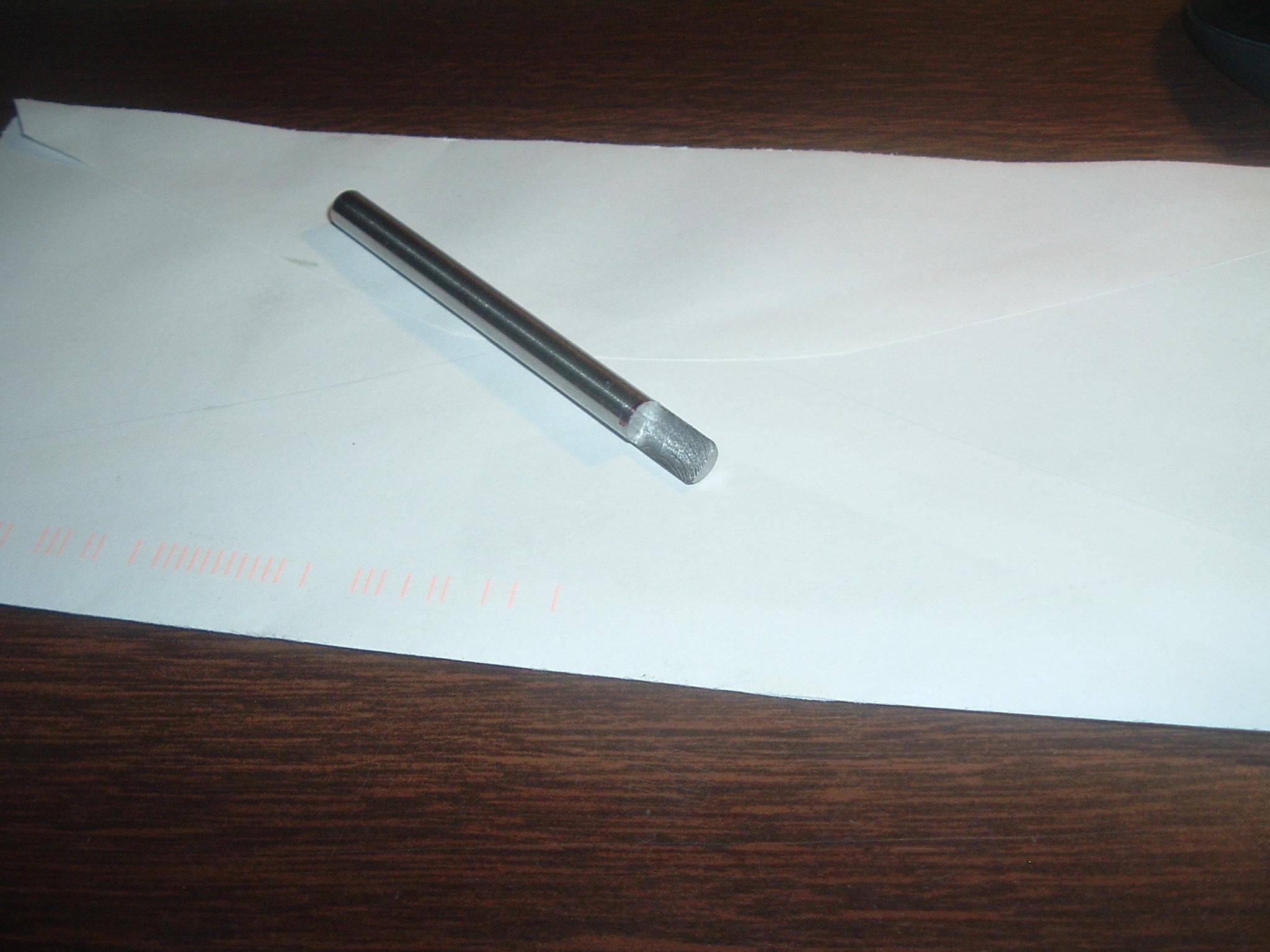

Andy I did just that. Mistake #1, I tried to harden the reamer in water, and didn't test it with a file. I tried reaming an 15/64" hole and distorted the reamer. I did ream a 'D' sized hole(.246") and it was a slip fit for another piece of drill rod, so I'm close. I also made a reamer with a beveled end and it worked better. I'll try again tomorrow with both styles, but hardening in oil and testing the hardness first.
