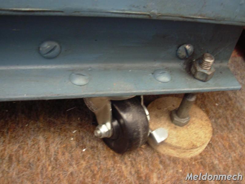

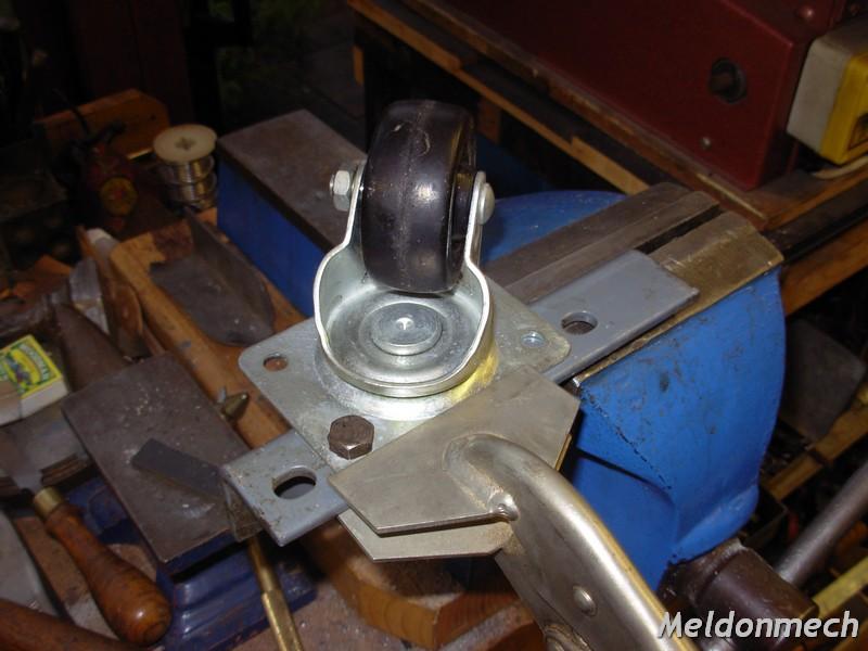

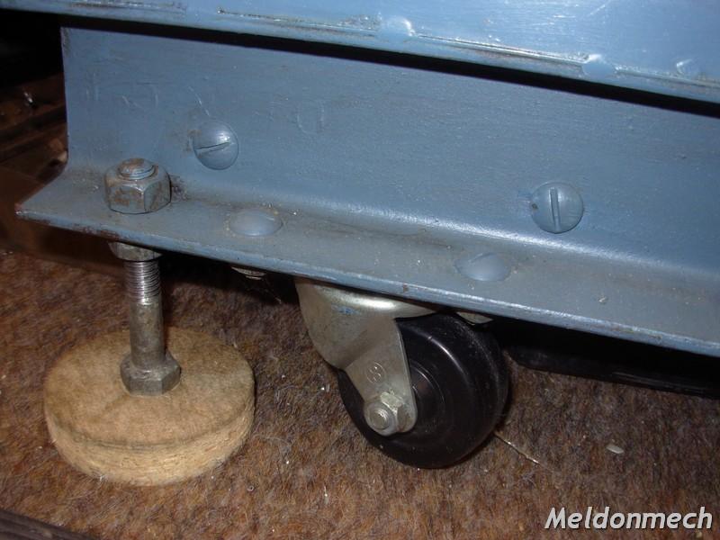

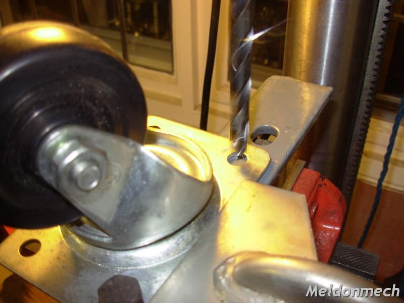

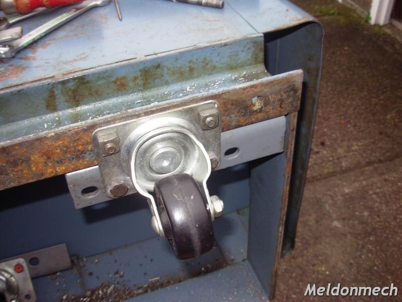

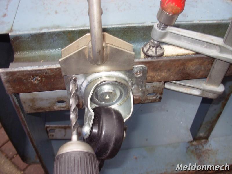

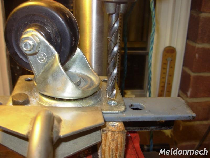

The lathe was partially dismantled to enable it be carried in an estate car. Two journeys later it arrived at my home. I hired an engine crane to unload, and transfer the beast into the workshop. I stripped and cleaned all components then , then filled paint chips and rubbed down. Got the paint matched and hand painted the machine. The lathe was to be sited against the workshop wall, but the machine was designed to have swarf removed from the back. I needed to be able to move the lathe on my own so decided to fit casters.
                                                         The base channel girders were too narrow so they were widened using angle.
                                                                                  David

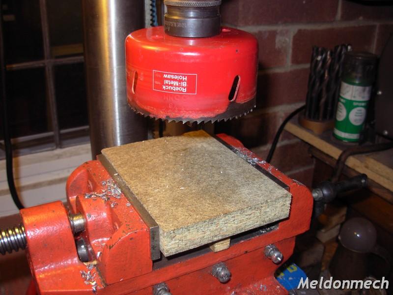

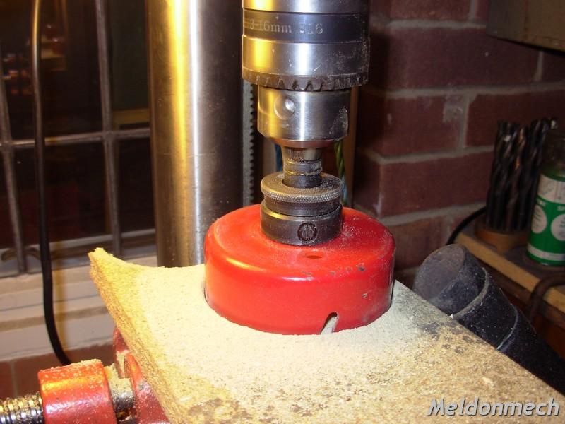

Pads for the leveling feet were cut from flooring grade chipboard, a concave location was turned in each pad to locate the spherical shaped head turned on the leveling screws. The screws were  fitted and the lathe leveled.
