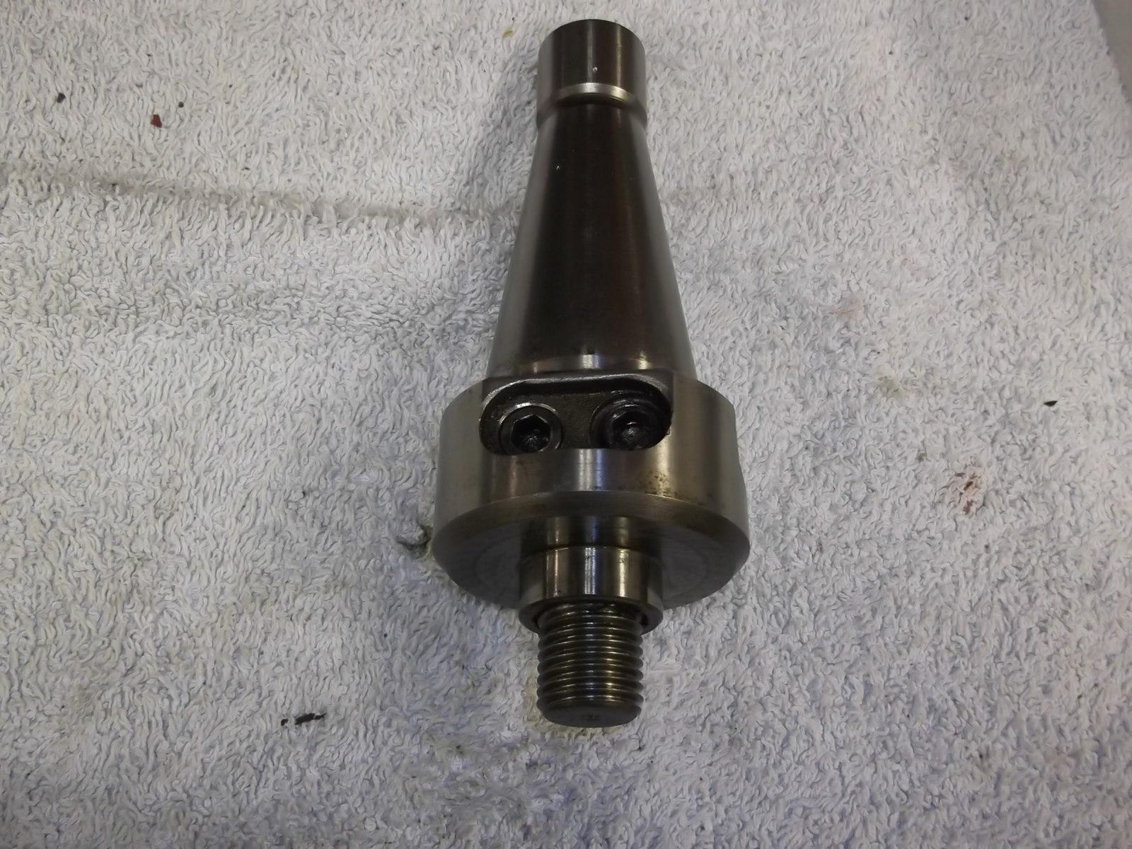

Right thats Christmas out the way  :coffee:
I have a couple of BT30  collet chucks ,no collets and no closing nuts ,so i was thinking about making use of them by turning them into fly cutters , My question is what is better the disc type or the arm type ? any thoughts on the subject lads .
Cheers Rob

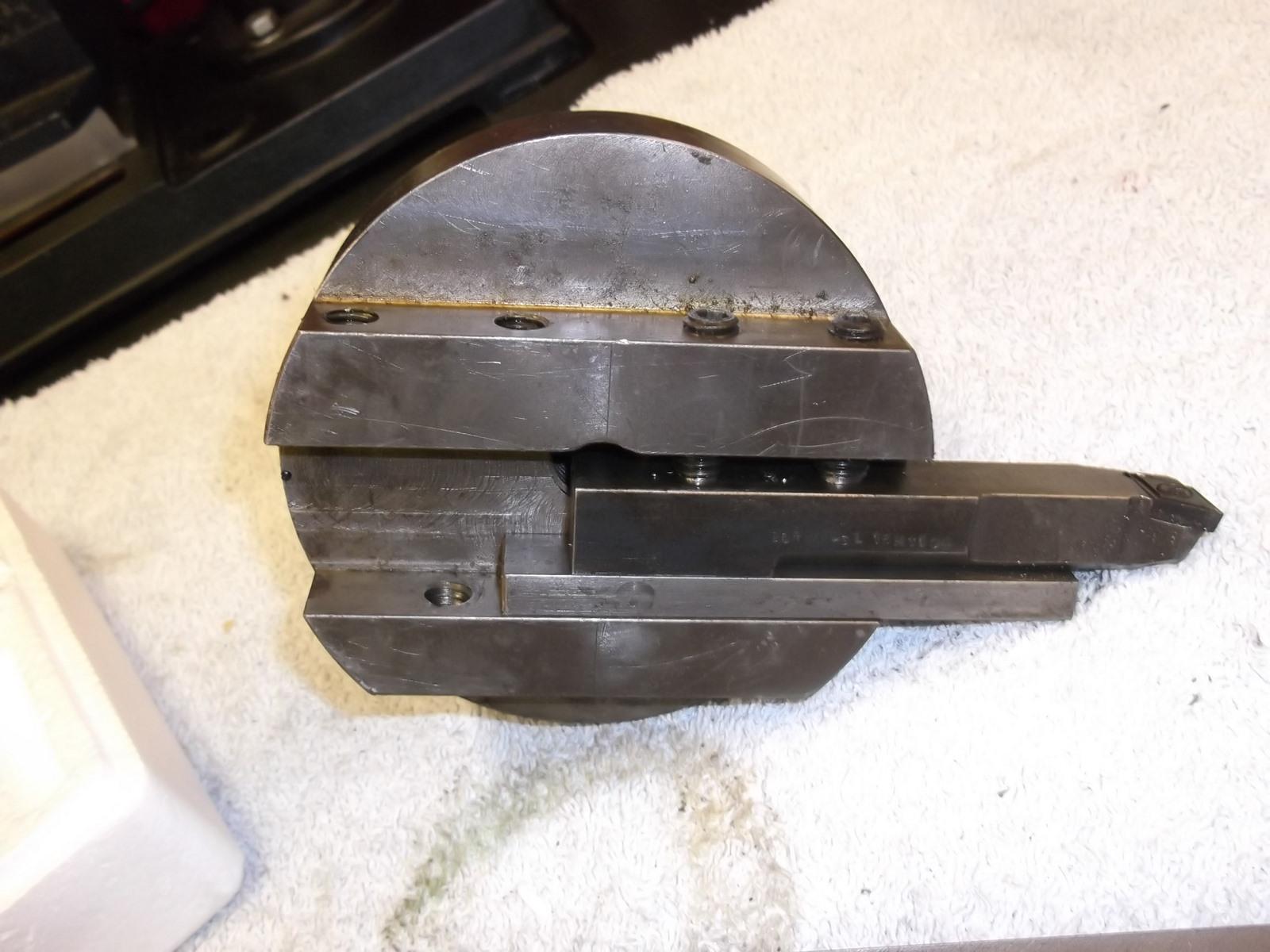

Hi Rob
              I was recently in the similar position when needing a fly cutter with a much bigger sweep and decided to make one.  I find the disc type does cover the work piece and make viewing the way a cut is progressing more difficult. I wanted my cutter to be robust and adjustable, I thought making the disc type adjustable would be more difficult, so settled on one I had seen in a pic. somewhere. The result is shown in a couple of pics in this forum, TOOLS > Band saw broken vice ( update ).
                                                            Cheers David
Re: Fly Cutters
« Reply #3 on: December 25, 2012, 08:15:29 AM »
Cheers for the replies lads  :thumbup:
I think I will go for TCT , I like your adjustable fly cutter David ,that would save making two  :med: ,had a quick look on the web and found this one .

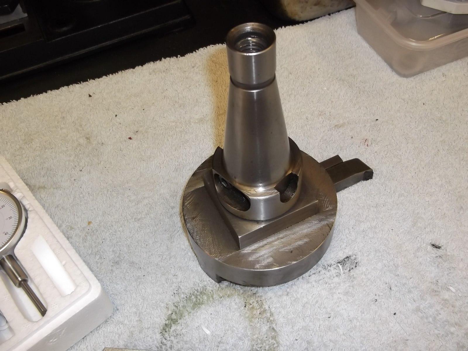

Hi Rob,
Funny you should be thinking of an adjustable fly cutter.
I'm in the process of utilizing my adjustable fly cutter for another purpose, namely a tram.
I bought a couple of cheap 1" dial gauges, had a bit of bar that just needs drilling and splitting for clamping.
I use a purpose made cutter both for skimming brake discs in the lathe, and then use it in the fly cutter on the miller for skimming heads.

Re: Fly Cutters
« Reply #6 on: December 26, 2012, 04:54:49 PM »
Hi Chris  :thumbup:
I am going for the bar type , no actual machining done today , hopefully I will get some shop time tomorrow  :ddb:
I did crack out the Etch a sketch today and doodle up the tool holder .So it wil look something like this .I HOPE!

Re: Fly Cutters
« Reply #7 on: December 27, 2012, 03:40:59 AM »
Hi Rob,
I like those illustrations, what program do you use to get such impressive detail, I have to struggle along with AutoCAD, the free version..... :)
The square on the top of my fly cutter allows me to hold it downside up in the machine vice, and then hold items in it, usually to make indexable cutters to whatever profile needed.
I try to make tools multi use.
