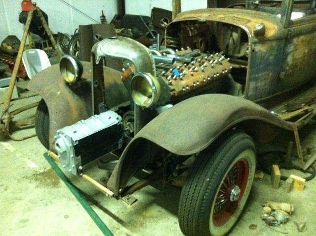

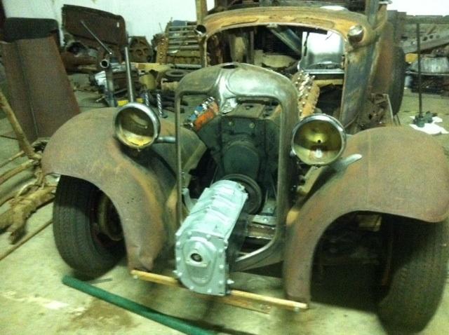

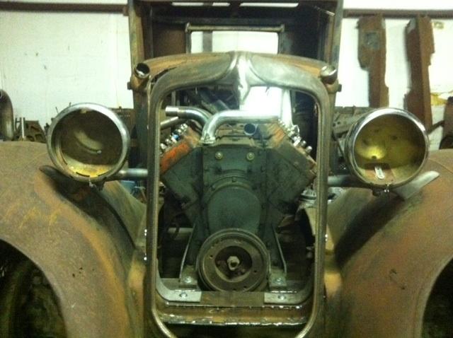

Need some design help.

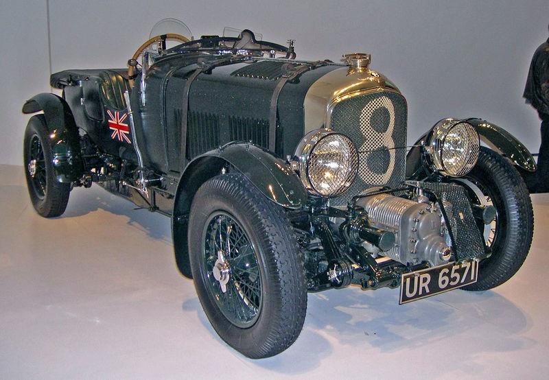

I'm building a somewhat customized '32 Chrysler 3 window coupe. The powerplant is a 1934 Pierce Arrow designed 462ci V12 and came originally from a 1941 Seagrave firetruck. I've mounted a 6-92 blower (inline 6, 92ci per cylinder) in line with the crankshaft of the engine to be driven from the crank directly.
This is very similar to the design that the blower bentleys used in the late 1920's and the Potvin design from the 1960's. I don't have many blower bentleys around to study and copy designs from and the potvin model was based on a custom timing cover and a rigid mounted blower. My intent is to make the blower somewhat flexible mounted from the engine, allowing for some movement.
What kind of linkage / flex drive could I put between the crank and the blower?
For reference; operating range will be 800 to 3,200 rpm and the engine with the blower and injection will put out in excess of 500 ft lbs of torque.
And as this thread is useless without pictures I've added some, the bentley is from the collection of Ralph Lauren, the others are my project.

Joe, that's a great idea, but I think those are a little too long? I've only got about 4" of total space between the blower snout and the face of the balancer on the crankshaft. If I move the blower further out it will hang out beyond the fenders and past the bumper.

« Reply #12 on: December 18, 2012, 01:56:37 PM »
I'd seen that coupler, it goes between the shaft of a small (really a baby) supercharger and the pulley where the belt drives it.
My supercharger is MUCH bigger (read more torque required) and does not have a belt, the main shaft of my supercharger is lined up with the crankshaft of the engine (low and in the front) so I need a straight through coupler. The engine will be mounted on rubber bushings, the supercharger will be mounted to the engine, with a rubber mounted support on the rear. The overall length of the setup, from rearmost engine mount to supercharger is 7 feet, with rubber mounts on both ends and the front of the motor (~4ft from the back) I don't think I have the space (or the weight) to rigid mount the supercharger. So a slight angular and linear misalignment may occur under heavy load or acceleration.
The conventional pair of universal joints would be great, but not enough space for the ones that can handle the load, so I need something a bit more elegant. Some of the earlier posts have good ideas that I'll build as a prototype sometime soon once I get back to the shop.
