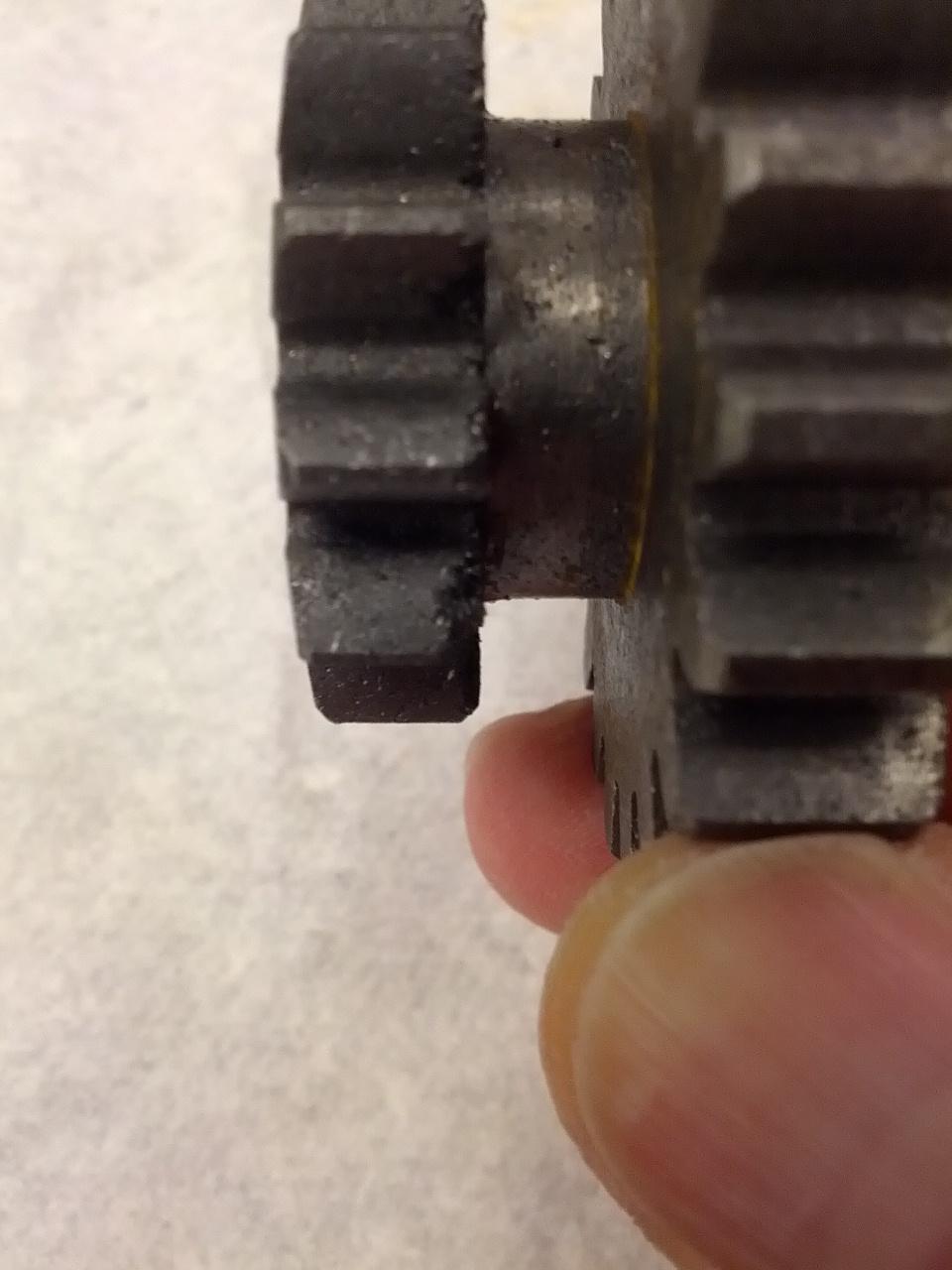

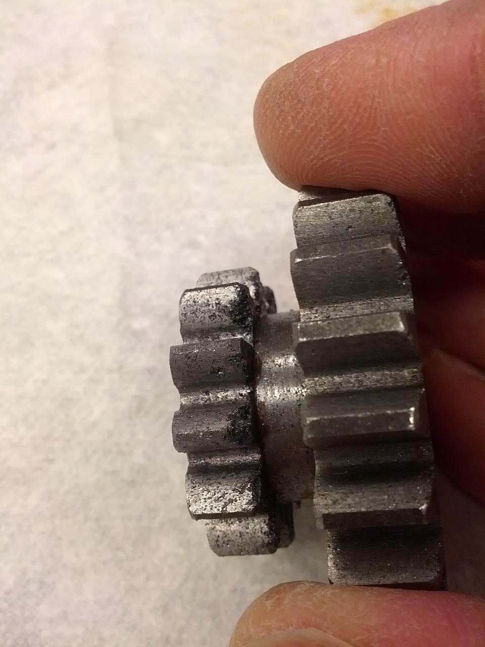

I received my metal gears today and cleaned them up. I'm distraught over the quality of the teeth on the small end of the intermediate gear.  Are they all this bad? I'm worried they are going to break or destroy themselves under load. Or am I concerned over nothing?
« Last Edit: December 05, 2012, 05:04:15 PM by SLM »
lordedmond
Send em back they look bad
looks to me as though they are full of porosities and junk
just my opinion other may say OK
Stuart
Seconded, Stuart. I wonder if this is a rogue set which keeps being returned, but the seller keeps sending out again in the hope that someone will accept them.
If bought by Ebay or Paypal, start a dispute if you can't get them replaced, or a refund.
If you bought them from Little Machine Shop, I'm sure Chris Woods will be more than happy to replace them.
Offline SLM
  • Posts: 18
Thanks guys! If this was "normal" I wasn't going to sweat it.
I called LMS and Chris is going to send me a new gear.  :clap:  Back to waiting a bit but better safe than broke down again!

Had an overnight think.  :scratch:
The tumbler gear position, must be in working alignment with it's mating gears. The corresponding position of the locknuts doesn't matter.......  :thumbup:
Offline SLM
  • Posts: 18
Ah, good point!  All those bits are still scattered around the basement, I never thought of them. I guess the best way then is going to be to rig those back on and measure.
It looks like the optimal OD for the spacer would be 1.750" as the1 1/2 is still smaller than the bearing but it isn't available locally. I'm sure it will be better than the 1.500" stuff though!
