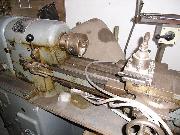

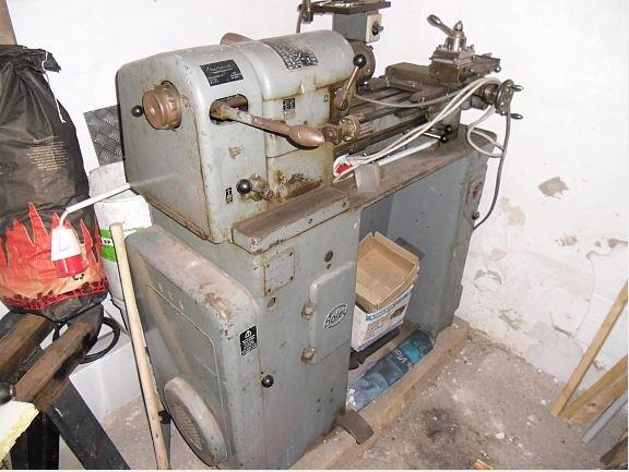

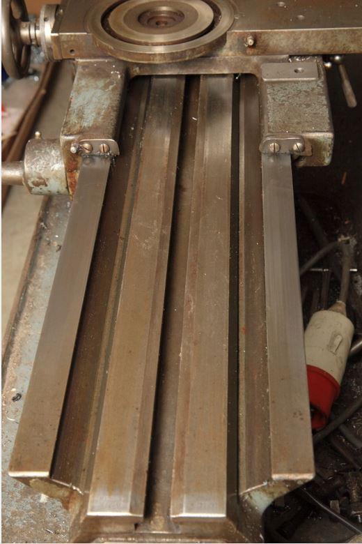

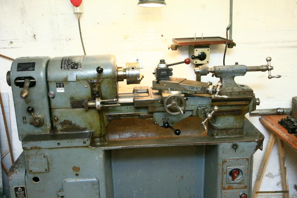

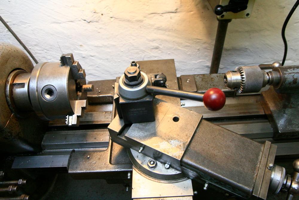

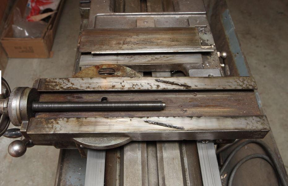

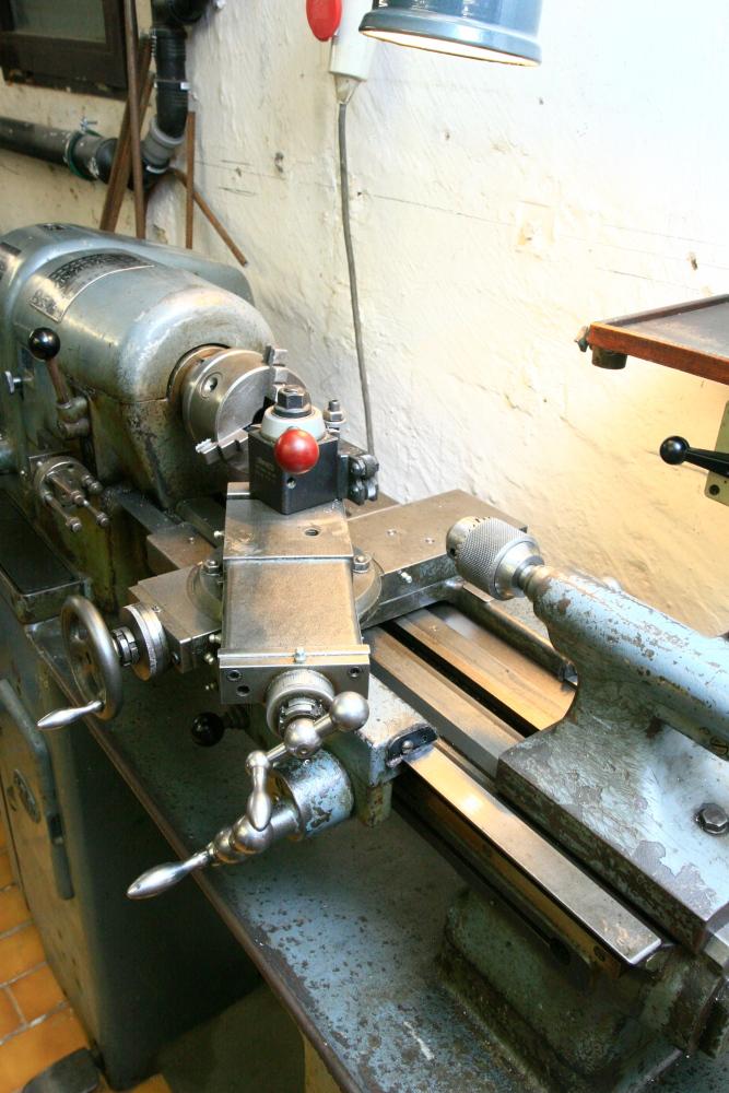

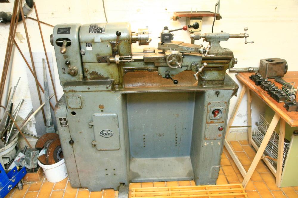

Bought a Boley 4L lathe today.
Beautiful piece of quality engineering. Considering it only cost the same a new 320lb Chinese 9x20, it was a steal. It is a 9x18 and weighs 780kg. It is on the optional heavier gL37,2 cast stand. The bed ways are easily as wide as the center height, and the saddle length is about 50% the bed length.  The spindle speed range is 71-1800 rpm in 12 steps, and I will probably run it off a VFD which will increase the range further. The headstock looks identical to the 5LZ which went to 3550rpm standard. The spindle runs smooth as silk.
There is one decent chip out of the bed (about where the cable is lying in the photo) , but otherwise the general condition seems really good.  Paint is original, and there is only very light rust on a few surfaces.  The test cuts I did gave the impression that the thing could turn a tenth off krytonite.
There is no obvious thinning/wear of the saddle or cross slide leadscrew threads, and little backlash. Everything was a bit dry, but I cleaned up the bed and put some lube on it and it runs like silk. I'll order some proper way and spindle oil off ebay for it.

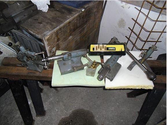

Both crank and lever tail stocks, and the fixed and traveling steadies are with it. No other chucks or collets. It supposedly has a weird M39x3.5- 55° threaded nose. I'll have to get a 4 jaw, and will probably cast a face plate and ER32 collet chuck. But I'll also be keeping an eye out for W23 358E collets on Ebay.
This model doesn't have a thread cutting gearbox. It is designed with the leadscrew protected from swarf under the bed under the bed.  Feeding and threading are both with change wheels. Only the two change wheels currently fitted (50/55) are with it. However it does have the optional fine feed gearbox. The rest of the change wheels are lost. I will probably CNC it, as that will be cheaper and easier than tracking down a set of change wheels, and I have had lots of fun with my CNC's 7x12.
Don't take possession of the house for another few weeks, so the seller kindly agreed to store it for me through into January.

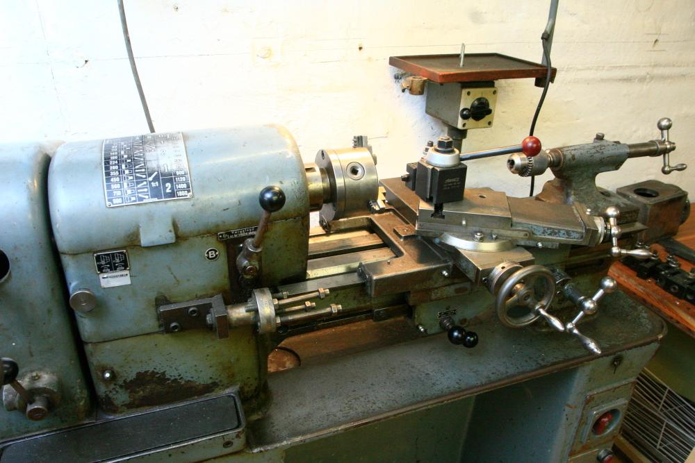

Some more photos from the Boley...

If I CNC the 4L, it will be a  reversable change (as it is on the 7x12). I am not sure if that is the path I take with the 4L though. I just talked to my dad and he has a spare set of change gears he was given a few years ago. No idea what machine they are off, but if the size is near enough, and bores are small enough to be bored out, then I might end up adapting that set (if he brings them over from NZ in summer).
The 4L is a very simple machine. This makes it ideal for CNC, as all the wonderful mechanically tricky features which make something like a 5LZ or 1EE so cool, becomme redundant once a computor spins the wheels.
Remove the 4L lead screw, and install a ball screw mounted on bearing blocks and a nut carrier which pick up the existing mount holes.
Same for the the cross slide.
Top slide is replaced by a tool riser block.
Two inductive sensor, one the spindle cog for rpm, and another on a 1/rev feature for indexing.
The T-Slot for sliding stops on the bed will be excellent for mounting limit and home switches.
The motor is a standard, industrial, flanged motor. It is only .75/.9k. I am not sure if the place I bought has 3ph in the cellar. If not I will probably need a 240 3PH motor, and will run it off a 1PH -> 3PH VFD like I have my current lathe.
Pekka, 1/rev indexing worked fine under T-CNC. Since I swapped to LinuxCNC (EMC2) I only have the index signal set up to provide RPM indication and havent done any threading.
On a CNC lathe, you can cut the thread with dozens  of light cuts, and at much higher spindle speeds than you would comfortably do manually, so the spindle doesn't really load up or slow down enough to make a significant effect on thread accuracy (obvious it depends on the desired accuracy). I have cut two M40x1.5 (er32 collet nut) threads on 7x12. It was just on the wrong side of the machines capacity, and turned out ugly on one, and worked on the other.
I think you only need a Px oiling system if you use the mchine for hours each day. I just squirt oil on the ways and screws regularly (like every time I use it). Given the cost of 7x replacement parts, it is probably easier just to replacing things if they start getting worn.

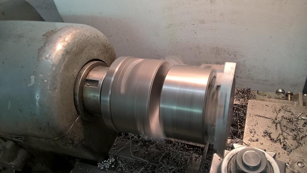

This spindle is based on a right angle reduction gearbox I picked up from the scrap dealer.
http://www.cnczone.com/forums/attachment.php?attachmentid=105471&d=1271620622
There are cover plates which bolt on both ends came with a bunch of nice shim. Doing the bearings this way seemed like I could use the shims to easily set preload.
Mark

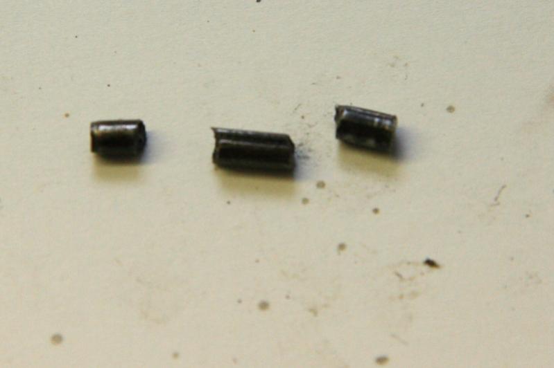

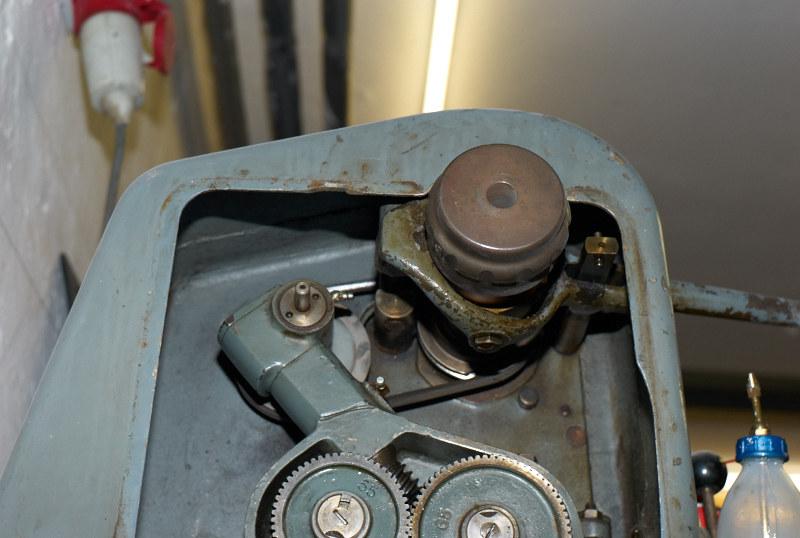

I managed to shear off the spindle lock pin, by trying to unscrew the chuck with a big Lever, without engaging the back gear.
The torque would have been around 750nm, and went straight on to that pin. The back gear would have reduced that by 3.5x.
I made a new pin, and fitted it.
Mark

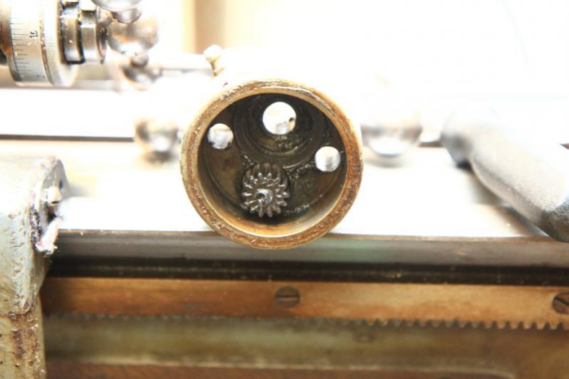

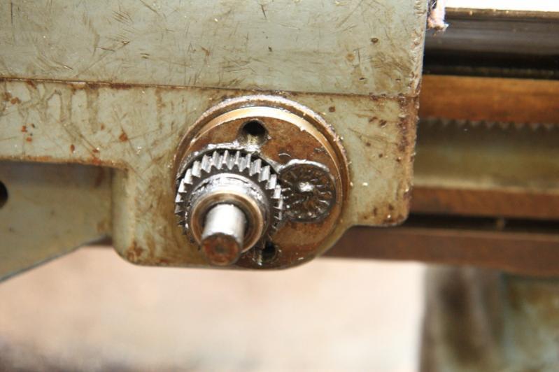

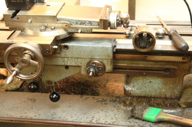

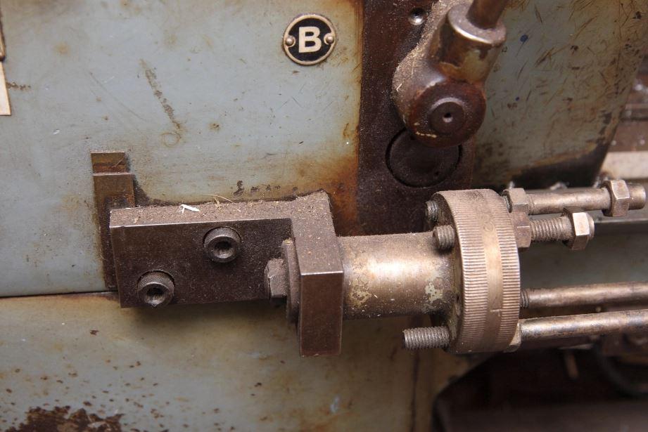

There was a excessive play in the carriage drive, as in 180° of handle rotation. The drive handle has an idler to change rotation directions, and the roll pin to fix it to it's shaft was severed in three pieces. I doubt the roll pin was original. This lathe was what is referred to in German as a Fettopfer, a grease victim. It was designed for all these mechanisms to be regularly oiled.
Made a new pin for it which has cut the play dramatically. Once I have the backing plate for my Bison 125mm four jaw independant chuck, I will Mount that housing, bore out the slogged out shaft bore and bush it.

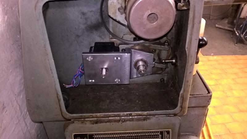

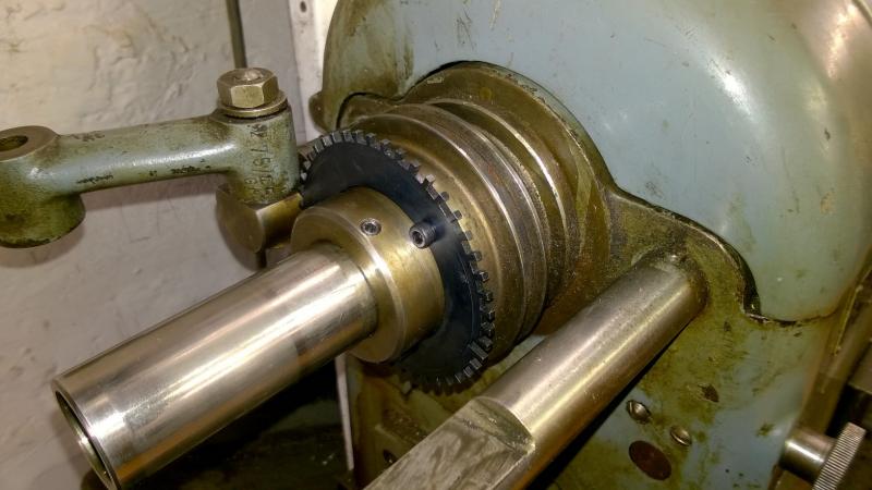

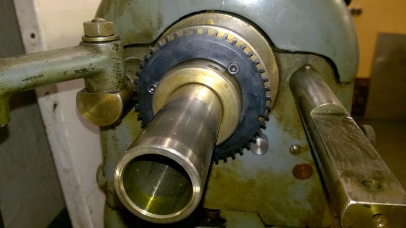

As there was no change wheels with the lathe when I got it, I hae not been able to cut threads. I missed out on a set of Change wheels which failed to sell on Ebay.CO.UK. The seller had sold them cheap to an Artist who made an installation out of them  :doh:

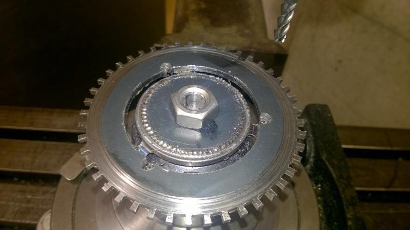

Since I have already CNC'd one lathe, I decided to do an electronic leadscrew on the Boley for now. I am mostly enjoying having a Manual lathe again, so I am not sure if I will CNC it completly.
First thing needed is a spindle Encoder. Since I'll be using LinuxCNC, it need a 1/rev indexing puls, plus a more/rev encoder signal. There are lots of ways to acheive this, but I tend to choose the most complicated. In this case I have made a steel 40 count encoder disk, with one long slot and fitted it to the existing fine feed drive pulley.

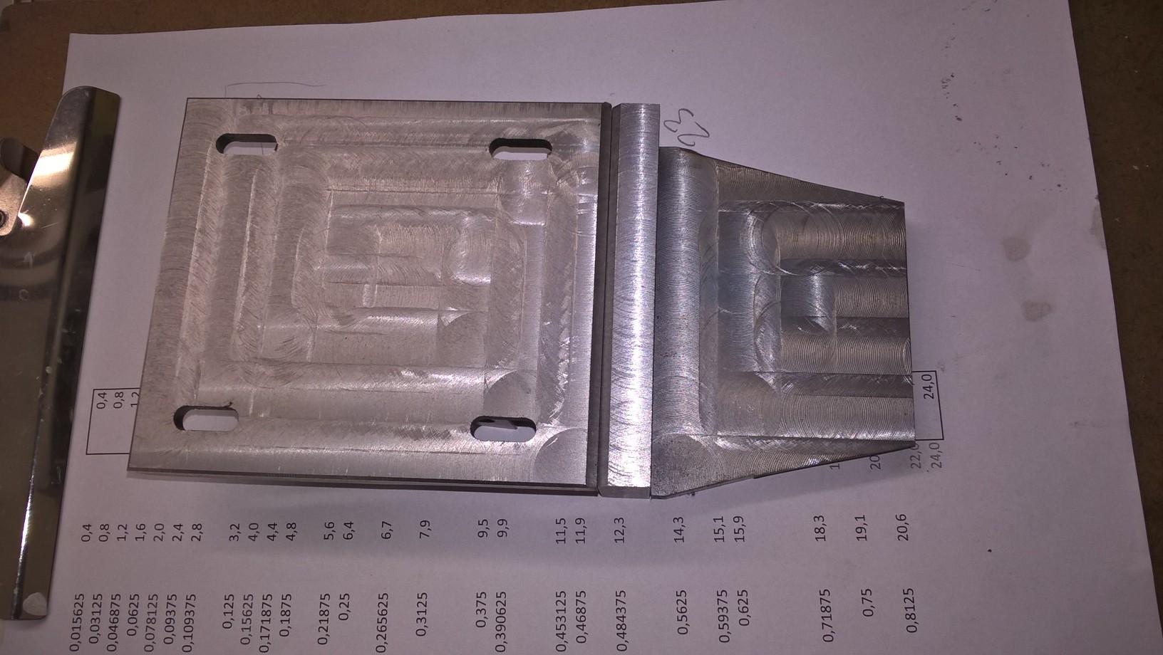

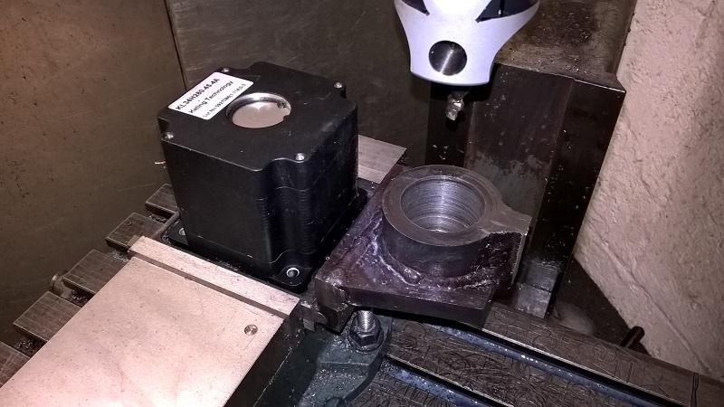

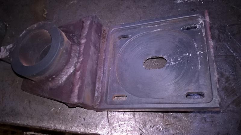

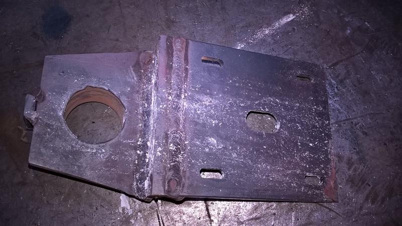

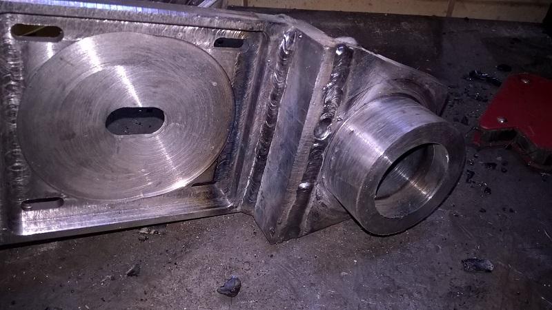

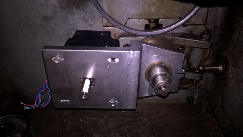

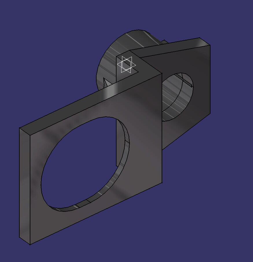

I have started making the Z Axis drive motor mount. A Nema 34 stepper will be mounted. I don't like irreversable modifications, so the mount will be the same as the existing Boley fine advance drive, which clamps onto a shaft feature concentric to the leadscrew.
Pretty painful process milling the 7mm recess for the motor on the Deckel G1L. I can only cut 0.5mm per pass.
I wonder what the Austrian Ö-Norm material number is for that shiny steel which Rob Wilson uses.
Since I haven't received the backing plate for my Bison yet, I had to mount the 100mm four jaw in the 115mm three jaw.
Mark

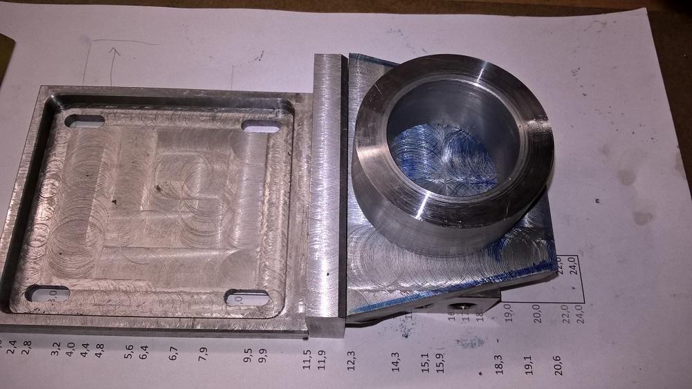

« Reply #21 on: December 02, 2015, 06:06:20 AM »
Yesterday  I stress relieved the weldment, and got started boring it out. My youngest told me to stop as it was resonating through the whole house and she couldn't sleep.
ER16 is not the ideal spindle taper for a boring bar. Not much rigidity there.  I put the NEMA 34 motor on there for scale.
Mark

« Reply #22 on: December 07, 2015, 10:32:05 AM »

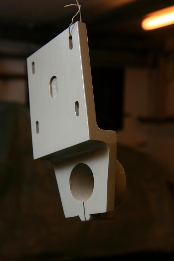

I finished boring, threading and slitting the motor mount. Went at it with a grinder to clean up my ugly weld practise also.
Mark

Today I undercoated the motor mount.
