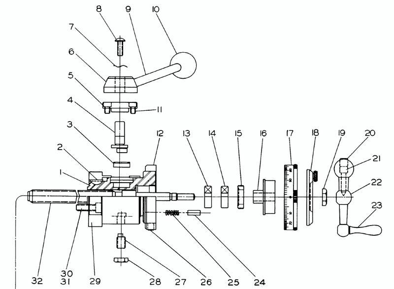

It'd be worth considering a quick retract function as fitted to Hardinge and other tool-room lathes (very useful for threading).
[edit] see - attached diagram
The lead-screw (32) bearings (13&14), dial(17) etc. are mounted in a sliding block (1) . The sliding block moves in the mount (29) that attaches to the top slide . An eccentric lever (4) move the two parts relative to each other thus moving the top-slide by a few millimetres, another eccentric lock screw (27) limits the movement (allows calibration)
Hardinge uses two R6 deep-groove ball races back to back - I used a pair of cheap-ish ones and ground the faces to remove side play ( easier than you think :))

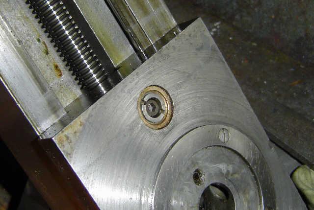

Attached are some other picture that might give you inspiration :)
The HLV-H top-slide is held on by a single eccentric 'bolt'  - works brilliantly

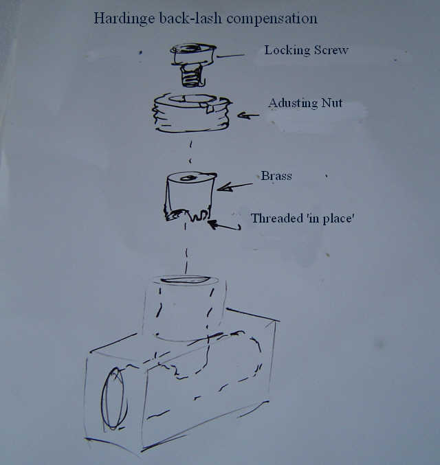

The nuts on cross & top slides have a fairly simple backlash compensation arrangement

Thank you Bill, you even add more text while I type :lol:
That excentric lock thingy looks very flat and should be easy enough (even for me) to make. That probably saves the day....I was allready into whole lot more difficult parts and fiddly processes.
And that backlash compensator looks fairly straightforward too.
But those rectactable mechanisms always put me off - I'm sure it's purely pchychological. Could it be circumvented with this flip threading tool?
