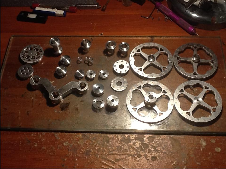

George, Great looking video I am waiting on my 3/8 plate  to make the base. I got 5 of the mag wheels done and have several more to do. I will start of the turning on the lathe this week while waiting on the plate. I will post some pictures next week.

George, Im not as far as you but here is what I have so far.

Looking good Dave.  I sure do like the heart shaped openings in the larger wheels, that really adds a very nice personal touch.
