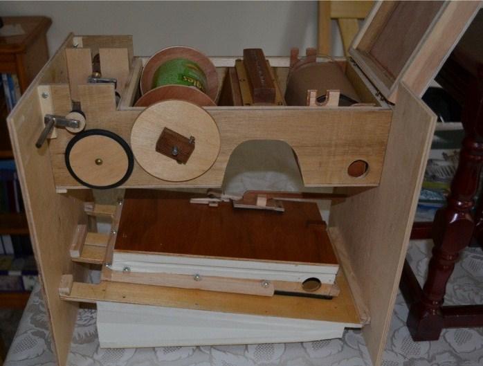

Hello guys, I'm stuck on a project and need some help. I'm making a small hand crank organ and have made an error that I hope I  can fix with some help. I made an offset from the plans to accommodate the pipes in a different layout. I though I had made the corrections to everything but as it goes I did not. What has happened is that this organ pumps the bellows off the crank when the handle is turned. It also drives the music take up roll. The connection from the crank to the bellows is to be vertical to the crank. However in my error I adjusted one end of the bellows on the wrong end there by offsetting vertical 2". I now need to drive the bellows from the offset and still drive the music from the original location. I am thinking of putting a straight shaft in the original location to supply the music. It would also supply the crank for the bellows by gearing them to each other. A 1 to 1 would be the ratio that I would need to maintain. The distance from centers of the shafts is 2" so I'm thinking of a 2" OD x .3125 bore spur gear. Here's where I need the help, I'm not sure of just what I need and where to get it. I can post pictures of the organ and help describe things as best that I can but I'm stuck right now. Brass, plastic or what ever at this point will help. I just need them to be low noise. Any ideas? Any help?
Here is someone elses organ and where I am working is to the left in the picture. If you add two more inches to the left of that crank that would give you an idea where I'm working.

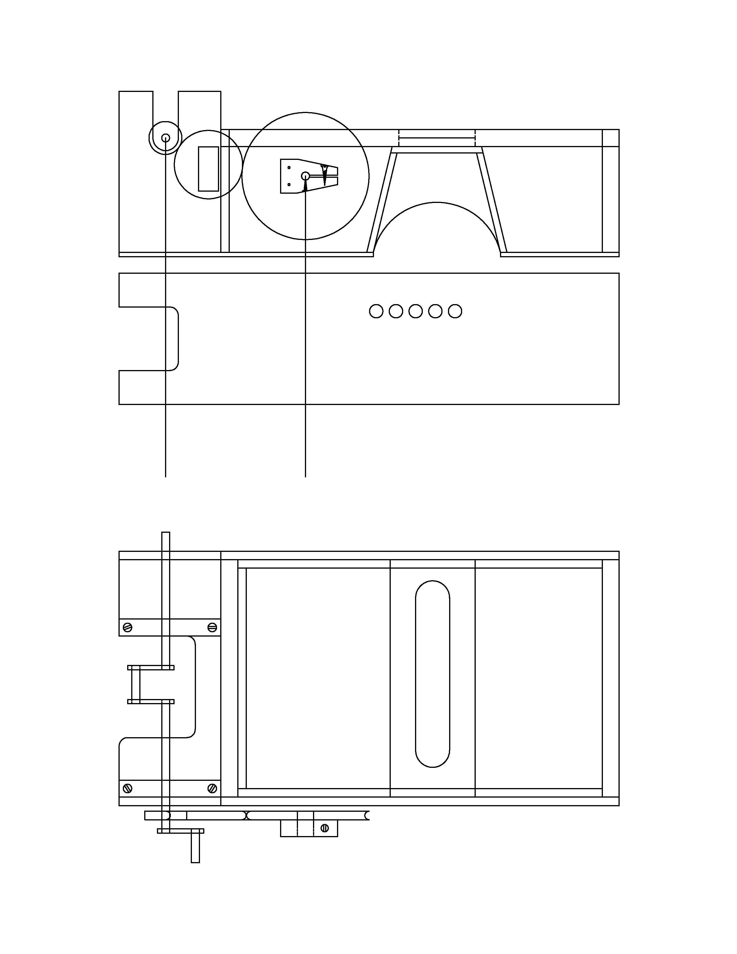

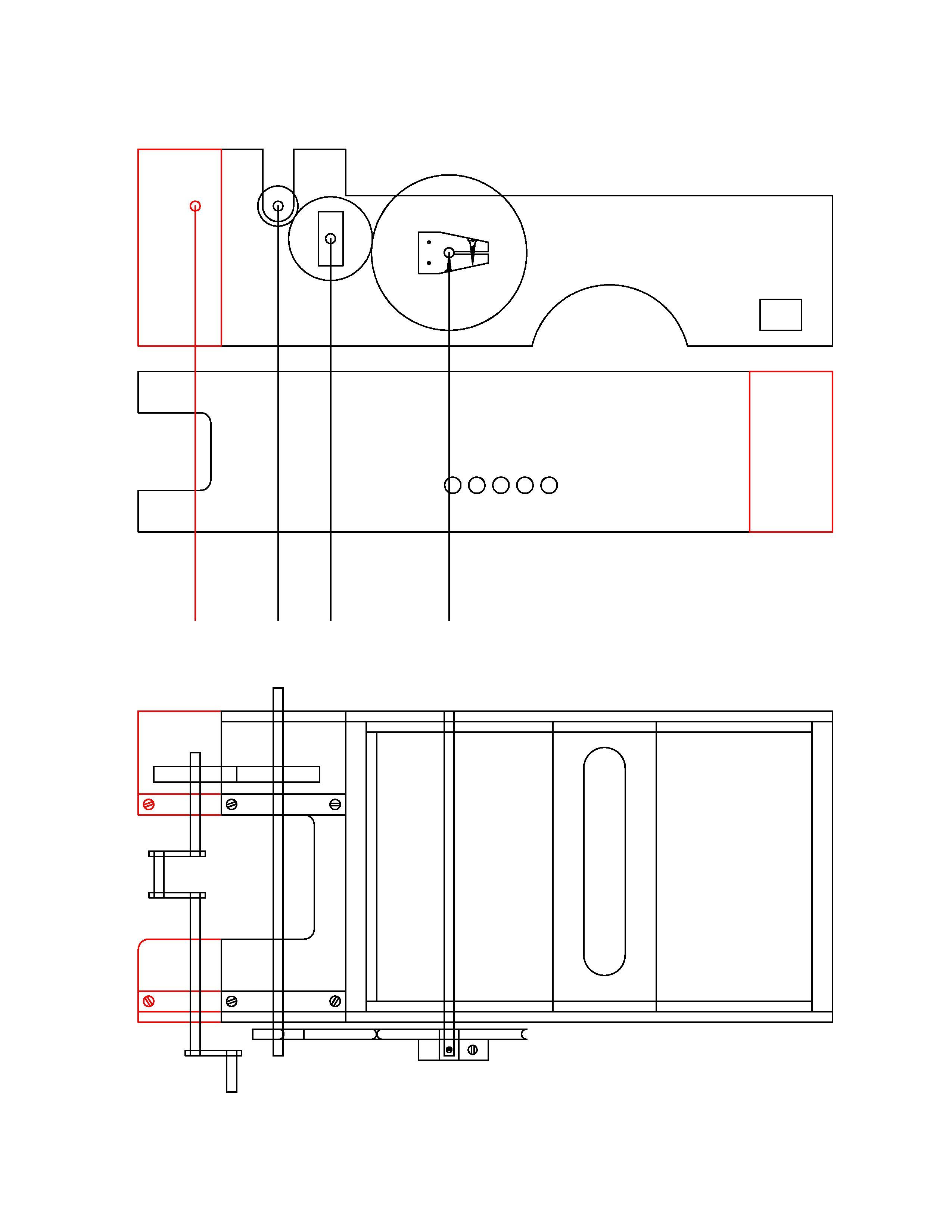

Ok here are two drawings. One all in black is showing plans from manual. I have made them into cad programs to cut on CNC. The second drawing with red shows the issue. Now these drawings need a bit of instruction. The piece with the holes in it in a line is the bellow. I didn't add them to the top down view but with the reference lines you should get the idea. I hope that these will explain it better.
The gears will be attached to the back of the case on the drawing in red. They ae in upper left corner of that piece. To the back where the shaft sticks out will be the hand crank. I hope that this helps.

« Reply #6 on: May 12, 2012, 06:05:10 AM »
Your fix should work ok. However it does reverse the direction of the handle relative to the rollers.
Given that the intermediate 'gear' is just an idler, why not just increase the size (diameter) of the gear, and relocate its axis, to span the extra couple of inches?

« Reply #8 on: May 13, 2012, 12:13:15 PM »
The idler will not change the ratios (handle to roller) at all .
If you have an inch above and below it be should be ok.

« Reply #10 on: May 14, 2012, 09:04:13 AM »
Does the idler do anything other than connect the crank and rollers? (does it drive anything else?)
If not, then the the speed of the rollers is set by the size of the Crank gear and the Roller gear -  the idler size does not effect this.
You've pushed the crank to the left by a couple of inches, so the idler has to be a couple of inches bigger (roughly) to fill the gap between the crank and roller gear. The idler will revolve slower for a given crank speed, but it will not change the speed of the roller.
If you have room, top & bottom, for the bigger idler gear the it seems like the simplest solution.

« Reply #11 on: May 14, 2012, 09:15:21 AM »
Ed,
All the idler is doing is transferring drive from one wheel to another, and reversing the rotation. It can be any size, because it transfers exactly the same "number of teeth of rotation" from the drive wheel to the driven wheel.
Consider:
Imagine your drive wheel has 100 teeth, and your driven wheel 50. So the driven wheel goes around twice for every rotation of the driver.
Now put an idler gear in, with 100 teeth. Every single rotation fo the driving wheel will turn the idler once. As the idler has 100 teeth, it will turn the driven wheel twice for every rotation - i.e. the same as if it were being driven directly.
Now put a 50 tooth idler in; the driver will turn the idler around twice for every single rotation; but the idler will only turn the driven wheel once for each of it's rotations: i.e. your 1:2 ratio is preserved.
Now put a 500 tooth idler in. The driver must turn 5 full rotations to make the 500 tooth idler turn once. And every single rotation of the idler will turn the driven wheel 10 times (500:50). So 5 turns of the driver = 10 turns of the driven, 2:1.
It doesn't matter how many idlers you put between driver & driven, or what size they are, they ratio of drive to driven will always remain the same; what WILL change is the direction of drive.
e.g. with no idlers, the driver turns clockwise (CW), the driven turns counter-clockwise (CCW)
With one idler, the driver turns CW, the idler turns CCW, so the driven turns CW.
2 idlers it goes CW, CCW, CW, CCW
3 idilers you get CW, CCW, CW, CCW, CW
and so on.

« Reply #12 on: May 14, 2012, 11:46:50 AM »
Well with replies like these it is clear to me. I had envisioned it be be reducing the speed, which it will around it's own shaft, but outside speed will travel as fast as it originally did.   :doh:  Thanks guys for the corrections. I'll look into this idea and see if I have clearance.
