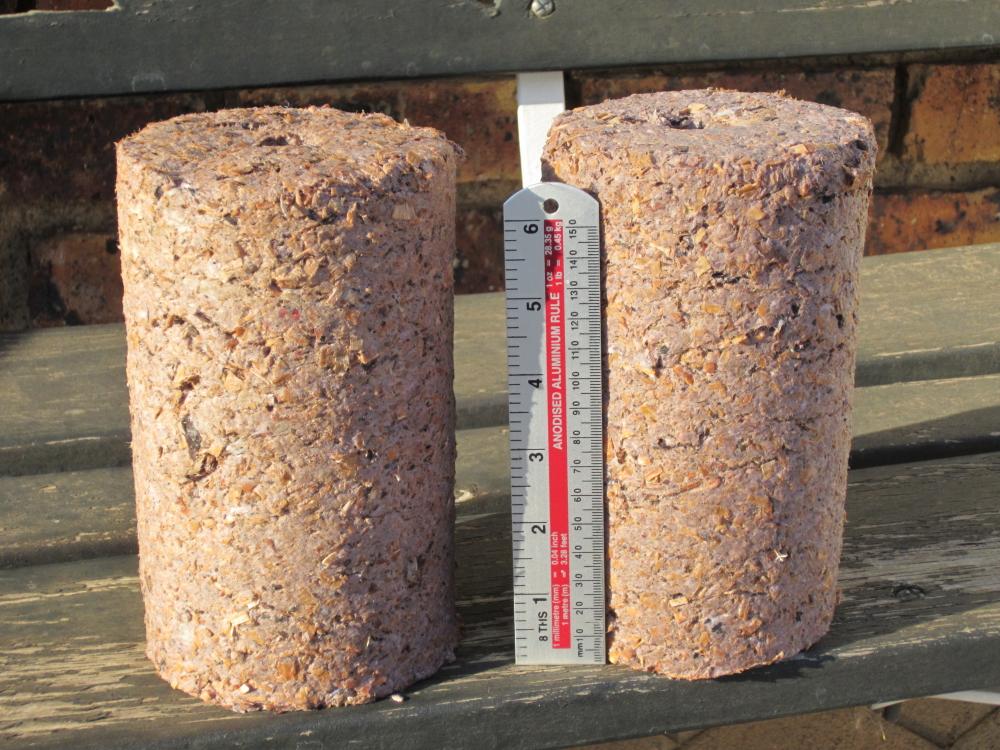

Bit of my handy work  :lol:

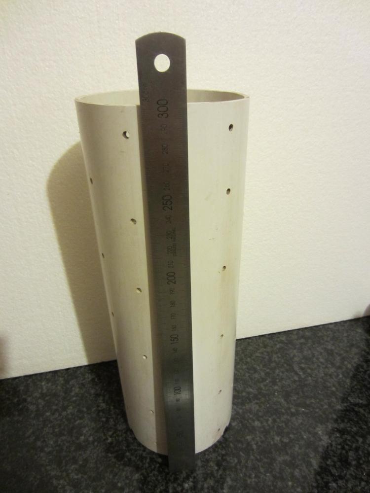

John got it 'fire logs' made from 1/3rd paper and 2/3rds wood chips. The paper is soaked for about 12 hours mixed with a paint stirrer then the wood chips are added after soaking for 3hours again mixed together.
The mix is poured into a 'mold' (plastic sewer pipe) 300mm long x 110mm dia then squashed with a 3 ton arbor press to expel the water and compress it down to about 150mm long.
They are left to dry in the sun for 4 days -  store for the winter. Just don't let them get wet  :hammer:
That's it, my greeny bit for the Planet.  :) :) :)

This is the 'mold', the holes are to let the water escape during the press.
DaveH
