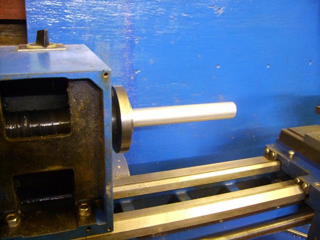

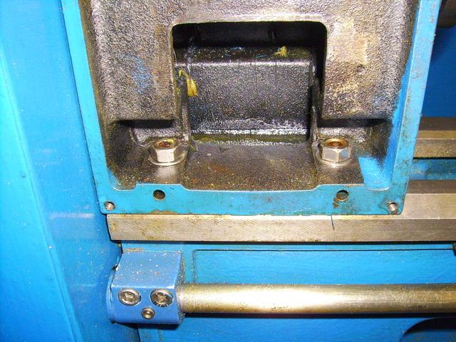

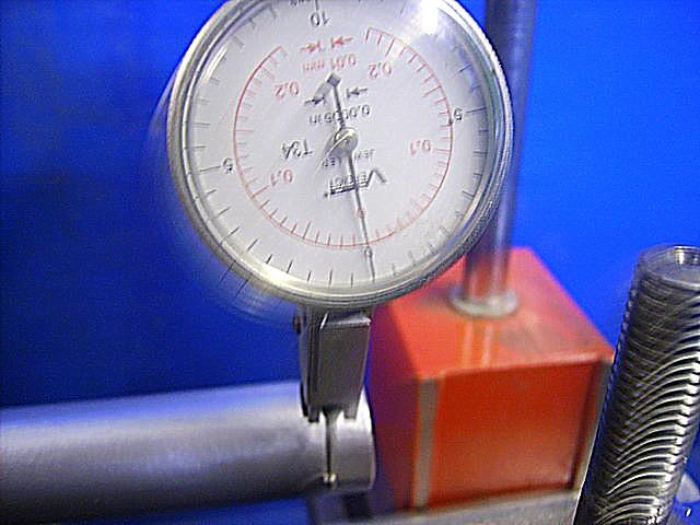

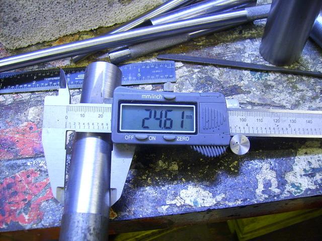

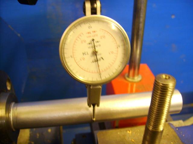

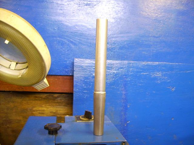

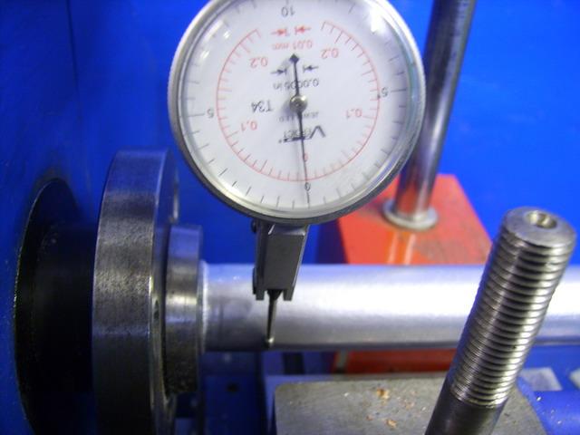

hi all as per when i did this me camra was flat so i did sum pics after the event right when i got me lathe i had to strip it dawn to give it a good clene but i dropet a boo boo me lathes head dus not sit on the v ways it sits on the flats you will see that in the pic when i put it back together all was ok so i thort once i had fited me new compawnd slide i fawnd out that me head on the lathe was all to pot wat i needed was a test bare its not the same as the one you wood use to aline your tale stock the one that is needed is one that fits in to the morce taper in the head stock on my lathe me head is held on by 4 nuts but it the casting ther is 4 grub scruws witch you youse to ajust the head so that it paralel with carige any way  cloked me head in and did a test pece me head is gnaw spot on right pics
