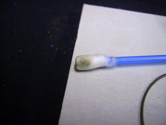

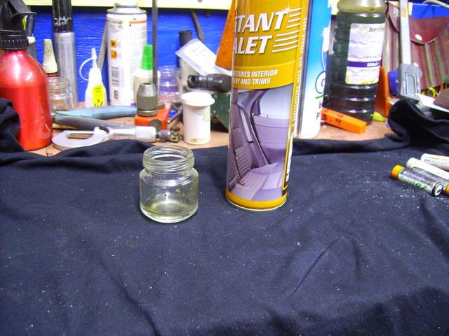

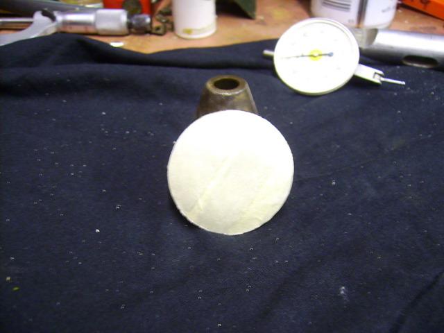

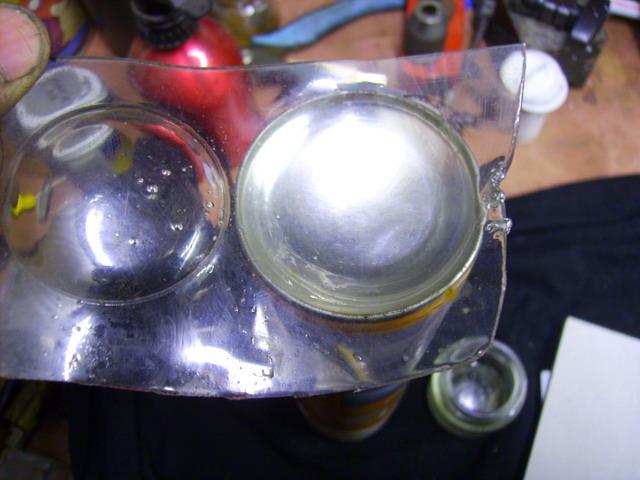

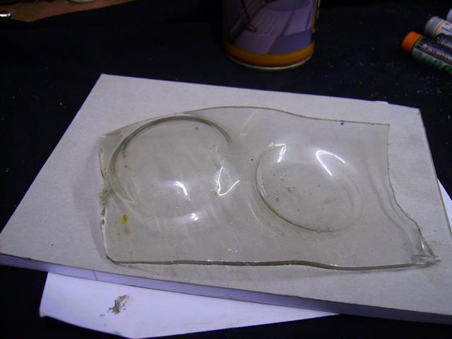

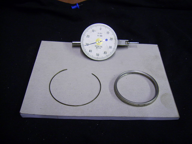

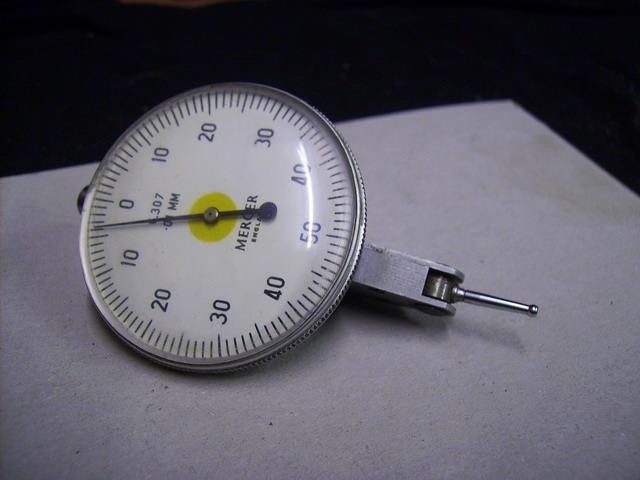

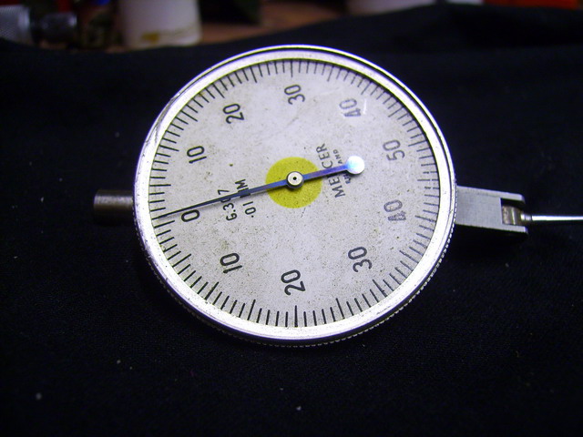

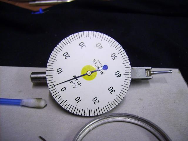

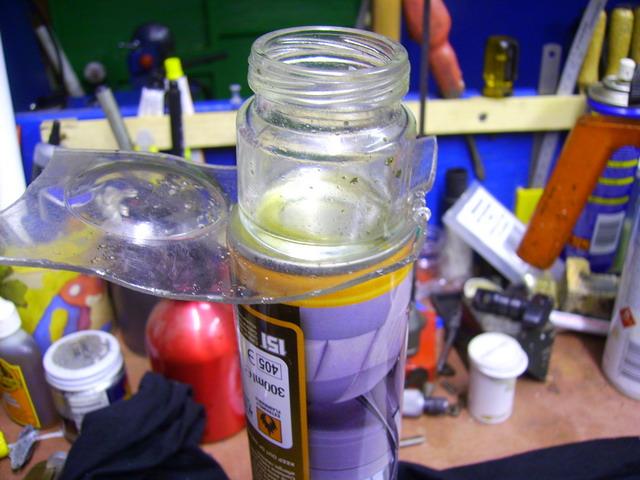

hi all this is a haw to on making a lense for a dti my way this dti belongs to john bubelboost i piced this up from his on saterday in all the dti is in good order it just needed a new lense the furst thing i did was to brush the dile to remove as much of the loos muck as posibel then i kleend the lens with coten buds and spit DO NOT USE ANY KEMIKEL CLENERS EVEN SOPY WATER CAN REMOVE THE PRINT the next thing wat to make the lense i used acrilik for this i needed sumthing to form the dome for the lense this was dun by the use of a spray can and a mini jam jar i warmd up the plastick till it became soft then plast it over the end of the spray can then with the jam jar prest on to the plastick once formd i rufely cut the shape out then cuverd bothe fases with tape then started to shape the new lens to fit i removed the besel from the dti as to ade the fiting of the lense to do this i had to remove the retaning ring at the back of the clock to do this ther is a noch cut out of the besel on the back wher you put a pin in and lift out the clip  once all was dun refited the besel and gave the new lense a polish   right pics

I made some by cutting a flat disc slightly bigger than the bezel hole, and pressing them in at the centre to force them into a dome shape.

Wouldnt have thought about doing that Bob. Well done looks great.   :beer:  have to look at mine now and have a go myself, how thick was the acrylic?
Re: DTI new lense
« Reply #14 on: October 31, 2012, 06:45:14 PM »
hi all the acryic is 1.5mm thick

I'd been quoted £36 for a new glass which i thought was really good since that also included shipping the dti to and from America but i then saw your post and thought i'd try your method first...It worked a treat....Although it took a few attempts to make a piece without it getting to hot then making tiny bubbles in it..your instructions were excellent....
