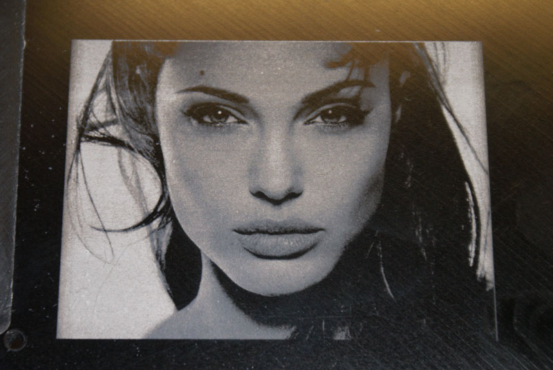

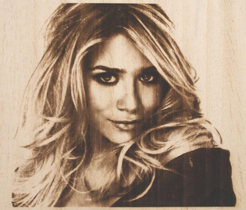

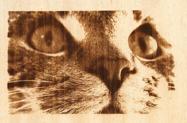

A CO2 laser produced image on Obeche using the Mach3 Impact / Laser Engraving plugin with a step-over of 0.2mm and feed-rate of 3000mm/min.
Tweakie.

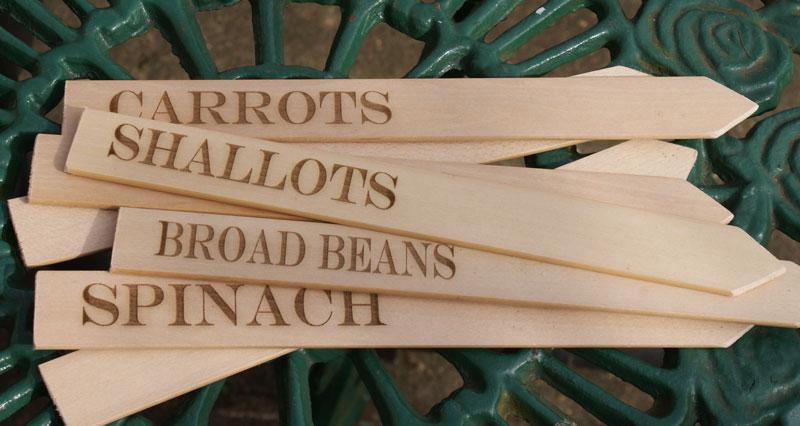

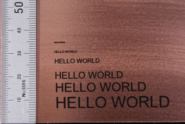

Hi Lykle,
Because lasers are essentially a 1 bit device (on / off) engraving text is probably the easiest task of them all.
Both vector and raster engraving are possible and this is just a basic example of some raster work.
Tweakie.

As John said, my CO2 laser will not mark aluminium without an additive.
However, it will ablate the dye layer in anodized aluminium as shown on this scrap piece of black anodized.
Tweakie.

No the job was crap but it proved the concept.
The reason it darker bottom right is the plate warped with the heat and curled up, this then altered the focal length of the beam so you get fatter letters which hold more black.
same at the top as it did all the lines and circles first, then went on to do the lettering. The last lettering to do was at the top and because of the curl it's missed the circles.
Best example is the middle of the plate  except the two last lines as I tried to see if it would push down and moved the plate.
When I do them not I pin them to a big block of alloy and do the lettering in stages to allow the heat to dissipate.
Another way of doing these is to take a sheet of normal perspex, spray the back silver using a Willco rattle can, burn the image on the back in reverse, then rattle can it black.
This gives you a nice plate and smooth on the front so the lettering can't wear off.

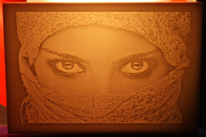

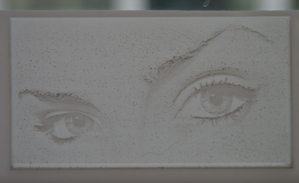

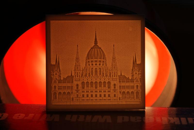

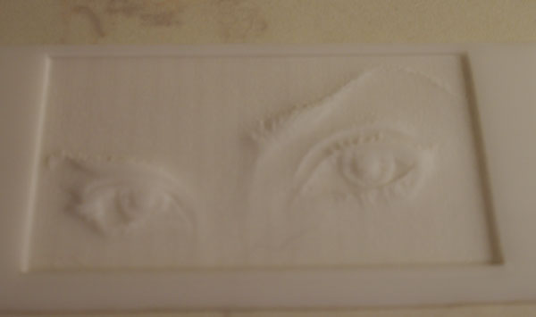

Many will have already seen a Lithophane or perhaps made their own. It is an ancient art form dating back many centuries and was at it’s most popular, here in the UK, during Victorian times. They were often produced by hand engraving an image in wax on a glass (or similar) sheet then pouring over clay slip. Once dry the parts were separated and the slip incorporated and fired into a porcelain or china clay tile, plate, cup etc. The invention of photography was perhaps the cause of their demise and unfortunately, they eventually fell out of favour and all but disappeared.
The advent of CNC has slowly caused a revival and they are now starting to gain popularity once again. I have made many using spindle machining but wondered if it would be possible to achieve acceptable results using a laser and I was honestly surprised by the results.
I still have to make some improvements in the technique used but thought you may like to see the results so far.
Tweakie.

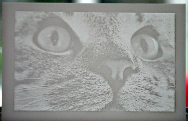

« Reply #24 on: January 12, 2013, 06:40:53 AM »
Hi Guys,
Thanks to suggestions from others I have been able to improve my technique and this is the latest Lithophane laser cut into Corian.
I was using a constant velocity of 4000mm / min for the X axis (excepting the acceleration and deceleration zones for each line scan). The final work does need backlighting (unlike opal Plexiglas) so it looks like I will be making a few LED / diffuser light frames when I get the chance.
Tweakie.

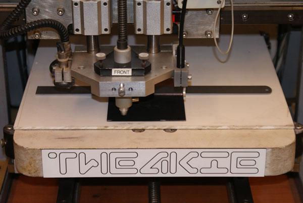

My CNC machine was constructed as a wood router although it now spends most of it's time doing spindle engraving work, the laser head was added as an additional tool and it only takes a few seconds to swap between spindle and laser work.
For those that are interested my constructional details are here http://www.cooperman.talktalk.net/
Tweakie.

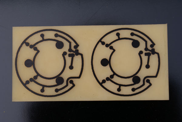

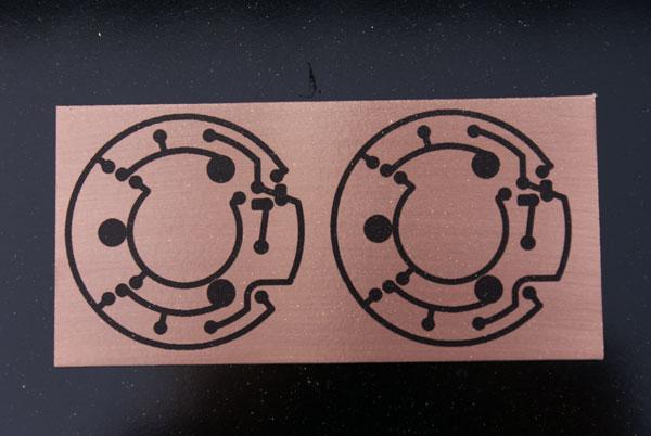

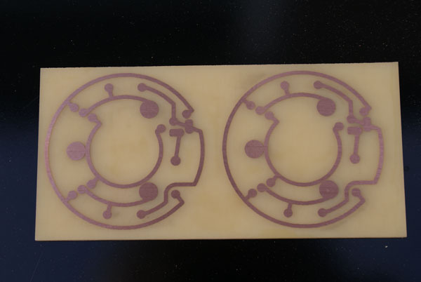

A bit more experimentation using printer toner for PCB creation.
There are a couple of difficulties to be overcome – firstly getting a thin and even layer of the toner powder onto the copper surface and secondly getting a low enough power level so as not to completely vaporize the toner. ( Note to self - don't forget to turn off air assist   )
Once these challenges have been overcome – it is a breeze.
Tweakie.

« Reply #30 on: February 17, 2013, 03:41:31 PM »
Toner powder have magnetic properties. Maybe you can use these properties to your advantage. Electrostatic charge to the copper clad could also help.

« Reply #31 on: February 18, 2013, 08:20:58 AM »
Hi Noitoen,
Thank you for the suggestion - that is something that I will try.
Another test with the dreaded Toner to get some idea of the possible resolution.
Tweakie.

Could you not use the laser to cut track outlines in the copper, or would the heat be too much for the board substrate?
Then again, if your machine has interchangeable tools, you could switch to a mechanical engraver instead.  "Right tool for the job" and all that.
Offline Tweakie
  • Posts: 40
  • Super Kitty.
    • Tweakie.CNC
Re: laser.
« Reply #35 on: February 26, 2013, 10:50:26 AM »
My laser will not cut metals but I think it would be as you suggest - a big enough laser to cut copper would probably cut straight through the board as well.  :)
Quite right and exactly what I do. http://www.cooperman.talktalk.net/circuit5.wmv
Tweakie.
Tweakie.
So I saw - I had a rummage on your site after I finished reading the forum.  :thumbup:

We recently had some discussion (in another forum) where I doubted that laser produced lithophanes could actually produce a resolution equal to a spindle engraved litho but since getting hold of some genuine Corian to try - I now think that it is possible to get extremely close.
The big advantage is that the laser takes half an hour to produce a small, 0.1mm step-over, litho that may take half a day with spindle engraving.
This litho (created from a .jpg image of the Hungarian Parliament Building) is just 50mm square and I think is probably a good example of the resolution that is typically achievable using laser techniques.
Tweakie.
